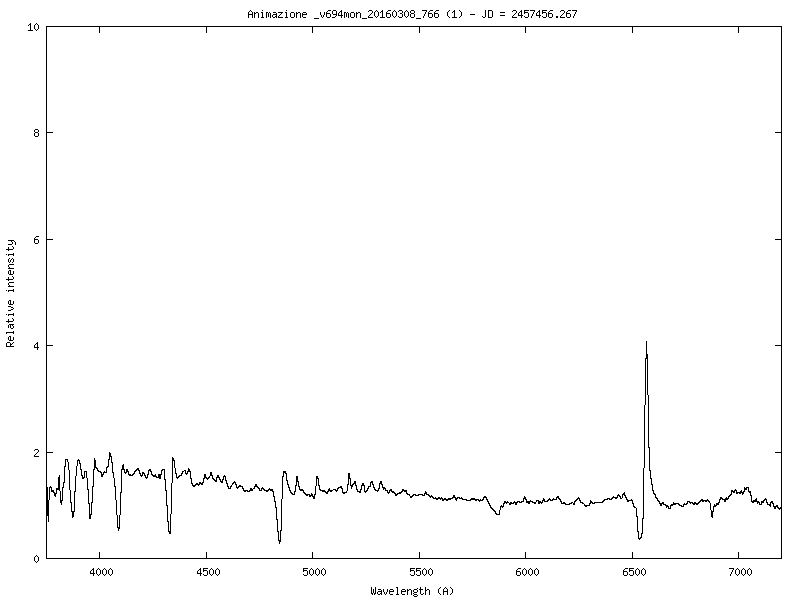

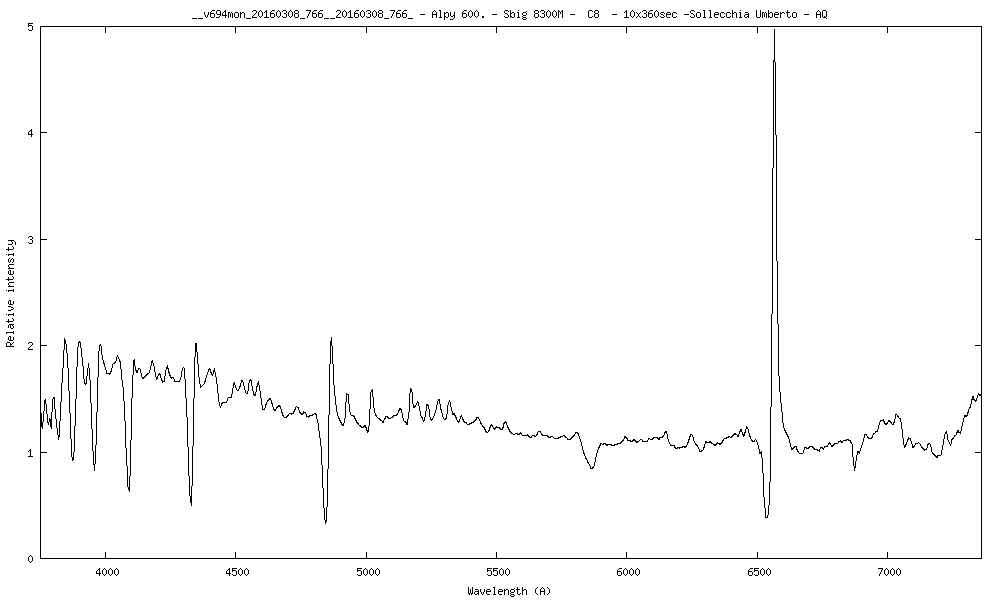

Bonjour à tous, un nouveau profil et l 'animation d'observation 03.08.2016.
Profilo v694mon.png (7.71 KiB) Viewed 12010 times
Animation
Salutations Umberto

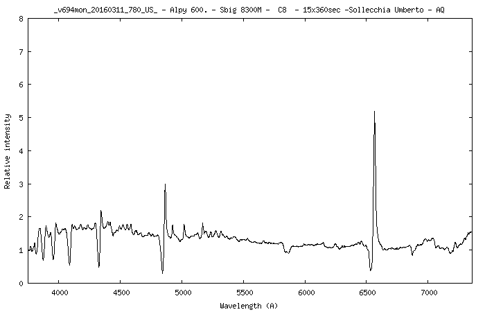

Re: v694 Mon
Posted: Fri Mar 11, 2016 10:48 pm
by umberto sollecchia
Bonsoir à tous, le profil de ce soir.
salutations umberto

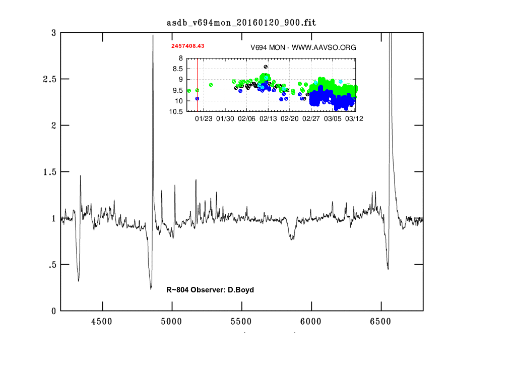

Nice series for the lores full spectra, ideal for a real data mining!
Just for my curiosity I've compiled a LoRes serie of v694 Mon picked every day, to get an insight what is changing and how does ARAS correlate with AAVSO.
Hope authors don't mind to publish such a compilation (2016.01.20 - 2016.03.07):
This is the way I produced this animated gif:
- downloaded 22 spectra from here one by one via normal http, trying to cover the most interesting AAVSO-reported peak around 2016-FEB-11/12:
http://www.astrosurf.com/aras/Aras_Data ... 694Mon.htm
(at this time 2016.03.07 is the last downloadable)
- created continuum for each spectra via IRAF task 'continuum' with params:
sampling region: 3700:4800,5000:5800,5900:6400,6700:7200, order: 9, function: legendre, iteration: 100 (rejects outstanding peaks/holes)
- then divided each spectra by their extracted continuum
- generated AAVSO chart from http://www.aavso.org
- used ImageMagick to put aavso + annotate AUTHORs noting resolution at the bottom of pictures (and a set of linux commands, all free and opensource)
- of course, all thandled with my local script ecosystem...which is a set of random script stanzas in bash + IRAF commands I have gathered in the last 4-5 years + now.
Hope others find the animation useful for gathering insight what is changing.
Happy hunting!
- Peter
