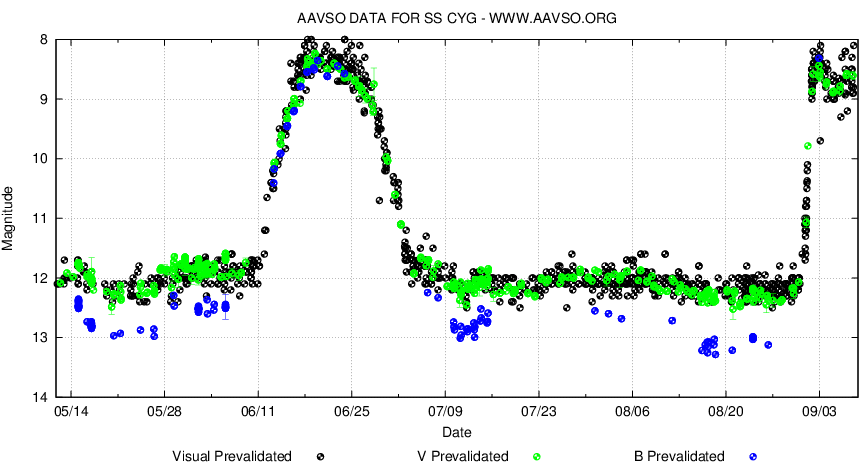

here you are two photometric graphics excerpt from the AAVSO database. It seems that SS Cyg had two different maxima during this outburst

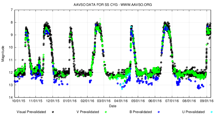

and here you are an extended graphic with all the last outbursts. Here, the alternance between short/small and long/big outbursts is clearly visible, but keep in mind that this periodicity is not always respected! I wouldn't be surprised if this current outburst will be a big one, like the last observed in Juny... at this moment I have the feeling that we are watching a big outburst!

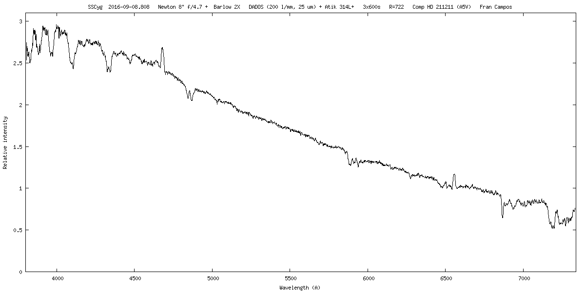

Finally, my contribution from the last night. The calibration has been done with HIP 109831 (A2Vnn) = HD 211211 (there is a mistake in the graphic's title about the spectral class of HIP 109831: I treated it like an A2V star).
Greetings!
Fran

Thank you for your explanation, now SS Cyg must be in a long cycle.

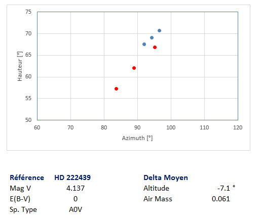

Indeed, I've made a mistake in page 2 of this topic : HD211211 is not a A5V star but a A2V star. Really sorry.
As François said, HD222439 should be a good reference star too.
I've changed my mind and not systematically take HD211211 as reference star for SS Cyg. It really depends of the altitude of SS Cyg. During summer when SS Cyg is near the zenit, HD211211 is interesting but this is not the case in spring or autumn when SS Cyg is rising from the East or falling to the West.
I now use the last version of his tool Reference Star Finder which displays positions of target star and reference star in the same canvas taking in account beginning, ending and duration of exposures for both stars. This is really useful and highly more precise. I don't take a star which the altitude difference exceeds 4 or 5°.
I'm taking in account the class of the star (is the star available on the Pickles or Miles libraries ?) and the E(B-V) value (equal or really near 0) too.

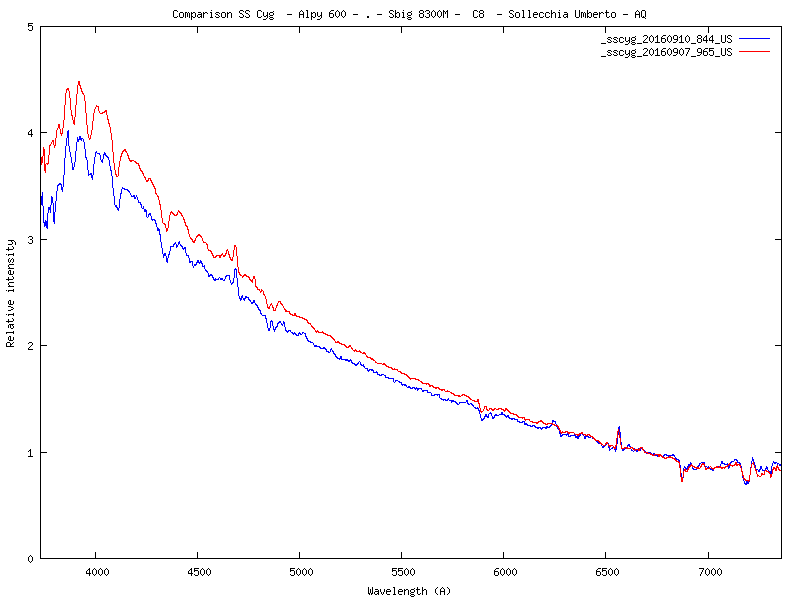

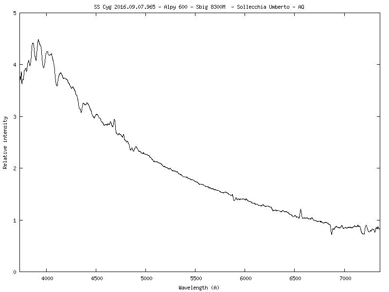

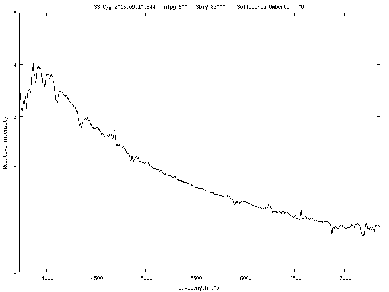

Bonjour à tous, placez les profils des observations 07.09.2016 et 10.09.2016.
Pour la réponse instrumentale Je l'ai utilisé les miles Hd 192640.
Le jour 10/09/2016 J'applique également une réponse avec l'étoile HD 222439, recommandé par François, mais le profil est pas identique à celui avec la miles.
Je ne suis pas sûr que je l'ai fait bien, mais le HD 192640 a un profil connu dans la bibliothèque du programme ISIS, le hd222439 (A0V) il y a un profil générique Pikles.
Profilo SS Cyg.png (5.21 KiB) Viewed 11934 times
Profilo ss cyg.png (5.29 KiB) Viewed 11932 times

Comparazione 07-10-2016.png (7.04 KiB) Viewed 11932 times
