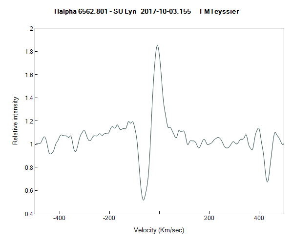

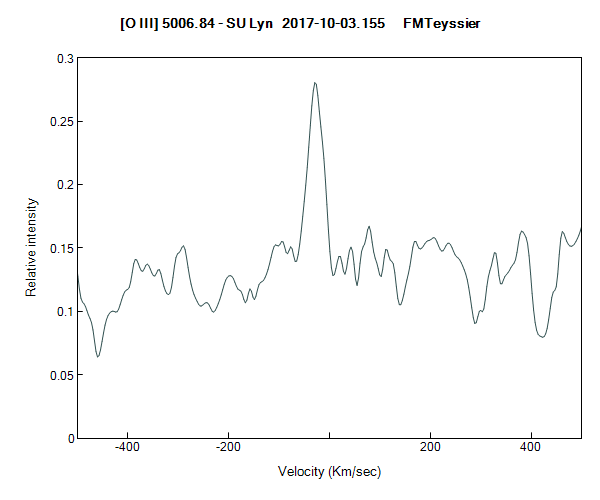

Re: SU Lyn Call for observations by Katarzyna Drozd
Posted: Tue Oct 03, 2017 5:37 am
First spectrum for the new season
H alpha
[OIII]
Ongoing observations of this new discovered symbiotic on the request of Katarzyna Drozd

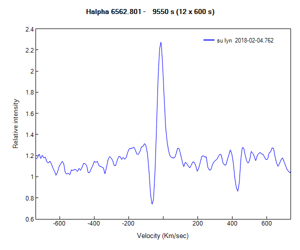

First clear night of the year!
A spectrum of SU Lyn with eshel
H beta - [OIII] range, with a comparison with the M5III 13 Lyr, useful to highlight the emission lines
[OIII] 4959 and 5007 appear clearly
H alpha range
Ha in RV

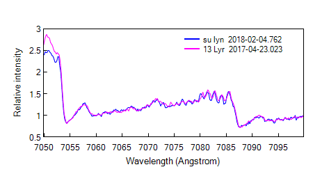

James,
He I 7065 range : no line
For line identification, you have to consider the emission spectrum as a all.
He I 7065 appears with He I 5876 (triplets) and also He I 6678.
No He I in emission in SU Lyn
[Ne III] 3869 makes sense (considering [OIII]). So the line at 3969 could be the other [Ne III] line.
PS: your -excellent- spectra are welcome for the database.
