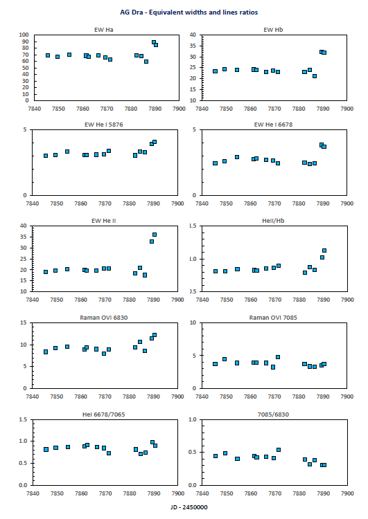

Posted: Thu May 18, 2017 8:51 am
Lines evolution in May
Increase of Recombination lines
He I triplet and singlet
Raman OVI (6830)
Raman OVI 7085
And the EW
