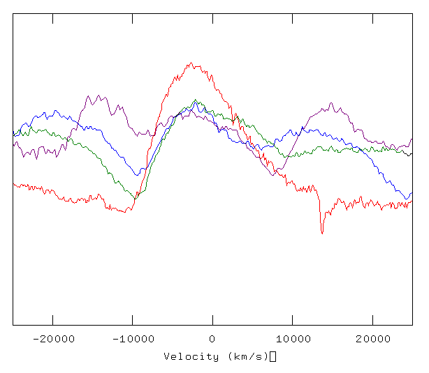

As for the P-Cygni profiles, I'm puzzled - can't match the absorptions by velocity (same SN 2017eaw 20170528.957):
red: H-alpha, green: H-beta, blue: H-gamma, purple: H-delta
generated by IRAF/specplot
Education appreciated why only the emissions velocities match.
Attaching the fits, perhaps missed something obvious:
asdb_sn2017eaw_20170528_957.zip
(9.42 KiB) Downloaded 621 times

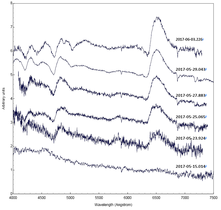

Dear all,
The (impressive) sêctra that you have sent are in a new page of the database
Let me know if something is missing
http://www.astrosurf.com/aras/Aras_Data ... 017eaw.htm

Your spectra
(Etienne, Fran, Jim, Peter, Jacques)
