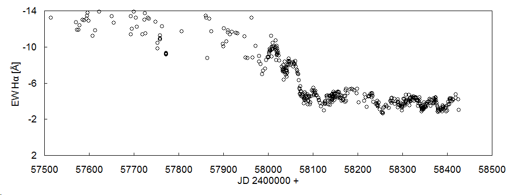

by HughAllen
Latest update of the progress of the VV Cep eclipse using observations by Jim Ferrera, James Foster and myself. The latest observation by James on 28th October has shown a remarkable fall in the Hα emission...

Hi Hugh,
it is interesting to see that the low-resolution monitoring shows essentially the same progress as in the high-resolution monitoring, though not as detailed. It calms me to see that paticularly the behavior around the end of october to the beginning of November has been observed in both monitorings.
When I saw the small EW-decrease for a first time in my monitoring, I thought that would be an error in measurements.
Ernst

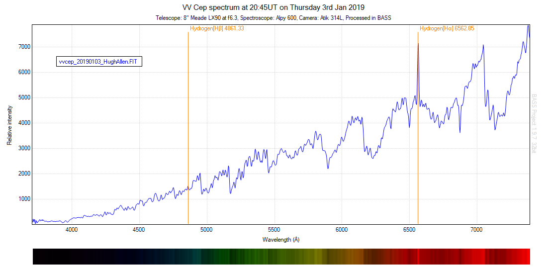

by HughAllen
At low resolution the ending of the eclipse is now very apparent, which is consistent with the latest results from the high res campaign recently posted by Ernst Pollmann...

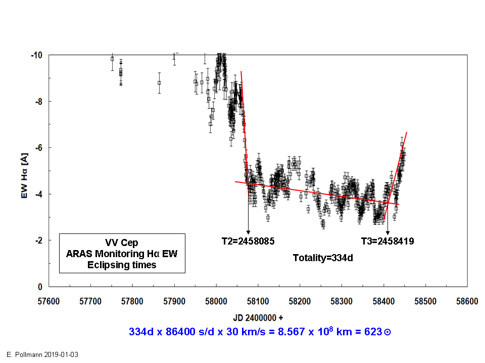

Hi Hugh,
very pleasant this accordance. It documents the power of low resolution spectra.
I want something add to my last posting: the attempt to calculate the diameter of the disk-like emission source (see the attached Fig.)
