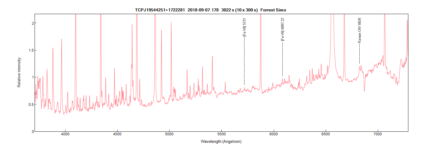

An aexcellent LISA spectrum obtained by Woody Sims
[Fe VII] and Raman OVI appears clearly during the decline

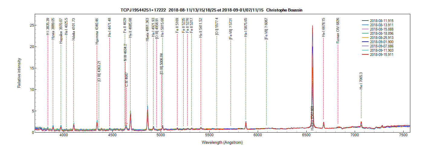

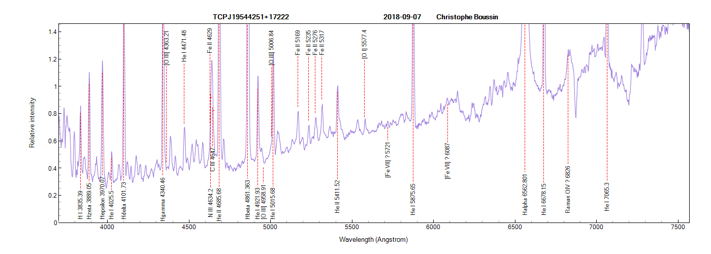

I obtained the following spectrum at 21 h 16 TU with a resolution of 506 (JJ = 2458369.412) and an acquisition time of 60 min.
TCPJ19544251+17222 on September 7th, 2018
_tcpj19544251+17222_20180907_886_Christophe Boussin_3700_7570.png (97.74 KiB) Viewed 27971 times

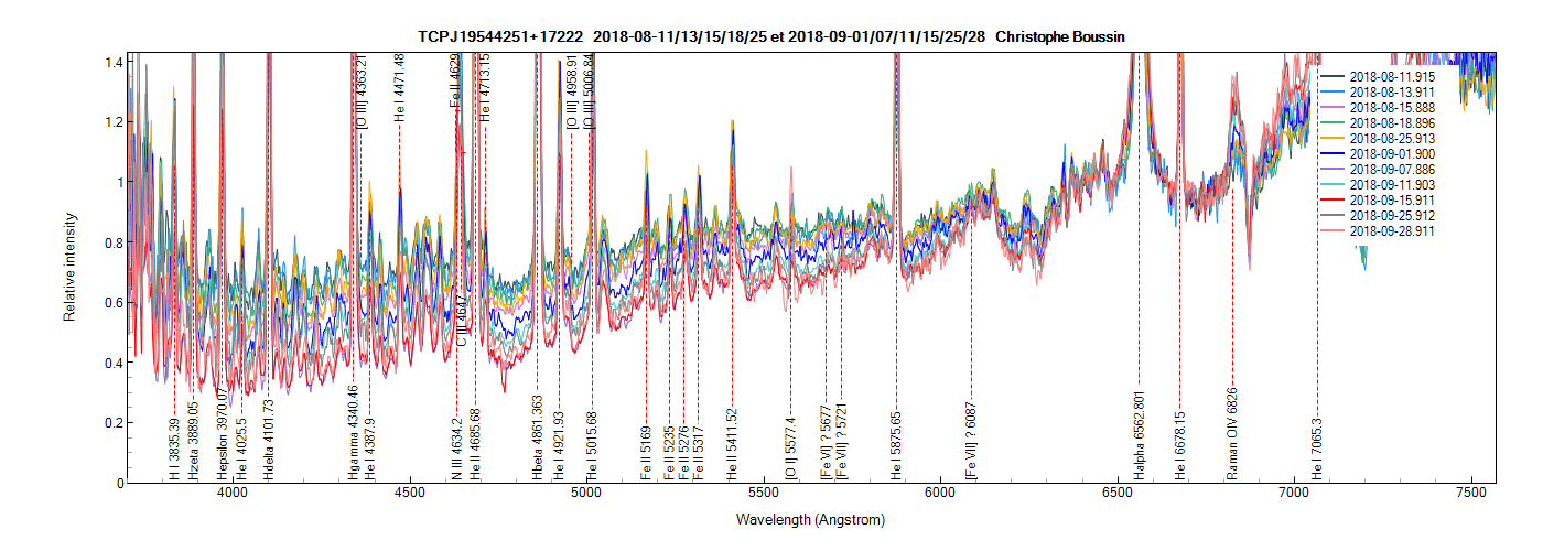

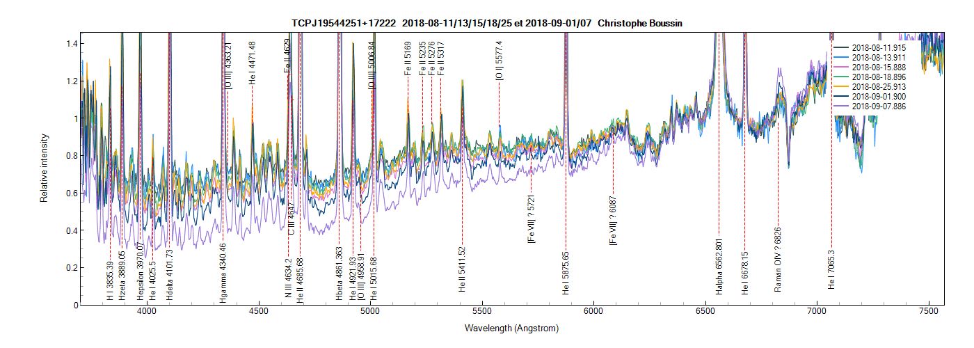

The comparison of the spectra always shows a clear increase in the relative intensities of the Balmer lines.
The relative intensity of the HeII line at 4686A still seems unchanged since August 25, as well as those of the HeI lines at 6678A and 7065A.

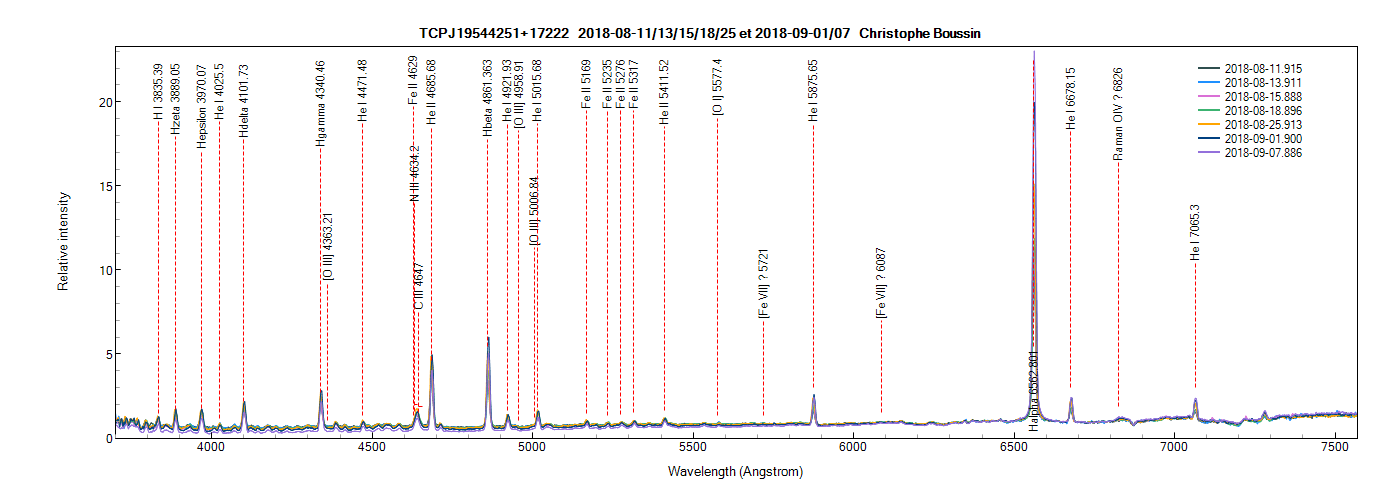

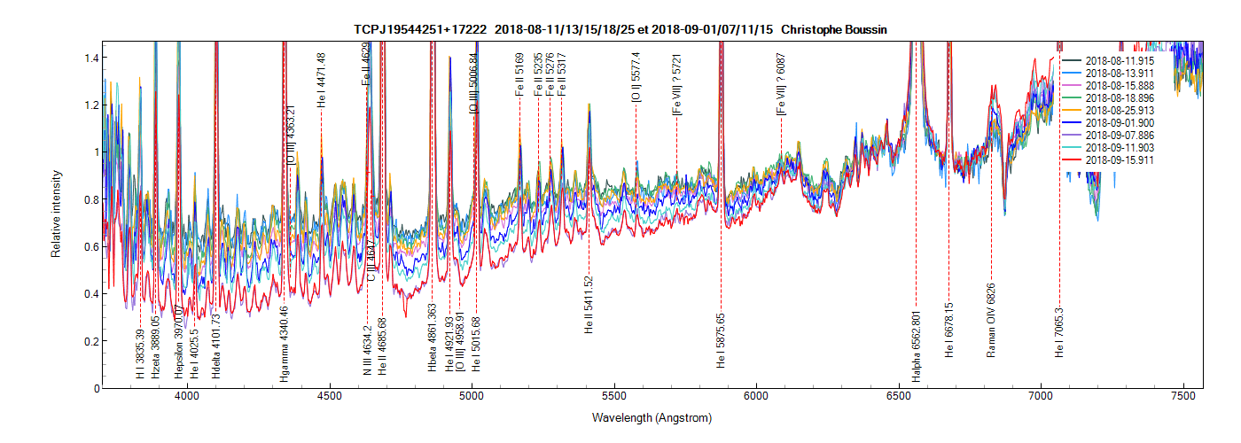

TCPJ19544251+17222 on August 11th, 13th, 15th, 18th, 25th and 1st, 7th September, 2018
I also detect something at 5721A and 6087A but that does not seem conclusive to me at low resolution since these "lines" are already visible in my previous spectra. The continuum seems to evolve significantly at short wavelength…?
TCPJ19544251+17222 on August 11th, 13th, 15th, 18th, 25th and 1st, 7th September, 2018 (zoom)
However, I think I have also detected the OIV Raman line at 6826A.
TCPJ19544251+17222 on September 7th, 2018 (zoom)
...and the [OIII] lines at 4363, 4959 and 5007 are always undetectable at low resolution.

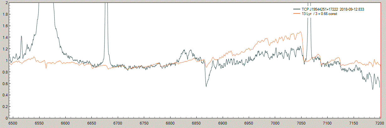

I have taken a closer look (9 x 10 min) with 12" Newton + LHires 600/mm grating + 35 micron slit at R~2700 at the Raman profile, and it is really double peaked (resembling to AG Peg):
To elaborate M-ish features, I've taken 13 Lyr at the same R~2700 (normalised both targets), then estimated a 1/3 multiplier visually (tellurics included - please ignore [6870-7000A]), and added + 0.66 constant. It seems to fit well on the continuum. The RV distribution:
Note that this feature is a hard target at this medium resolution, due to the high magnification factor required to acquire the real details.

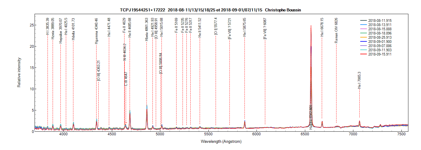

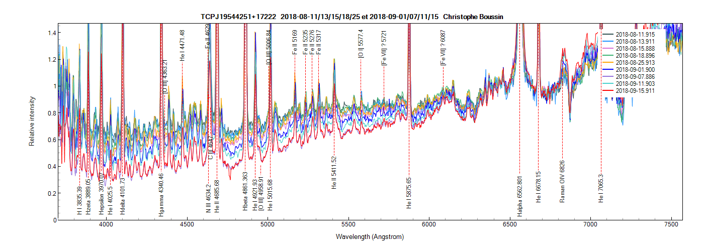

The evolution of the Vend47 spectrum between August 11 and September 15, 2018 appears below :
TCPJ19544251+17222 on August 11th, 13th, 15th, 18th, 25th and 1st, 7th, 11th and 15th September, 2018
TCPJ19544251+17222 on August 11th, 13th, 15th, 18th, 25th and 1st, 7th, 11th and 15th September, 2018 (zoom)
The relative intensities of Balmer lines are always increasing.

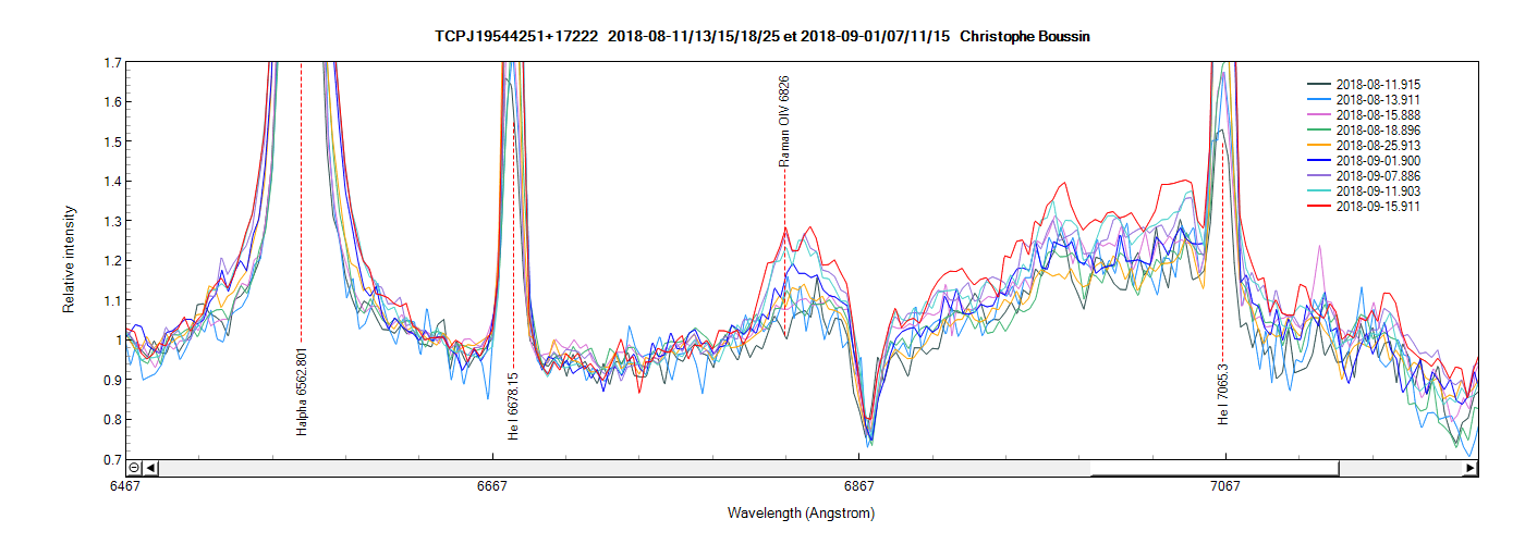

Peter, very interesting...I hope you can follow the evolution of this structure !

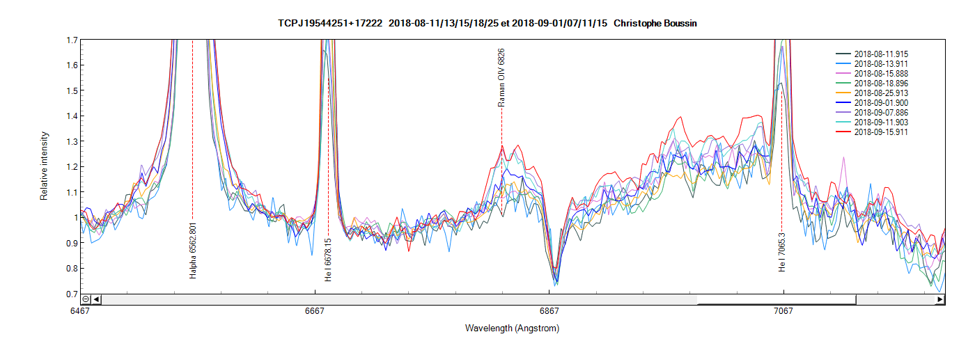

I also detect (but with a much lower resolution ...) a double peak for the position that corresponds to the Raman OIV line at 6826A. This one seems to evolve since September 7th (to follow...).
TCPJ19544251+17222 (Raman OIV 6826A)

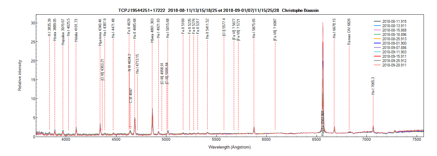

The evolution of the Vend47 spectrum between August 11 and September 28, 2018 appears below :
TCPJ19544251+17222 on August 11th, 13th, 15th, 18th, 25th and 1st, 7th, 11th, 15th, 25th and 28th September, 2018
TCPJ19544251+17222 on August 11th, 13th, 15th, 18th, 25th and 1st, 7th, 11th, 15th, 25th and 28th September, 2018 (zoom)

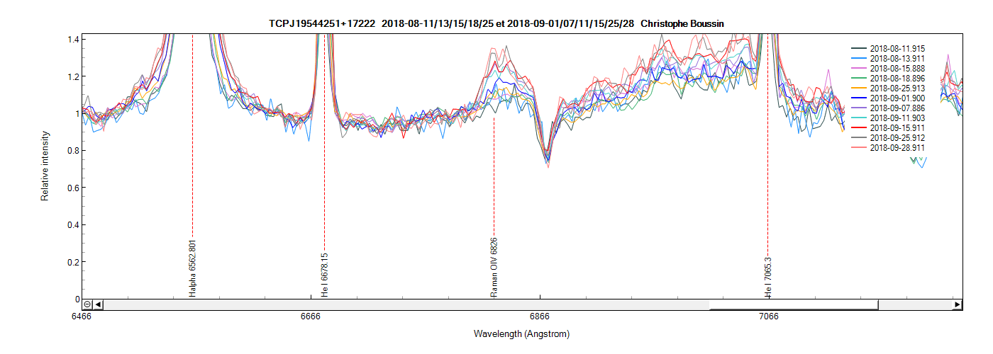

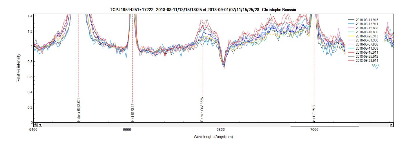

As before, I always detect a double peak for the position that correspond to the Raman OIV line at 6826A...and the relative intensities of these peaks continue to increase :

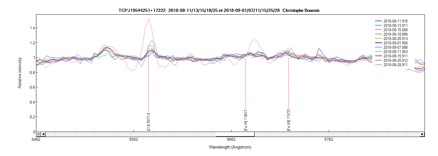

The [OIII] lines at 4363, 4959 and 5007A are always undetectable at low resolution but...I think I have seen some changes in the Vend47 spectrum...
First, I note that the relative intensity of the line [OI] at 5577A appears to be increasing since September 15th. Second, a structure appeared in the area near the [FeVI] line at 5677A.
Of course, these potential changes need to be confirmed in the coming days...
TCPJ19544251+17222 ([OI] 5577A and [FeVI] 5677 ?)
Did someone notice something similar?
