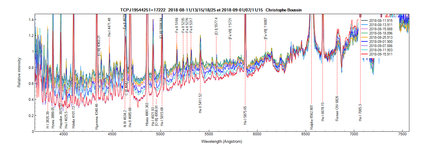

After an uncertain weather throughout the afternoon of September 7th, the sky finally cleared at the end of the day (as expected...) and I was able to also resume tracking Vend 47 !
I obtained the following spectrum at 21 h 16 TU with a resolution of 506 (JJ = 2458369.412) and an acquisition time of 60 min.
TCPJ19544251+17222 on September 7th, 2018
_tcpj19544251+17222_20180907_886_Christophe Boussin_3700_7570.png (97.74 KiB) Viewed 27977 times
The comparison of the spectra always shows a clear increase in the relative intensities of the Balmer lines.
The relative intensity of the HeII line at 4686A still seems unchanged since August 25, as well as those of the HeI lines at 6678A and 7065A.
TCPJ19544251+17222 on August 11th, 13th, 15th, 18th, 25th and 1st, 7th September, 2018
I also detect something at 5721A and 6087A but that does not seem conclusive to me at low resolution since these "lines" are already visible in my previous spectra. The continuum seems to evolve significantly at short wavelength…?

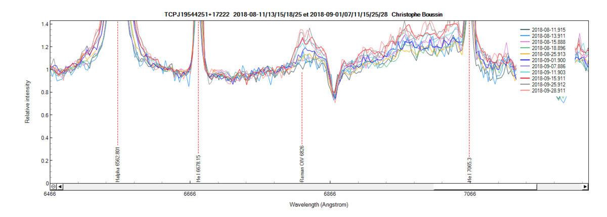

However, I think I have also detected the OIV Raman line at 6826A.
TCPJ19544251+17222 on September 7th, 2018 (zoom)

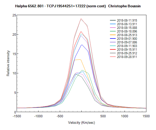

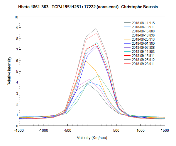

The relative intensities of Balmer lines are always increasing.
The profiles of Halpha, Hbeta lines renormalized around their local continuum are an example :
TCPJ19544251+17222 (Halpha)
tcpj19544251+17222(normcont)_Halpha_Christophe Boussin.png (36.1 KiB) Viewed 27803 times
TCPJ19544251+17222 (Hbeta)
tcpj19544251+17222(normcont)_Hbeta_Christophe Boussin.png (40.43 KiB) Viewed 27803 times

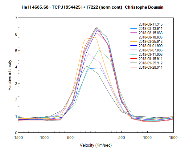

The profile of the HeII line at 4686A, also renormalized around its local continuum, shows that the relative intensity of this line seems to be maintained at the same level since September 1st :
TCPJ19544251+17222 (HeII 4686A)
tcpj19544251+17222(normcont)_HeII4686_Christophe Boussin.png (46.53 KiB) Viewed 27803 times

I also detect (but with a much lower resolution ...) a double peak for the position that corresponds to the Raman OIV line at 6826A. This one seems to evolve since September 7th (to follow...).
TCPJ19544251+17222 (Raman OIV 6826A)

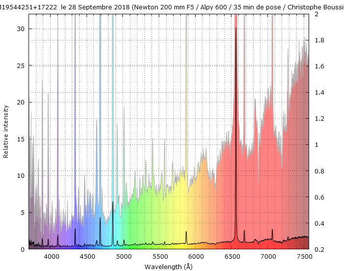

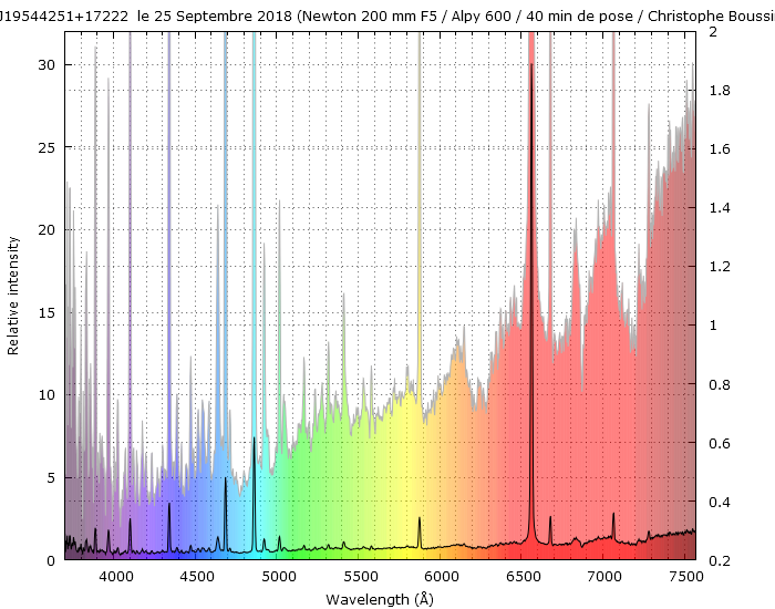

Here is my last contribution to the tracking of Vend47 with the following two spectra :
on September 25 at 21 h 53 UT with a resolution of 509 (JJ = 2458387.4258) and an acquisition time of 40 min (8 x 300 s).
TCPJ19544251+17222 on September 25th, 2018
_tcpj19544251+17222_20180925_912_Christophe Boussin_3700_7570.png (109.32 KiB) Viewed 27589 times
on September 28 at 21 h 51 UT with a resolution of 507 (JJ = 2458390.4231) and an acquisition time of 35 min (7 x 300 s).
TCPJ19544251+17222 on September 28th, 2018
_tcpj19544251+17222_20180928_911_Christophe Boussin_3700_7570.png (106.79 KiB) Viewed 27589 times

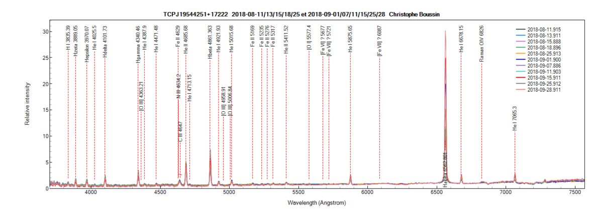

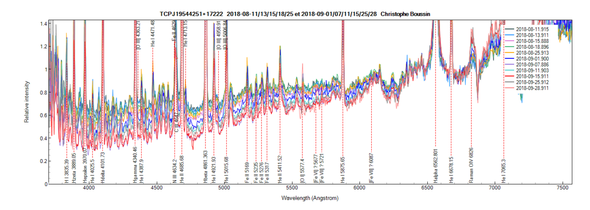

The evolution of the Vend47 spectrum between August 11 and September 28, 2018 appears below :
TCPJ19544251+17222 on August 11th, 13th, 15th, 18th, 25th and 1st, 7th, 11th, 15th, 25th and 28th September, 2018
TCPJ19544251+17222 on August 11th, 13th, 15th, 18th, 25th and 1st, 7th, 11th, 15th, 25th and 28th September, 2018 (zoom)
For example, the profiles of Halpha and Hbeta lines renormalized around their local continuum are shown below :
tcpj19544251+17222(normcont)_Halpha_Christophe Boussin.png (43.1 KiB) Viewed 27589 times
tcpj19544251+17222(normcont)_Hbeta_Christophe Boussin.png (43.77 KiB) Viewed 27589 times
The profile of the HeII line at 4686A, also renormalized around its local continuum, shows that the relative intensity of this line seems to be about the same since September 1st :
tcpj19544251+17222(normcont)_HeII4686_Christophe Boussin.png (46.74 KiB) Viewed 27589 times
As before, I always detect a double peak for the position that correspond to the Raman OIV line at 6826A...and the relative intensities of these peaks continue to increase :
The [OIII] lines at 4363, 4959 and 5007A are always undetectable at low resolution but...I think I have seen some changes in the Vend47 spectrum...
First, I note that the relative intensity of the line [OI] at 5577A appears to be increasing since September 15th. Second, a structure appeared in the area near the [FeVI] line at 5677A.
Of course, these potential changes need to be confirmed in the coming days...
TCPJ19544251+17222 ([OI] 5577A and [FeVI] 5677 ?)
Did someone notice something similar?
Clear skies,
