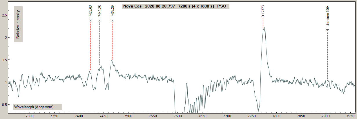

Weather cleared again, this time have taken 3 regions with the 300/1200 Newton + LHires III + 600/mm(vis) grating + Orange wratten filter.
O I 7773 + extra features

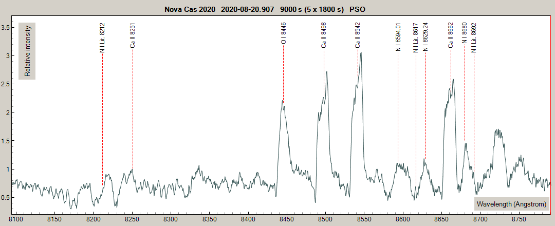

Ca II IRT show outstanding intensities and increased velocities, with Paschen end not relevant:
Ca II IRT
Ca II IRT
Interestingly, the 'N I Lit' ("N I from literature") marked wavelengths do not show any correspondence to any real feature. Literature means: Raies_Novae.pdf and 1208.0380.pdf from arxiv.
However, the other 'N I' features I've copy/pasted here in PlotSpectra input are from VSpec (the more intense ones), so the N I needs confirmation by experts.

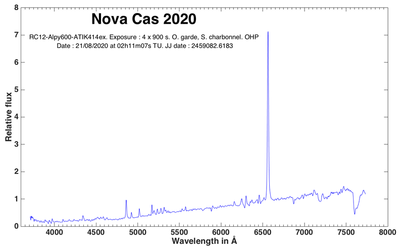

Heres' a spectrum taken last night :
An UVEX (by Shelyak) spectrum of nova Cas (300 g/mm grating, R = 800, ASI183MM camera on Celestron 9.25), for the 21.103 August :

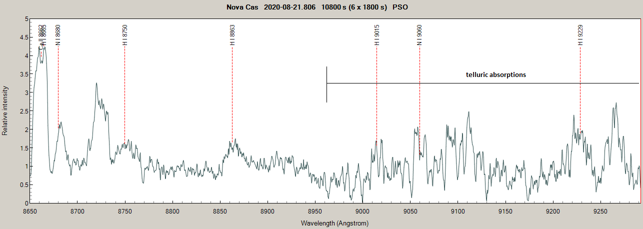

Got one more sky, experimentally taken the 8650-9300A region, looking for other rare lines:
IR end for ccd and grating, telluric holes in 2nd half
The upper half is contaminated by tellurics (visible also on reference stars) - besides the IR end is really low on signal.
Nevertheless, it's showing multiple suspects for a weak and wide Paschen.

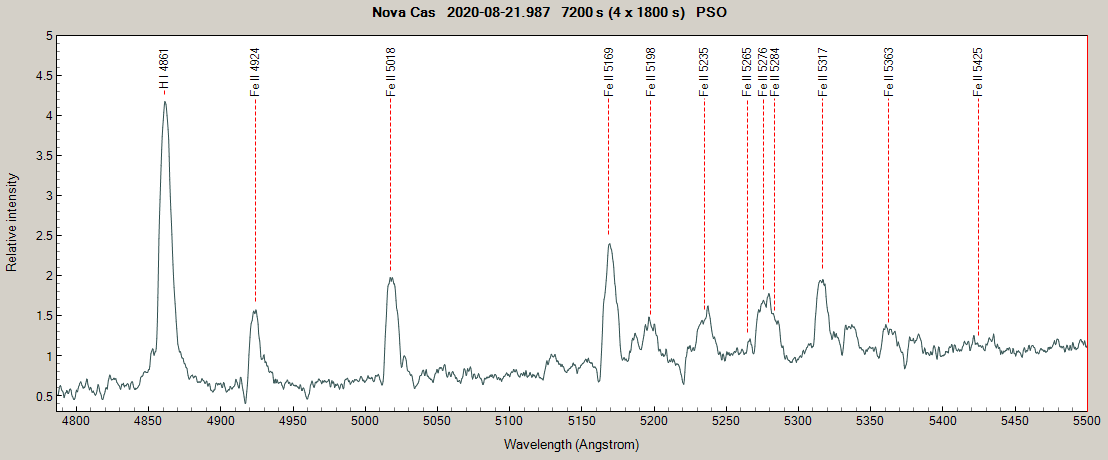

Another region reveal widened Fe II lines, with a narrow P-Cyg:
