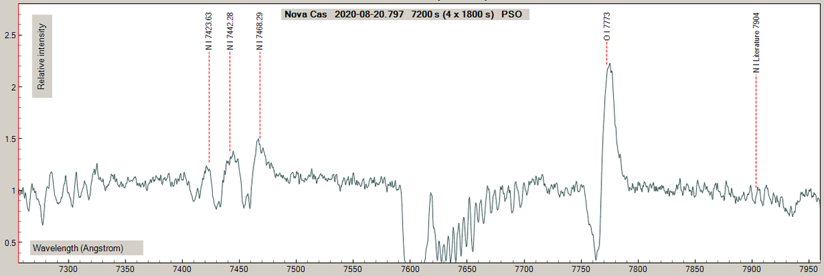

O I 7773 + extra features

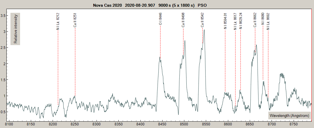

Ca II IRT show outstanding intensities and increased velocities, with Paschen end not relevant:
Ca II IRT
Ca II IRT
Interestingly, the 'N I Lit' ("N I from literature") marked wavelengths do not show any correspondence to any real feature. Literature means: Raies_Novae.pdf and 1208.0380.pdf from arxiv.
However, the other 'N I' features I've copy/pasted here in PlotSpectra input are from VSpec (the more intense ones), so the N I needs confirmation by experts.

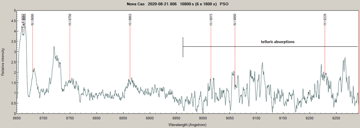

Got one more sky, experimentally taken the 8650-9300A region, looking for other rare lines:
IR end for ccd and grating, telluric holes in 2nd half
The upper half is contaminated by tellurics (visible also on reference stars) - besides the IR end is really low on signal.
Nevertheless, it's showing multiple suspects for a weak and wide Paschen.

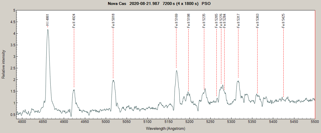

Another region reveal widened Fe II lines, with a narrow P-Cyg:
FeII widened
FeII widened
