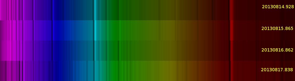

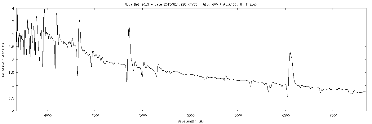

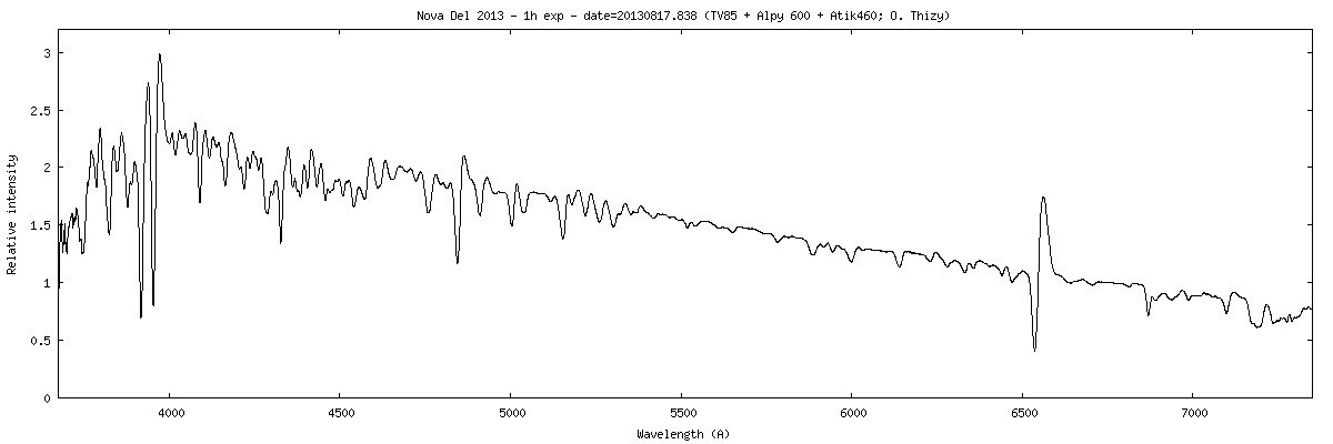

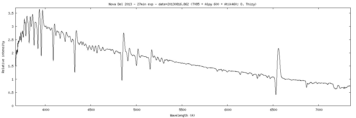

by Olivier Thizy
Paolo,
the spectrum changed drastically compared to last night. Absorption in P Cygni profiles is less pronounced in the blue region and as you mentionned there are lot of absorption lines... we are seeing this object changing over time "live" - incredible! :-)
Here is my first serie of tonight:
Compared to last night serie:
An animation of four night's spectra (clic to enlarge):
I have assembled 4 spectra (one for each night) in a colored 2D spectrogram which shows the evolution overall:
I hope lot of people are observing in higher resolution... and hopefully also continue to observe in the US and Australia for exemple... we need time coverage on this nova... :-))
