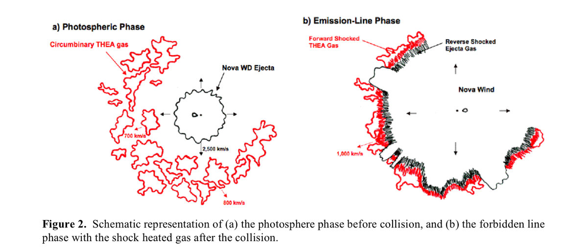

There seem to be two explanations - or two possible causes - as to why we see an increasingly blue-shifted set of absorption lines in this phase of nova evolution. One (the simpler to understand, at least by me!) is advocated by Bob Williams (see Williams and Mason, 2009, Nova ejecta as colliding shells, http://arxiv.org/ftp/arxiv/papers/0908/0908.3810.pdf):
"[We see] multiple absorption systems having different radial velocities in the spectra of a large majority of novae and interpreted the observations in terms of discrete clouds of gas that are progressively accelerated outward. The innermost ejecta, having the higher velocities, correspond to the surface layers of the white dwarf (WD) that have undergone nuclear reactions. The outermost ejecta are circumbinary gas having lower velocities, and their presence at maximum light surrounding the primary WD ejecta strongly suggests that the outer circumbinary transient heavy element absorbing (THEA) gas has existed before the TNR." (Williams and Mason, 2009 p.1)
Basically he argues that previous outflow from both the WD and in particular the secondary star creates a circumbinary gas envelope moving outwards from the pair at relatively low velocities. This is successively energised (ionised, heated, and collided with) by the initial nova outburst hence is the first set of absorption (and emission) lines we see. Later, as the fireball become less optically thick, we see faster moving lines from the actual ejecta themselves. The attached diagram is from p.7 of that article.
One of the problems with this theory seems to be that the energy required to push this much material out into the circumbinary envelope is substantial, and we see little evidence of this sort of emission from the system prior to the nova outburst. But it seems true to say that the recent literature seems to be dominated by discussion of the evidence for and against some sort of steady-flow stellar wind (as opposed to a ballistic expansion) as a contributor to novae spectral evolution.
