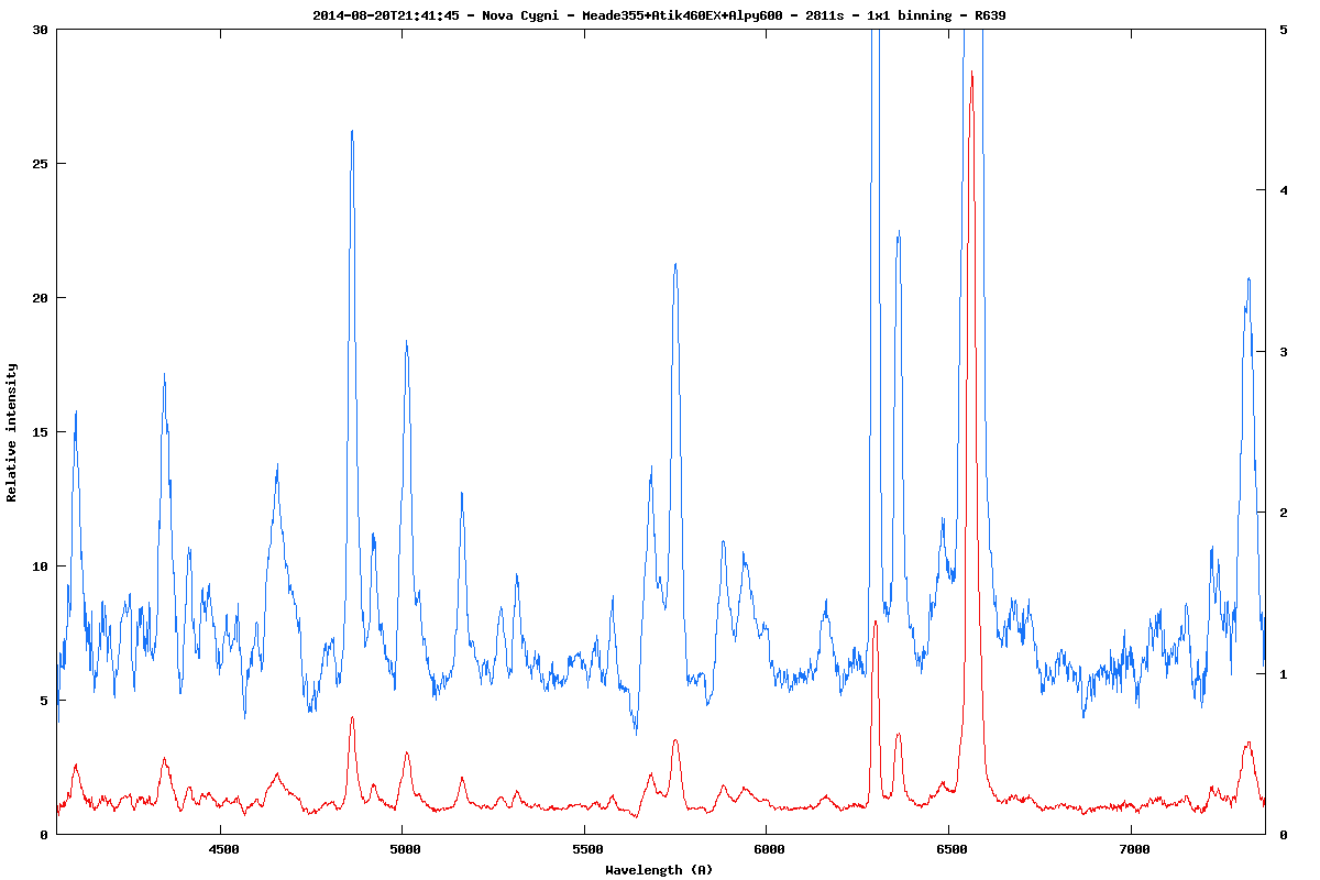

My last observation, 12.9 aug 2014. Two Miles reference stars for flux calibration, HD 176301 and HD 196544.
4.9 and 12.8 august comparison of the same spectral range.
During large slit operations (long exposure guide camera frame). Target is slightly slit off-axis to avoid contamination by a field star.

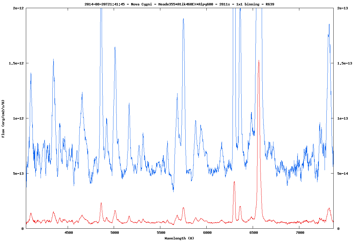

Nova Cyg of the last night
My first try of measuring flux with Christian Buil first method and 23um/230um slit
Regards,

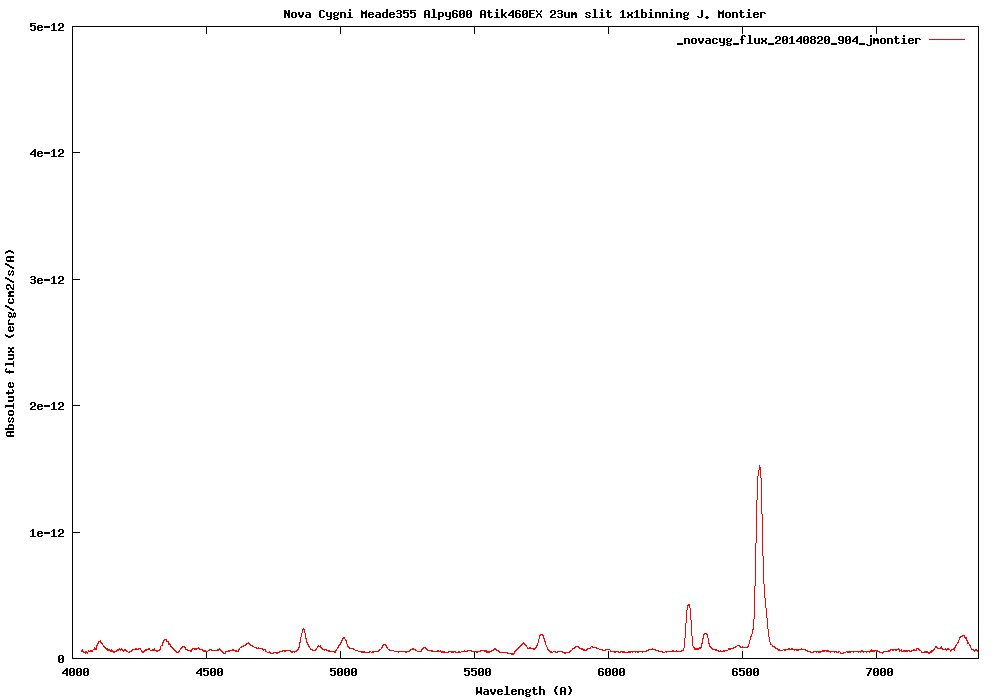

Re: Nova Cyg 2014 = PNV J20214234+3103296
Posted: Wed Sep 03, 2014 8:33 am
by Jacques Montier

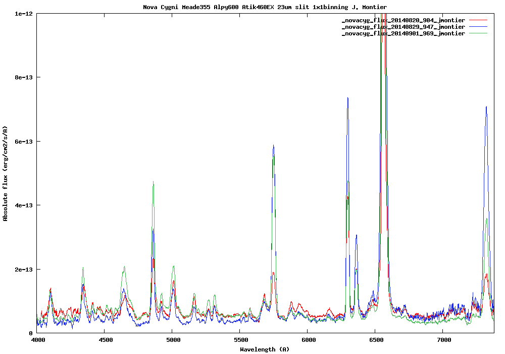

Flux comparison of the nova on 20140820, 20140829 and 20140901
