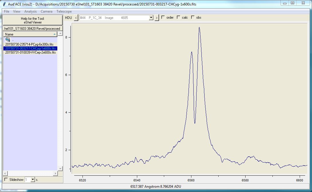

Here is my last spectrum from tonight.
Unfortunately I don't have enough time span to monitor profile changes through the night.

a single shot tonight as I didn't want to return the mount and reached the limits. But it shows some changes from your spectrum:
CH Cygni preview.JPG (83.42 KiB) Viewed 27975 times

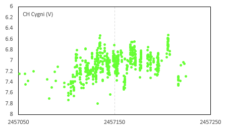

Posted: Fri Jul 31, 2015 5:22 pm

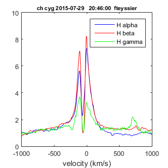

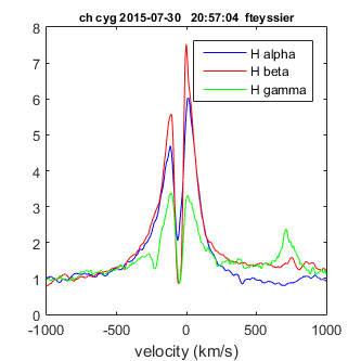

AAVSO Light Curve
General trend : decreasing since the beginning of June
Results from 29th and 30th of july :
About lines formation :
- CH Cyg : Introduction to CH Cyg campaign by Dr A. Skopal : http://www.astrosurf.com/aras/novae/Inf ... 015-01.pdf
- Symbiotics : Several texts from Dr S. Shore :
http://www.astrosurf.com/aras/novae/Inf ... 3-2014.pdf

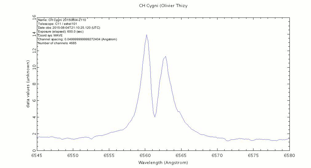

Posted: Wed Aug 05, 2015 12:04 am
by Olivier Thizy
Here is an animation (done with SPLAT-VO tool) of CH Cygni Halpha recorded tonight over two hours with C11 + eShel + ST1603:

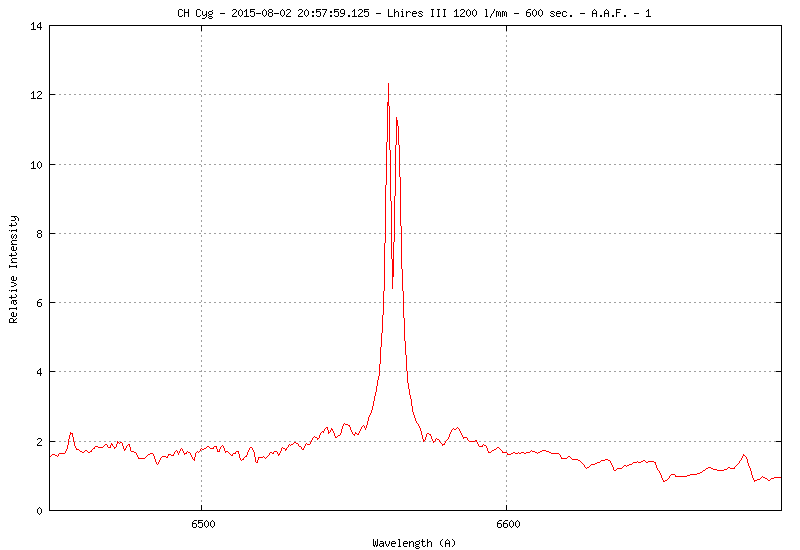

Hi to all.
Here is our animation of CH Cygni H alpha line rocorded at the night of 02 Aug 2015 over 2 hours.
Instumentation: Meade SC 10"f/10 + Lhires III 1200 l/mm + CCD SBIG ST10XME
Time of single exposition: 600 min
CH Cyg - 02/08/2015 - Associazione Astrofili Fiorentini
Clear sky
Nico Montigiani
Massimiliano Mannucci
Lapo Ferrini
Associazione Astrofili Fiorentini A.A.F., Florence, Italy (mpc code 632)

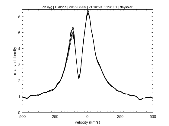

Posted: Wed Aug 05, 2015 9:44 pm
Nice Nico ! You can send me the spectra.
CH Cyg to night
Almost constant

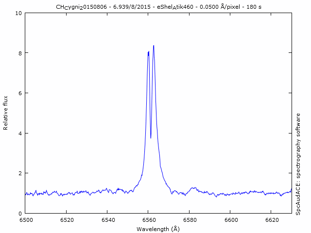

by Olivier GARDE
A time serie spectra taken just after Olivier Thizy sequence.
3H30 long : A total of 71 spectra of 180s each with eshal spectrograph.
I have also the same animation for H beta and H gamma

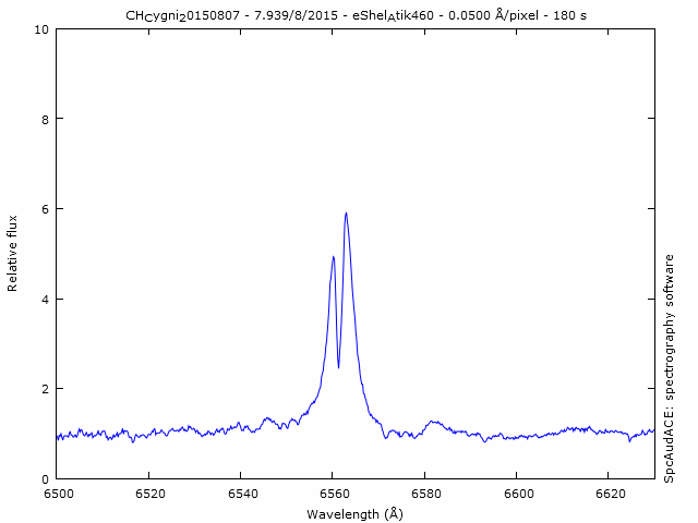

Posted: Sat Aug 08, 2015 11:50 am
by Olivier Thizy
Here is an animation of the night of august 6th and one from last night (data reduction in ISIS, animation in SpecAudace with 'norma' option):
Equipment: C11 + eShel
