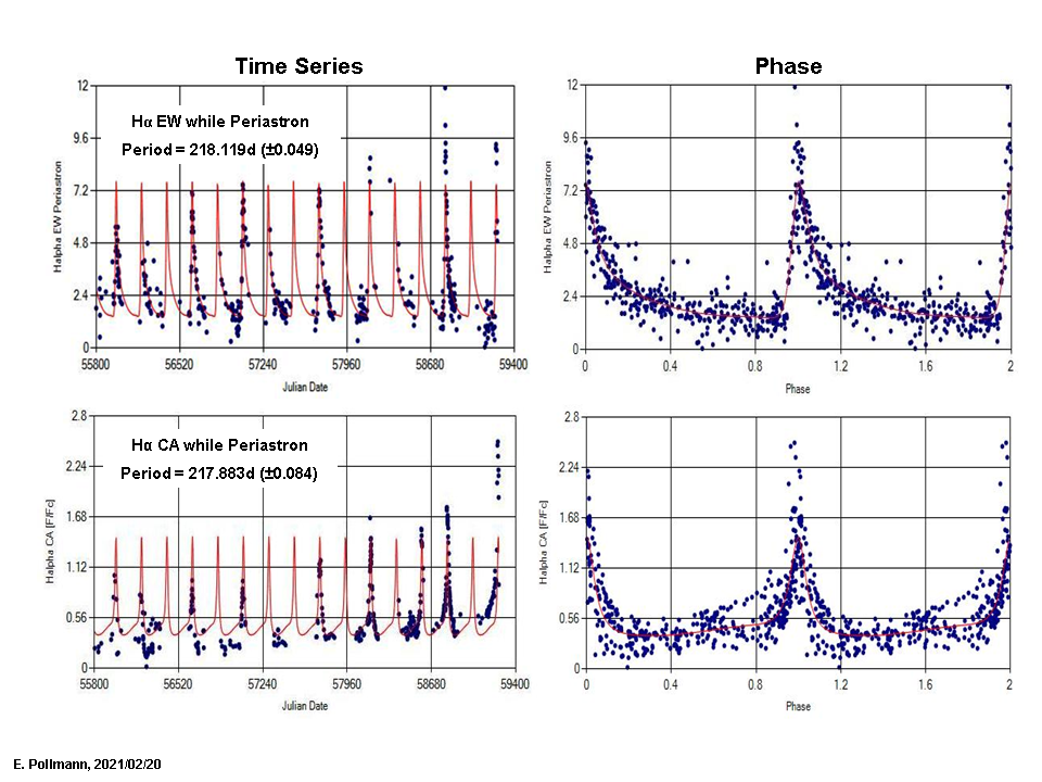

Dear colleagues!
As is known, the variable angles of inclination of Be star disks manifest themselves in the observer's line of sight as variable depths of the central absorption depression (CA) of the Halpha emission (Hanuschik, A&A 295, 1995;
http://articles.adsabs.harvard.edu/pdf/ ... .295..423H
A variable depth of the central depression in the Halpha emission thus also leads to a reciprocal variability of the equivalent width EW.
In simple words:
at a small angle of inclination (pole on) maximum emission can be observed (central absorption small, CA value F/Fc = large);
at a large angle of inclination (edge ​​on), lower emissions can be observed (central absorption deep, CA value F/Fc = small).
The change in the inclination angle of the disk is mainly caused in the periastron by the (unobservable) secondary star [for its possible nature see: RevMexAA (Serie de Conferencias), 5, 114-116, 1996].
This geometrical regularity can be observed very well in the phase of the periastron passages of the companion star in the Be binary star 28 Tau (Pollmann, IBVS Vol. 62, No. 6239; https://konkoly.hu/pub/ibvs/6201/6239.pdf)
The last period determinations based on radial velocity measurements (P = 218.058 d) date back to 2010 (Nemravova et al.
https://www.aanda.org/articles/aa/pdf/2 ... 885-09.pdf)
The very sharp peaks of the EW and CA changes at 10 periastron passages meanwhile suggest that these should also be used (perhaps preferably) for the future monitoring of the orbital period of the companion star.
The orbital periods presented here:
EW (periastron) = 218.119d (± 0.049)
CA (periastron) = 217.883d (± 0.084)
Periodenanalyse CA und EW_20.2.21.png (473.37 KiB) Viewed 24322 times
Any comments?

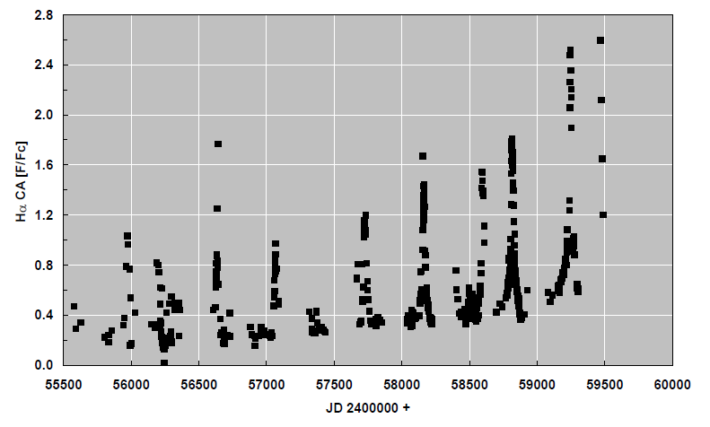

Post by Ernst Pollmann »
Thanks to the observers A. Stiewing, K. Alich, J. Martin and O. Thizy, it was possible, to cover with observations the for September 7th 2021 predicted periastron passage with the Halpha parameter EW, V/R, CA (central absorption, most typical) and RV.
But further observations would be helpful in order to determine the orbital period of 218 days as precisely as possible.
CA monitoring.png (29.89 KiB) Viewed 22804 times

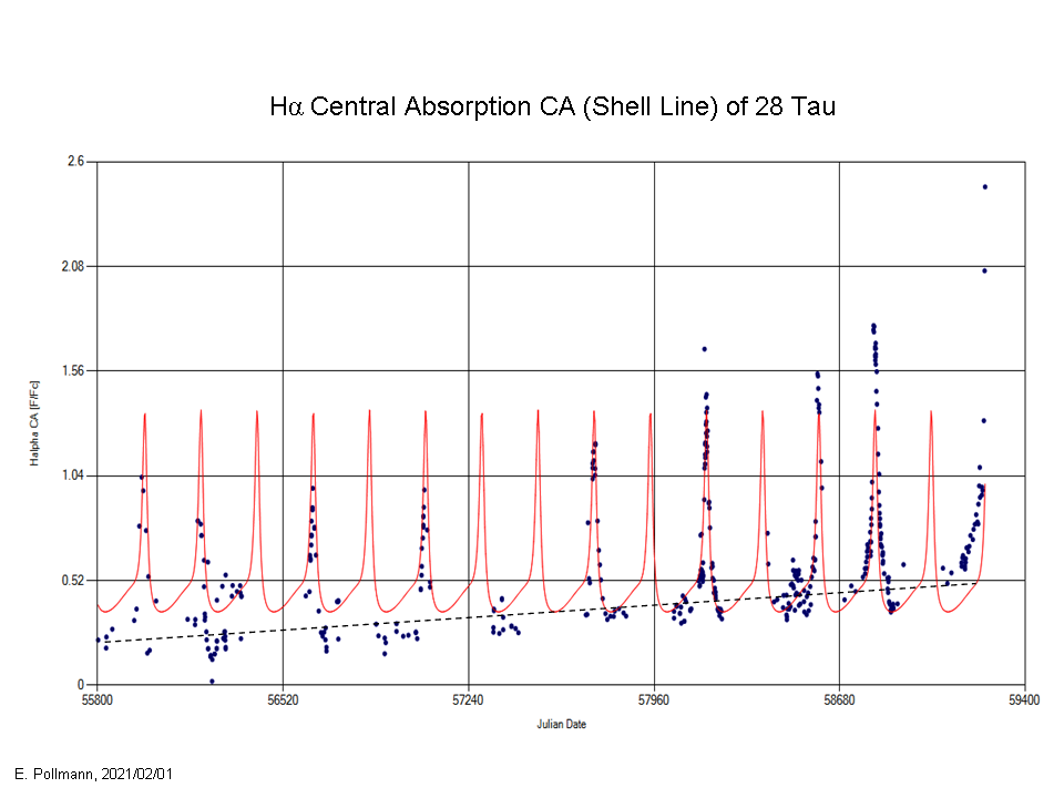

Dear colleagues,
our current monitoring of the Be star 28 Tau includes among others the observation of the depth of the central absorption (CA) in the Halpha emission (see attached Fig.). This CA reflects the disk inclination in the observers view.
The strong periodicity of the max. value of CA with its binary period of 218 days confirms each time the periastron passage of the compagnion star and hence the binary character of 28 Tau.
After the last periastron in our monitoring (JD 2459468) appears now an unexpected increase of CA, which feed the suspect, that there is a second companion star of the system.
Katahira, et al. (1996, PASJ, 48, 317), and Roberts et al. (The Astronomical Journal, 133, 2007 February) reports about signs of a possibility of a third body within their observations.
Possibly our unexpected observed increase of CA after the primary periastron might be in that sense an additional confirmation.
Please try to take spectra of 28 Tau as long as possible.

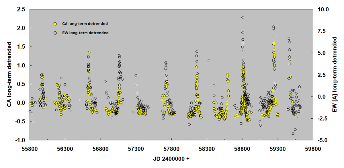

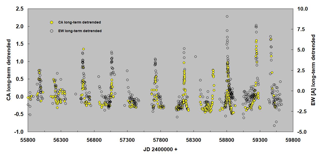

Dear colleagues,
even when I communicated already some diagrams in terms of the time synchronous variability, here again as complementation and for clarification this kind of behavior of EW and CA (period = 280 d).
EW and CA have been detrended of the long-term trends of its original monitorings.

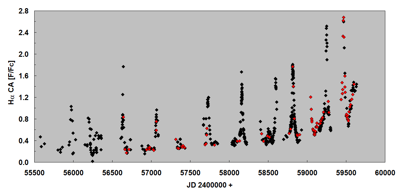

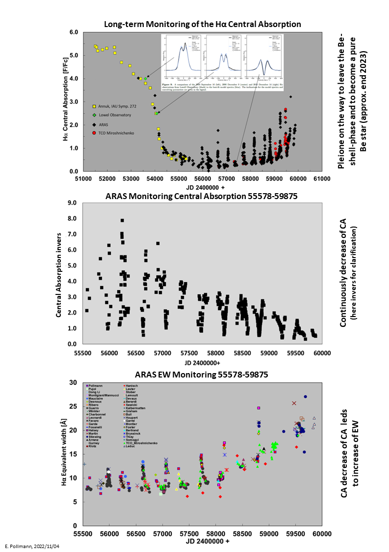

Dear colleagues!
Pleione becomes more and more interesting.
Monitoring of the Halpha central absorption depth and EW provides the following information:
- the next periastron passage will take place at 20. November this year.
- at present the star is leaving the maximum shell phase
- approx. at autum 2023 it reaches the pure Be-phase.
- last Be-phase approx. 2001
