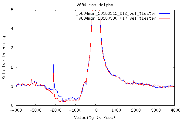

Posted: Wed Mar 30, 2016 10:03 pm
by Tim Lester
V694 Mon for Mar 30th.
Halpha velocity plot compared to my last result on Mar 12th.
Maximum velocity now ~2700 km/sec.

by Paolo Berardi
H-alpha radial velocity plot comparisons.
11 and 18 march:
18 and 30 march:
Recently the absorption component has become more "flat-bottomed" (also visible in the 30.017 march observation by Tim).

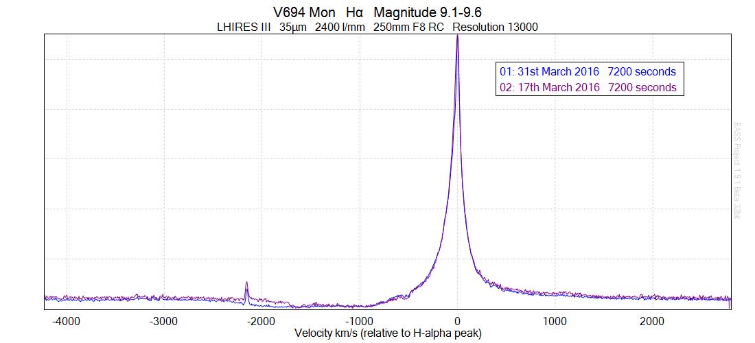

by AndyWilson
I've been following V694 Mon at high resolution (about 13000) during March. I did not notice much change in my spectra from early March, but I did notice the change seen by others when I obtained a spectrum on 31st March. A deepening of the H-alpha absorption at shorter wavelength / higher velocities. Here is a comparison of my spectra from 17th and 31st March.
V694 Mon H-alpha 31st March

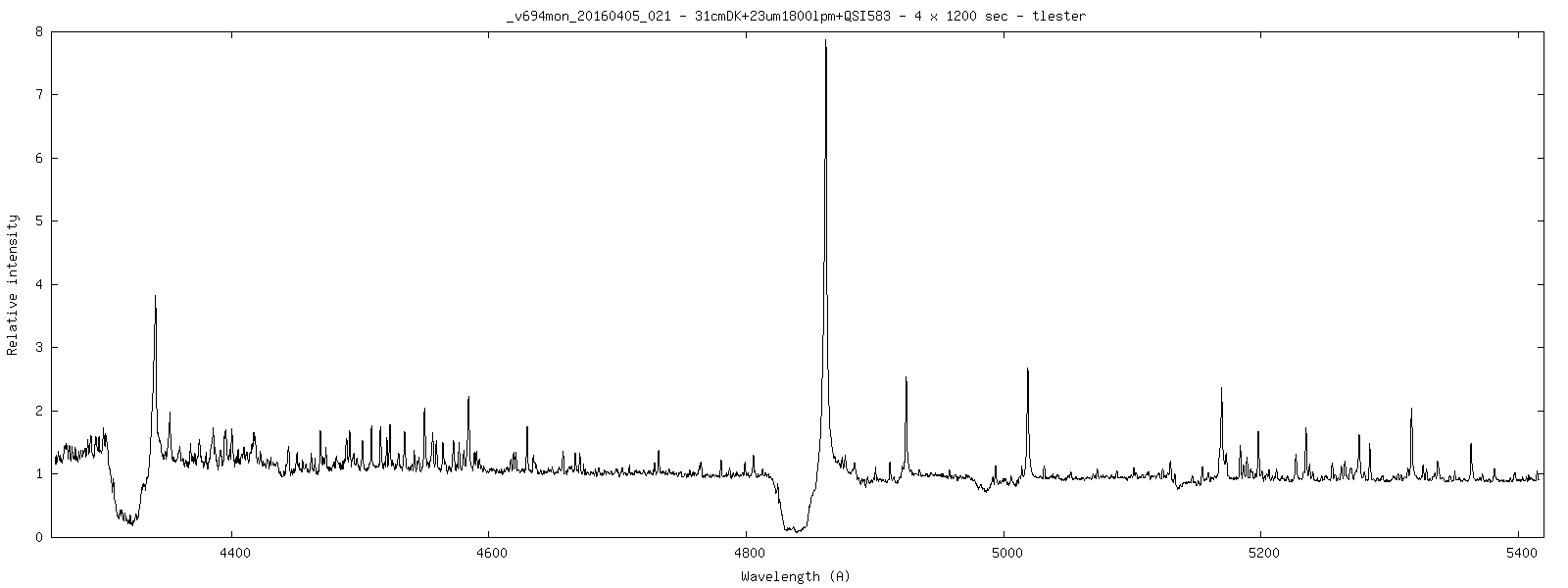

Posted: Thu Apr 07, 2016 4:23 pm
by Tim Lester
Here is my spectrum for Apr 5, centered on Hbeta at R=6000.
