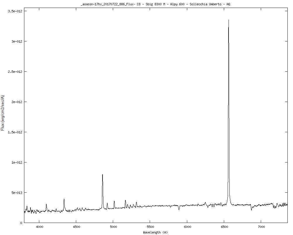

Posted: Tue Jul 25, 2017 12:35 pm
by umberto sollecchia
Bonjour à tous, le week-end passé, moi et Paolo Berardi nous sommes allés à un camping astronomique sur le Gran Sasso à 1600 mt. Dans la nuit du 22/07/2017,nous avons observé la nova aussì avec photométrie.
Voici le profil spectral calibré dans le flux absolu.
Profilo Nova Flux.png (11.21 KiB) Viewed 17140 times
Profilo nova flux 2.png (20.97 KiB) Viewed 17139 times

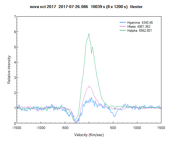

Posted: Wed Jul 26, 2017 8:34 am
by Tim Lester
The nova has brightened significantly. Here is my result for July 26 with my new echelle.
Posted: Wed Jul 26, 2017 12:40 pm
by Paolo Berardi
Hi all! Fran, thanks for your comment. Very nice echelle spectrum Tim! I can confirm the extremely high brightness of the nova. Yesterday I measured V mag 9.15 at ~ 21 UT. Even with 1200 l/mm grating, the continuum is very intense and shows clearly the telluric lines in the H-alpha region (removed in the plots below).
Absolute flux calibration is obtained by rescaling the continuum to a low-res fluxed spectrum taken by Umberto (Alpy 600) at the same time.
H-alpha P-cyg profile changed again. The double absorption minimum seems gone. The heliocentric velocity of minimum is ~ -305 Km/s. The same measurement for Si II doublet return ~ -220 Km/s. Fe II 6456 Rv is ~ -235 Km/s.
Prof. Taichi Kato (who is looking at ARAS spectra, ref. VSNET ml), talks about a similarity of ASASSN-17hx evolution with the old nova V723 Cas.

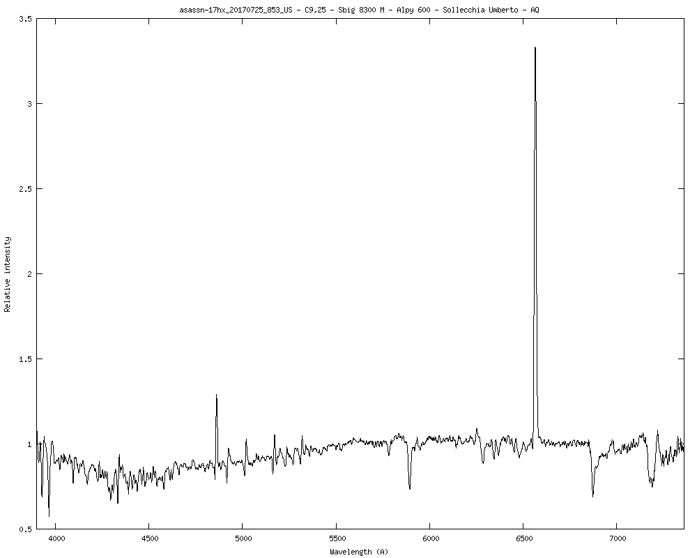

Posted: Wed Jul 26, 2017 2:25 pm
Bonsoir, hier soir, je remarquai la nova. Voici deux profils, le premier calibré flux absolu 12x360, et l'autre 23x360, en intensité relative parce que la photomètrie ne couvre pas tout au long de l'intégration.
Profilo nova flux.png (10.15 KiB) Viewed 17095 times
Profilo nova .png (9.18 KiB) Viewed 17095 times

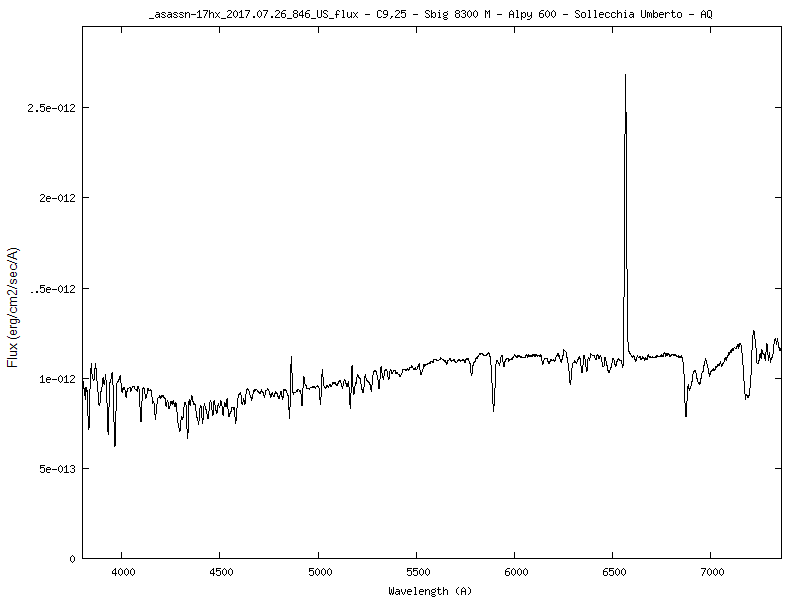

Posted: Thu Jul 27, 2017 1:47 pm
Bonjour à tous, placez le profil d'osservazione de la nuit du 26-07-2017. La nova est encore augmentée par magitudine,maintenant mesurer 8,86.
Umberto.
Profilo nova flux.png (9.8 KiB) Viewed 17055 times

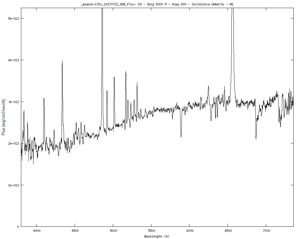

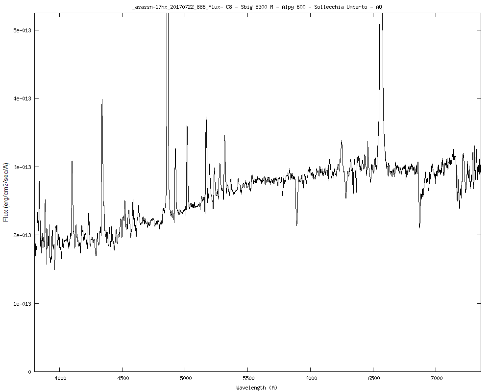

Posted: Thu Jul 27, 2017 3:10 pm
by Francisco Campos
Very interesting all the spectra.
Here is a comparison of two spectra, from July 22th and yesterday. The brightening began 3-4 days ago and the changes are dramatic!
Greetings
