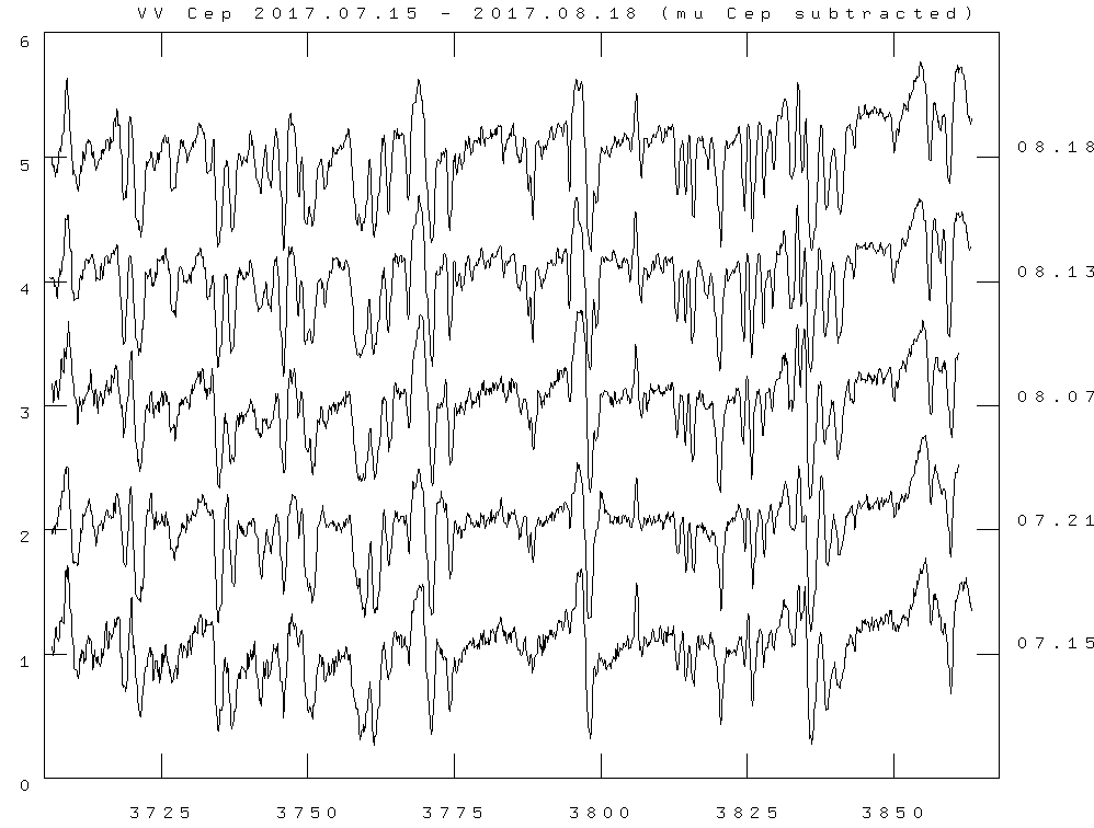

Robin, I've observed the Ca II doublet on 08.18 but nothing much changed compared to 08.13.
On the other hand, I've started to shoot a region 3705-3860A (can concatenate with my already published 3850-4000A) and want to follow it till I can, despite the bad SNR (half in the middle, 1/4 at left end than the CaII region). Got roughly R~3000, and calibration is more troubled (RMS around 0.010 A error, using order=4 polynom - on the contrary, 3850-4000A region has no trouble at all). But, I still consider it to be useful for the overall line identifications - especially with following the absorption changes:
In the last spectra, favouring 4 x 20 minute or even more as told it's much harder.
Mu Cep was good to remove (in this picture), though may need to rework as on the last 2 spectra it seems to be less perfect.
I'm unable to identify many of the lines, some may be FeI but seeing much more. At least, the H8 at 3797 (in the middle) seems to be more or less intact, disturbed only by 1-2 absorption lines.
Sending them to database soon.

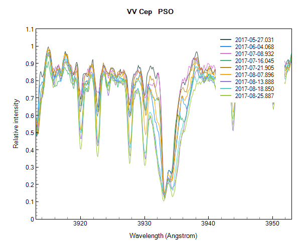

Words enough, here is the latest CaII state, central spike gets separated, and deeper absorptions seem to be permanent:
vvcep_ 20170527_031_PSO_sub.png (86.24 KiB) Viewed 180691 times

this is a really great time series of one of the typical atmospheric eclipse effects.
I hope that Phil Bennett comments these measurements and also the Halpha results soon. There are some open questions.
Ernst

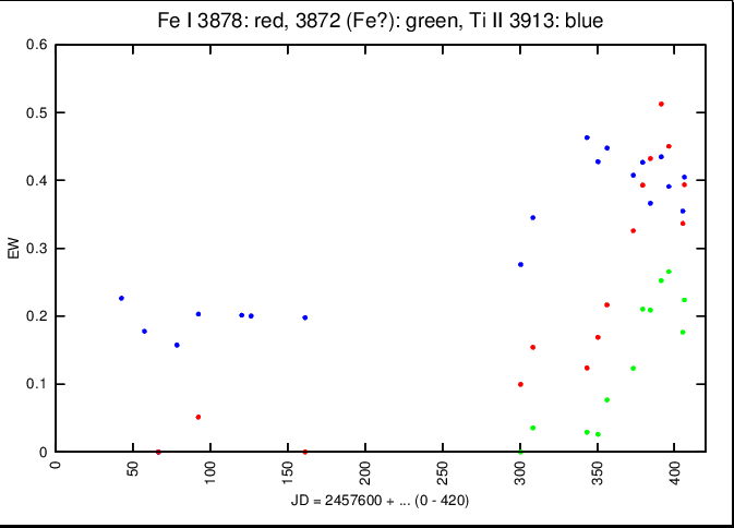

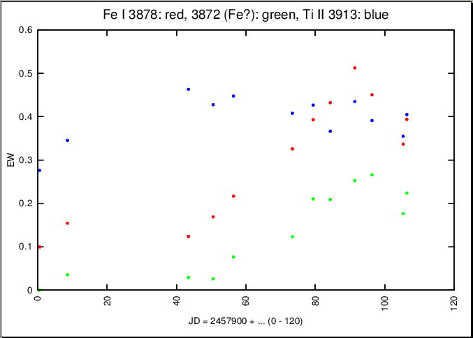

Here is what I could extract, using IRAF/splot/d (deblend) method, gaussian fit for a few selected absorptions (more features later):
and results since end of May:
The Fe I 3878 is the easiest to determine, it has reliable continuum around, visually can confirm its appearance is really starting from the end of May.
The 3872 (Fe ?) is coming up later only (2017.07.21 = JD: 2457956 visually to appear).
The Ti II 3900A is blended by Fe line, can use only 3913A - however, continuum is harder to determine here, I'd expect its EW was 0.2 all the last year. And, is definitely detached from the Fe I feature.

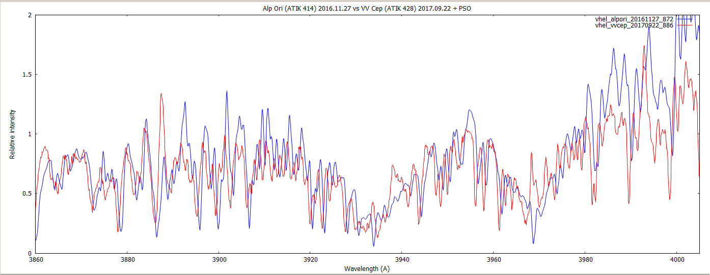

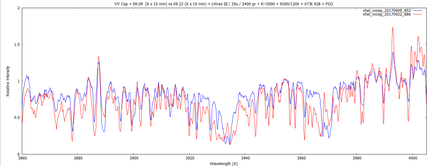

Re: VV Cep: Fe absorptions increase around Ca II doublet

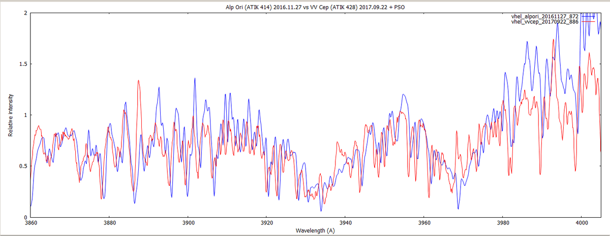

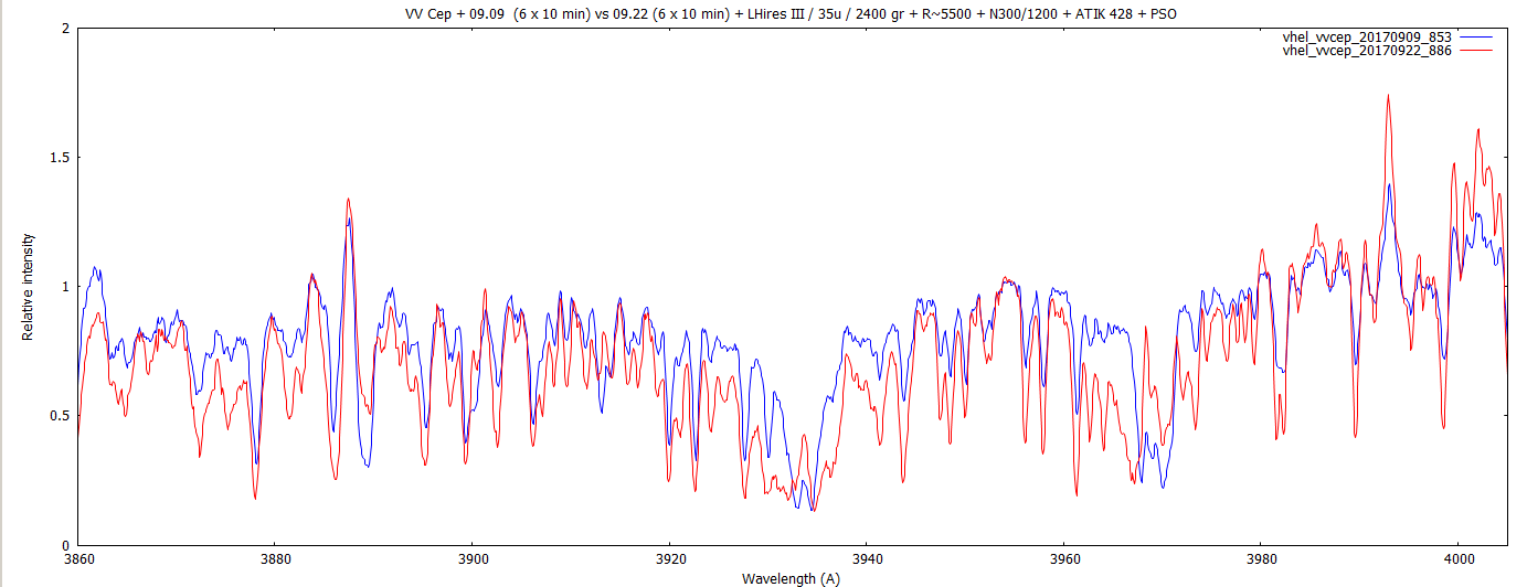

Dear Audience,
Due to the bad weather in the past 2 weeks, I must have missed a bigger event of the eclipse:
Question whether if accidentally something else has hid the B component - not the M core -, but now VV Cep got resembling more to the Alp Ori, roughly by 70-80% visually (precise calculations to come later):
(The RV shift in between is expected, both spectra only helocentric corrected.)
Still left some time till the totaal eclipse, but unsure how much.
