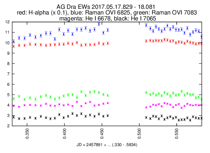

Posted: Sat May 20, 2017 9:47 pm
by Peter Somogyi
Hello, here is my extracted result about variability of EWs on in the red part (same night as others already reported 05.17-18):
- extracted AG Dra EWs
- AGDra_pso_20170517_EWs.png (28.18 KiB) Viewed 7908 times
This graph is showing error bars, calculated by EWs of conitnuum itself near to it at the same length of selected region, using the stddev formula for the overall result (all scripted via IRAF).
Got 0.15 for the Raman OVI 6825, and between 0.8-0.11 for the other lines (H-alpha is special here: division by 10 except the error).
Exposures was taken of 10 -> 8 -> 5 minutes decreasing in the 2nd half of the night (after scope turnover + took other bands spectra).
This reduction was due to H-alpha started to have a pixel reaching the max ADU on the ccd.
All in all, Raman profiles flicker by 10% during a night, shorter integration times are meaningful!

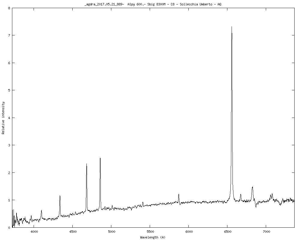

Posted: Mon May 22, 2017 9:45 am
by umberto sollecchia
Bonjour, voici le profil de l'observation de la nuit 21/05/2017.
- Profilo Ag Dra.png (8.2 KiB) Viewed 7880 times

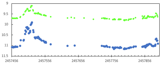

Posted: Mon May 22, 2017 3:50 pm
Thanks to all for the very coverage and the quality of the spectra.
It looks like the event is already finished. Very weak and very short.
- AGDra_AAVSO.PNG (7.83 KiB) Viewed 7869 times
Of course, we go on the good job!

Posted: Tue May 23, 2017 7:15 am
An update from Rudolf Galis:
The recent activity of AG Dra looks really strange. After promising increase of its brightness (around 0.1 mag/day in B filter), the magnitude stopped to raise and it is almost at same level as before this event, now. The event recalls the pre-outburst in 2015 with maximal brightness around 10.7 mag in B filter. Is this event another pre-outburst, as we have already recorded in the photometric history of AG Dra? There is still a chance for main outburst: if we assume that the last outburst occurred around JD 2 457 517 and the time interval between outbursts of AG Dra varies from 300–400 days, the outburst window is open until June 12, 2017. Another possibility is that AG Dra will return to quiescence stage as we have already detected such behaviour during the weak activity stage 1963–66.
In any case, I suggest to continue with daily monitoring of AG Dra at least to mid of June. Subsequently, we would redefine the observational schedule of AG Dra. Thank you for your cooperation.
Rudolf Gàlis
Let'us go on the good job
Thanks to all

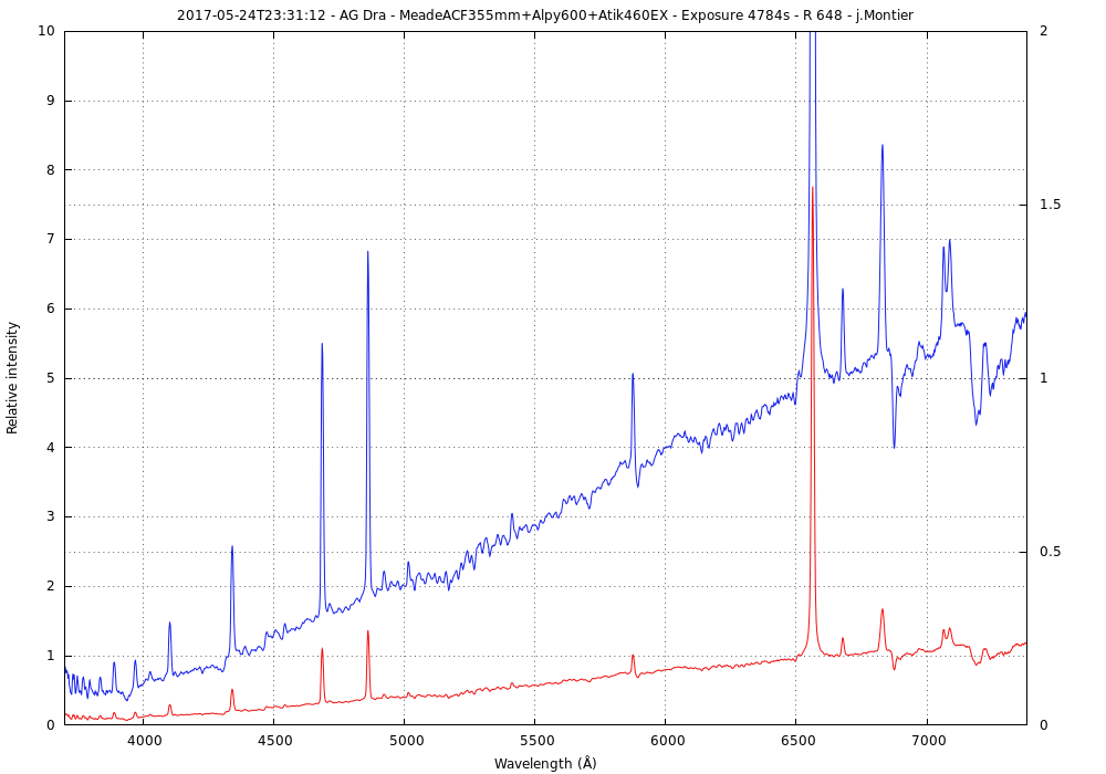

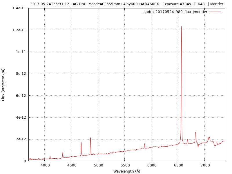

Posted: Thu May 25, 2017 5:58 pm
by Jacques Montier
Hello all
AG Dra spectra the 2017/05/24.980
Meade ACF 355mm f/d 7 + Alpy600 + Atik460EX
- 20170525-agdra-double-ech.png (76.53 KiB) Viewed 7769 times
- 20170525-agdra-flux-v2.png (39.88 KiB) Viewed 7769 times
