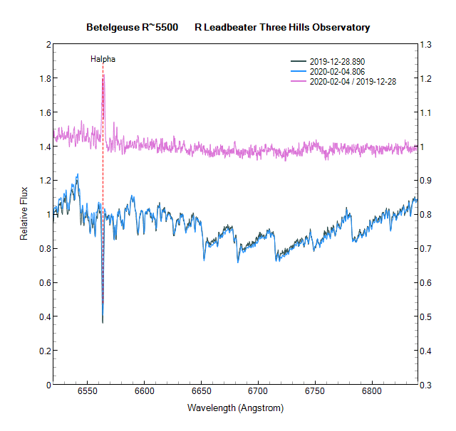

Hi James
James Foster wrote: It still looks like Betelgeuse EW at Ha has decreased significantly since last year.
I agree. Dividing my spectra for 2020-02-04 by 2019-12-28 confirms that the H alpha absorption has indeed reduced since the end of last year.

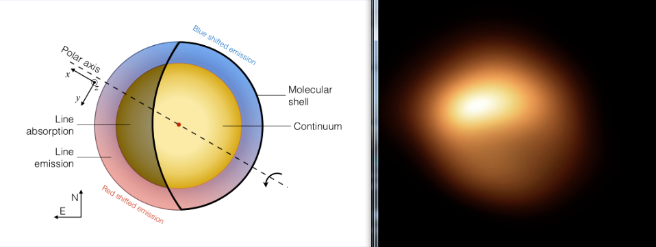

Posted: Sat Feb 15, 2020 7:54 pm
Here is a comparison between the doppler and VLT image assuming the VLT image is orientated the same. (The VLT image was taken in December though so might not represent the current state)
