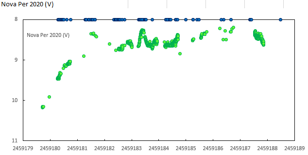

Update of the lightcurve (AAVSO V and ARAS Spectra)
Still at maximum with a trend of brightening.
- NovaPer2020_LC4.PNG (11.62 KiB) Viewed 12776 times

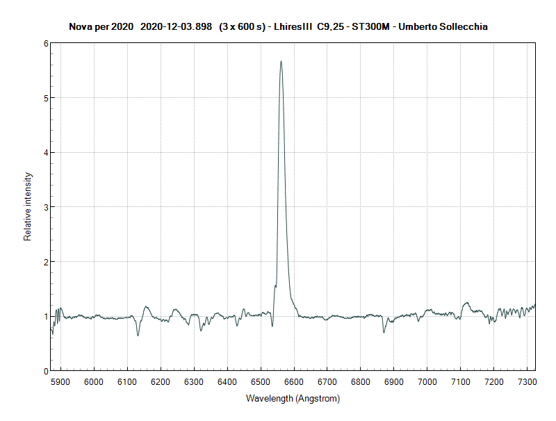

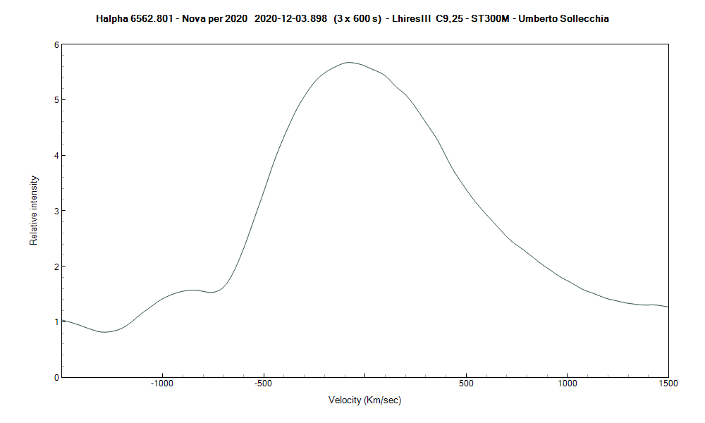

by umberto sollecchia
Une nouvelle contribution de ma part à l'observation de cette nova.
- novaper2020_20201203_898_ H-alfa-Umberto Sollecchia.png (28.48 KiB) Viewed 12749 times
- novaper2020_20201203_898_VR_Umberto Sollecchia.png (18.53 KiB) Viewed 12749 times

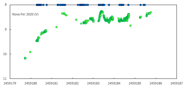

Posted: Sat Dec 05, 2020 8:21 am
Excellent spectra of the near IR range, Palo and Umberto. Very appreciated.
Update of the lightcurve and ARAS monitoring:
- NovaPer2020_LC5.PNG (13.89 KiB) Viewed 12685 times

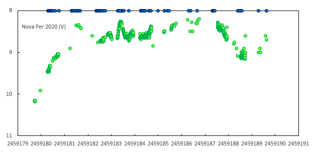

Update:
- NovaPer2020_LC6.PNG (14.12 KiB) Viewed 12610 times

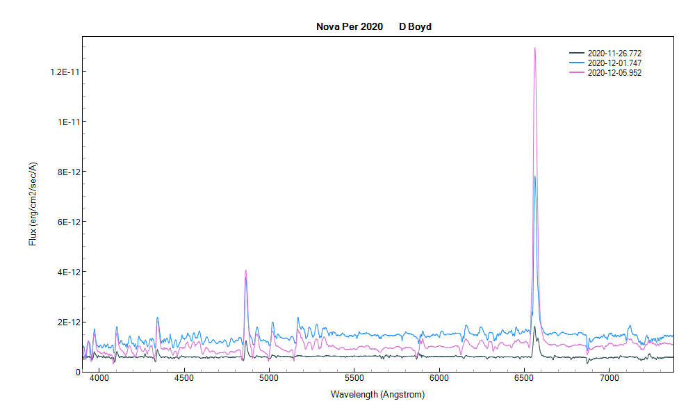

by David Boyd
This plot shows how the spectrum of Nova Per 2020 (V1112 Per) has changed since the first spectrum was recorded 9 days ago. The continuum flux level has risen then fallen as the magnitude changed while the flux of the H-alpha emission line is now rising steadily.
What will it do next?
- Nova Per 2020 - 26 Nov to 5 Dec.png (50.55 KiB) Viewed 12569 times

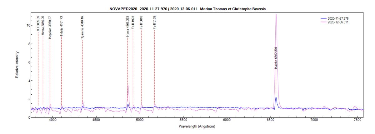

Posted: Sun Dec 06, 2020 9:00 pm

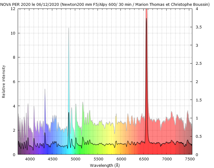

by Christophe Boussin
Here is our update for the Nova Per 2020 with the following spectrum obtained last night the 6th of December at 00 h 16 TU with an Alpy 600 (resolution of 511, JJ = 2459189.5111) and an acquisition time of 30 min :
- Nova Per 2020 on December 6th, 2020
- _novaper2020_20201206_011_Marion Thomas et Christophe Boussin_3700_7565.png (75.93 KiB) Viewed 12559 times
- Nova Per 2020 on November 27th and December 6th, 2020 (identification of some lines from PlotSpectra)
We also note a very significant evolution of the spectrum in 8 days. The FeII lines are very clearly visible in our last spectrum and the relative intensity of the Halpha line has increased dramatically !
Clear skies,
Marion THOMAS et Christophe BOUSSIN
