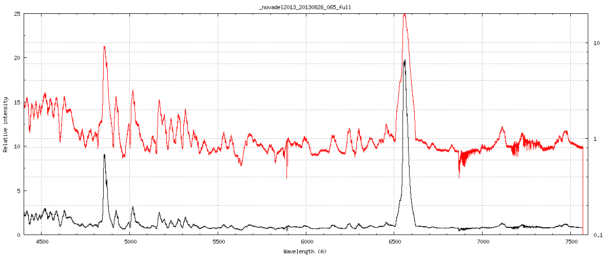

there is a good chance that we can get some spectra of Nova Del 2013 from the IAC80 telescope equipped with an eShel on Teide. Here a preview:
eShel 4x60 sec with IAC80 telescope at Teide, red: log scale at right
In case of bad weather over all of Europe this might be very valuable.
