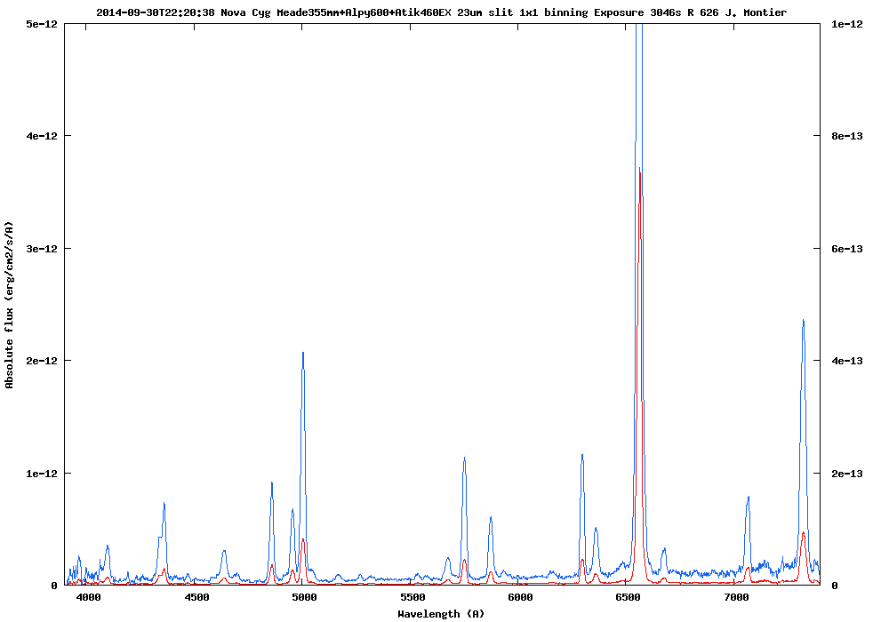

Re: Nova Cyg 2014 = PNV J20214234+3103296
Posted: Wed Oct 01, 2014 3:33 pm

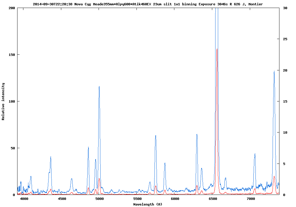

by Jacques Montier
Nova Cyg on 2014/09/30
Relative intensity
Absolute flux
Evolution from 09/01 to 09/30
One could see the 4959A and 5007A [OIII] lines and 5876A and the 6678A and 7065A HeI lines.
Regards,

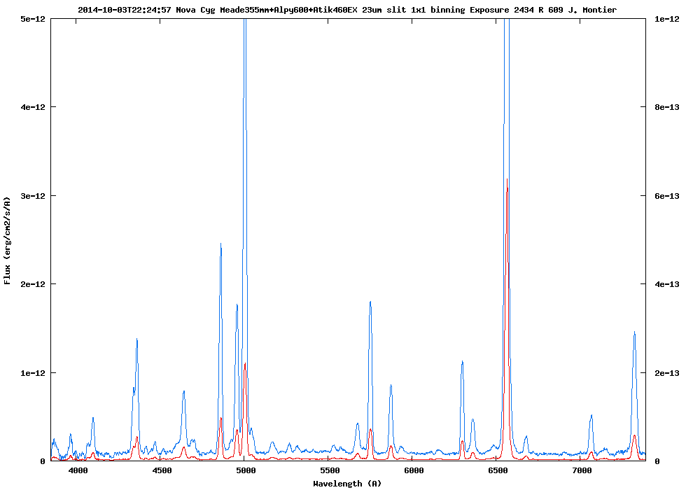

Posted: Sat Oct 04, 2014 10:13 am

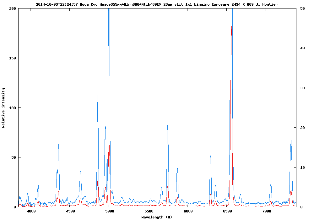

by Jacques Montier
Nova Cyg on 10/03
Relative intensity
Flux (erg/cm²/s/A)
Regards,

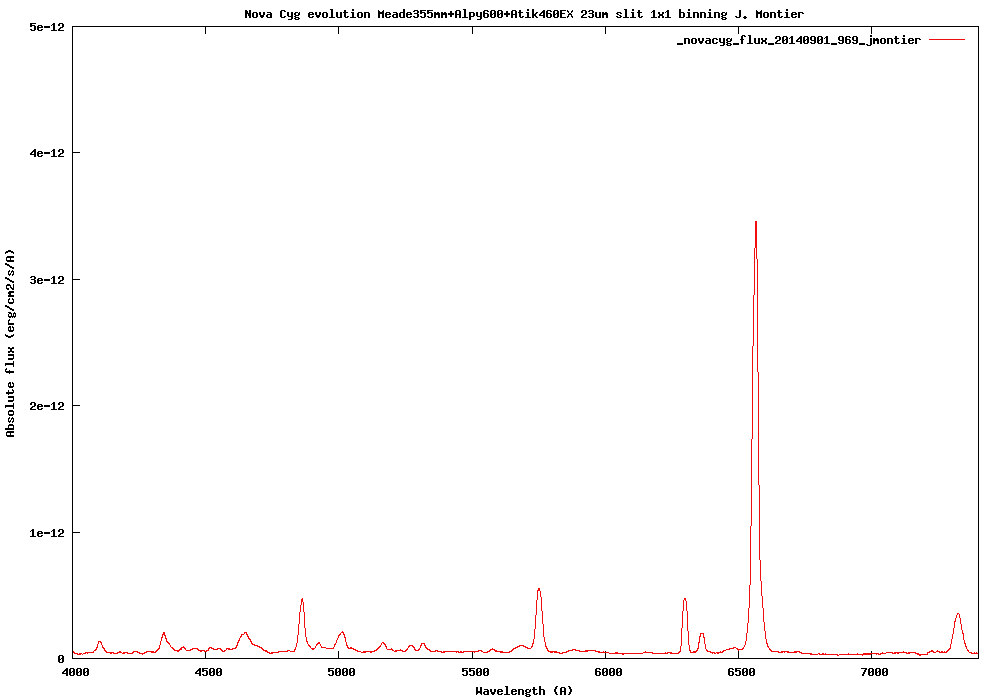

Posted: Mon Oct 06, 2014 3:28 pm
by Olivier GARDE
Evolution de la Nova entre le 30 juillet et le 3 octobre.

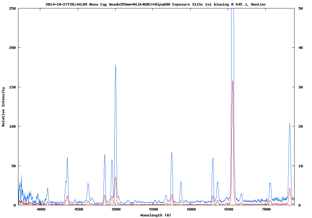

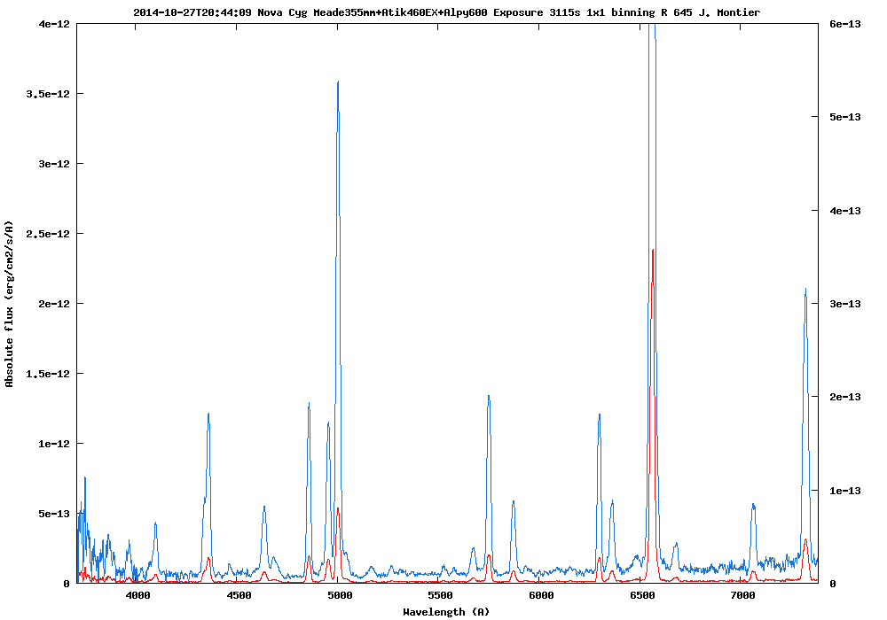

by Jacques Montier
Nova cygni of the night
Relative intensity
Absolute flux

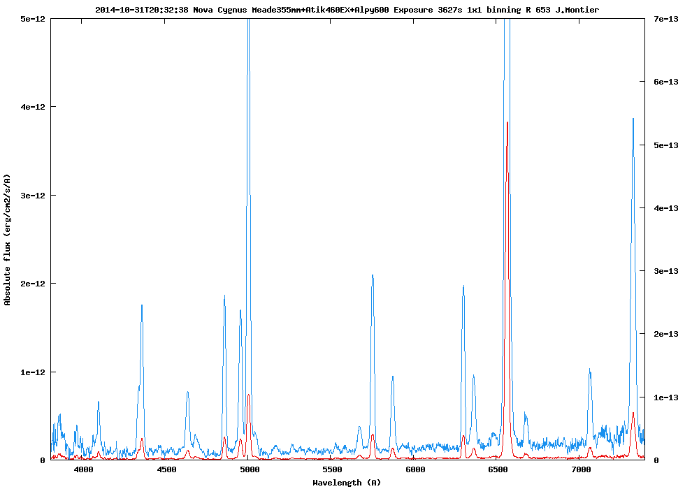

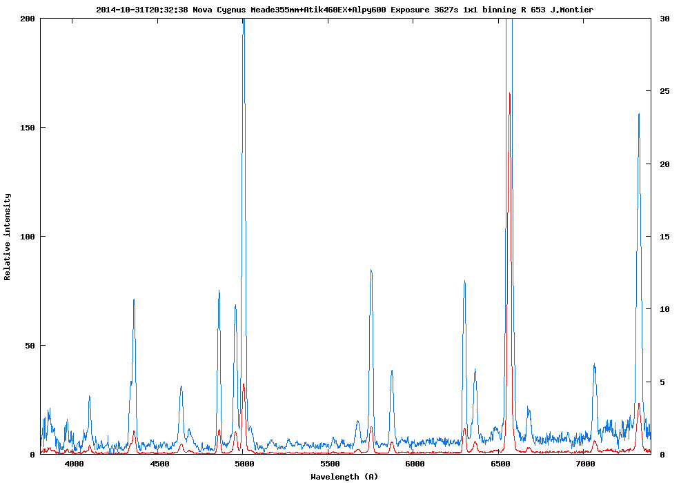

by Jacques Montier
Nova Cyg on 2014/10/31
Relative intensity
Absolute flux (erg/cm²/s/A)
Regards,

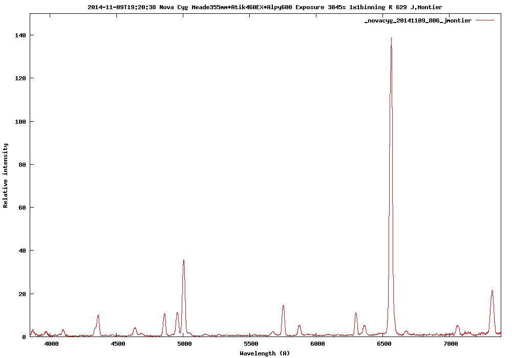

Posted: Mon Nov 10, 2014 4:10 pm

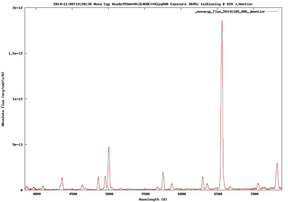

by Jacques Montier
Nova Cyg on 2014/11/09
Relative intensity
Absolute flux
Regards,

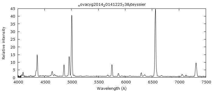

Posted: Thu Dec 25, 2014 7:20 pm
Nova Cyg 2014
[OIII] 5007 presque aussi intense que H alpha
