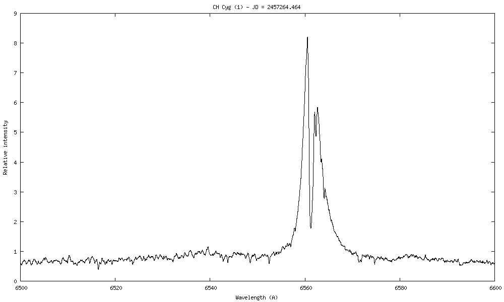

A time serie graph of CH Cyg during 3H30

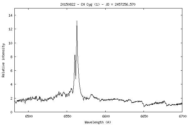

10x180s exposures of CH Cyg on 2015/08/22.
CH Cyg Halpha profile is quite stable.

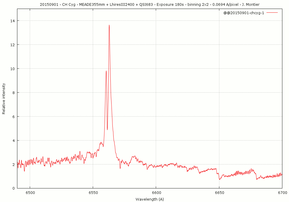

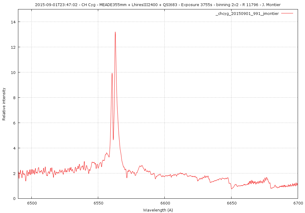

CH Cyg of the last night 2015/09/01
Time series of 18 x 180s
Regards,

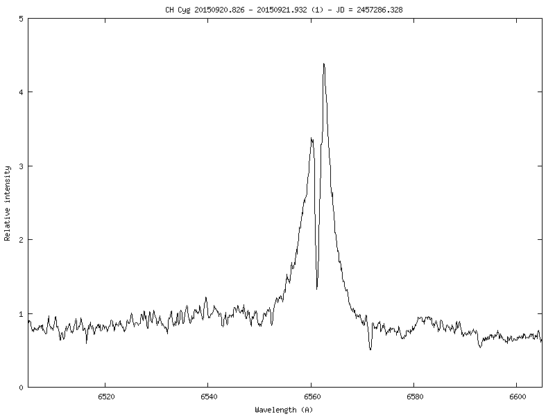

CH Cyg was not at rest yesterday (2015.09.20, 31 x 5 min):
I had to discard the 24. exposure due to cosmic ray has hit directly the H-alpha region, that has been interpolated by (23+25)/2 here.
Sky was poor at this time, so as the SNR.
