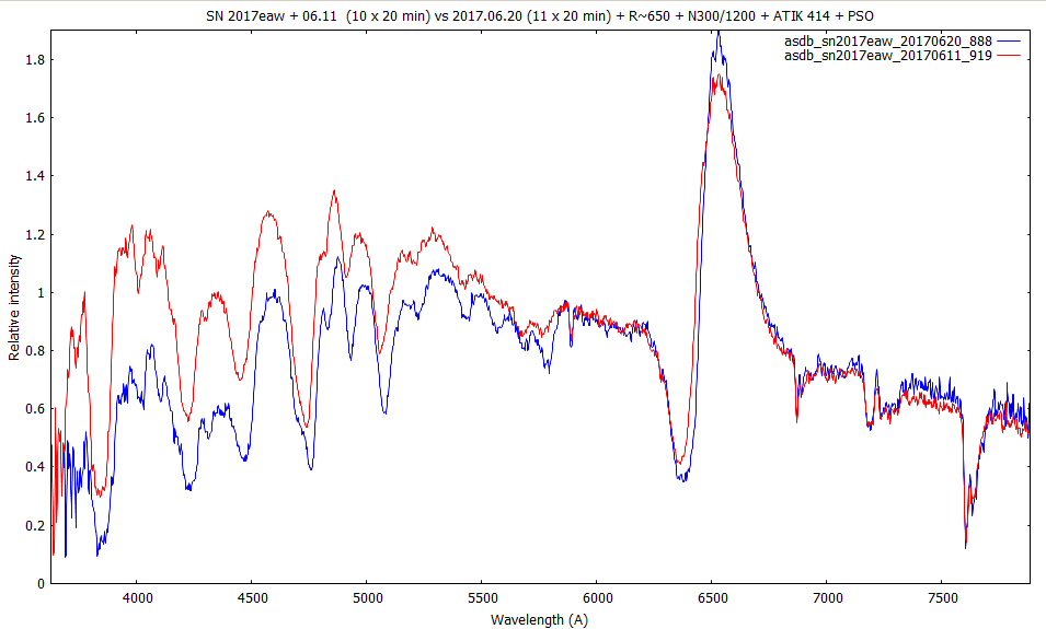

Result from this week:
Some deeper absorptions appear in the range of 5300-5850A (I can't identify at the moment).
- Peter

Last week I've also made a shot (11 x 20 min - once cloud in between), but reddening seems to have settled - some absorptions in the green have become deeper:
I would like to assess all RVs on a graph in the end (if manage to identify all lines), planning to shoot 1-2 weekly till possible.
