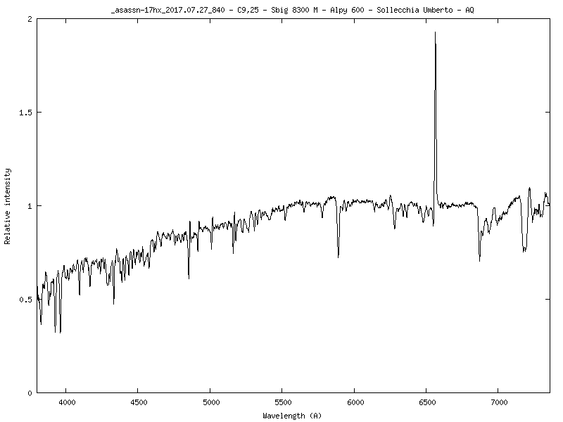

Posted: Sat Jul 29, 2017 4:01 pm
by umberto sollecchia
Bonjour à tous, placez le profil d'osservazione dans la nuit du 27/07/2017.Umberto
Profilo nova.png (6.49 KiB) Viewed 12910 times
Posted: Sat Jul 29, 2017 6:15 pm
by Joan Guarro Flo
This graph is the comfirmation of Olivier's observations.
Regards, Joan.

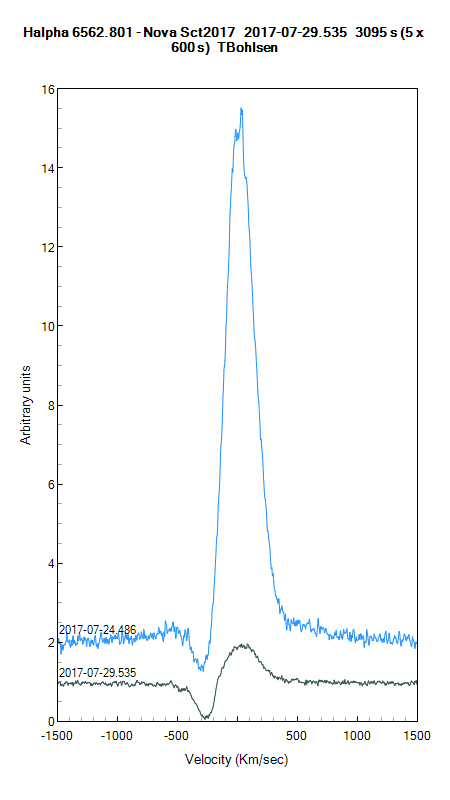

Posted: Sun Jul 30, 2017 5:02 am
by Terry Bohlsen
I took another spectra of this interesting nova last night using my LHIRES at ~R=14000. The strength of the Ha line has dropped significantly compared to the continuum.
Terry
