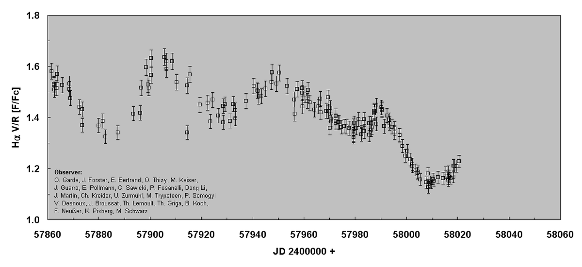

Re: VV Cep: Fe absorptions increase around Ca II doublet
Peter,
you wrote:
As for the H-alpha R/V graph, till those periodic variations not subtracted reliably (O-C ?), having those variations on top I can't read anything off from that graph even when I'd believe in its accuracy (something only a professional could tell us about).
The so-called violett-to-red ratio V/R does have its roots in the basic research of Be stars during 1991-98, mainly performed by R. W. Hanuschik and A. T. Okazaki. In order to understand what V/R really means, I highly recommend the study of following literature:

Without understanding the nature of the parameter V/R it will be very hard, to appreciate and use the high content of information in some cases.
Hope, the study of this literature helps.

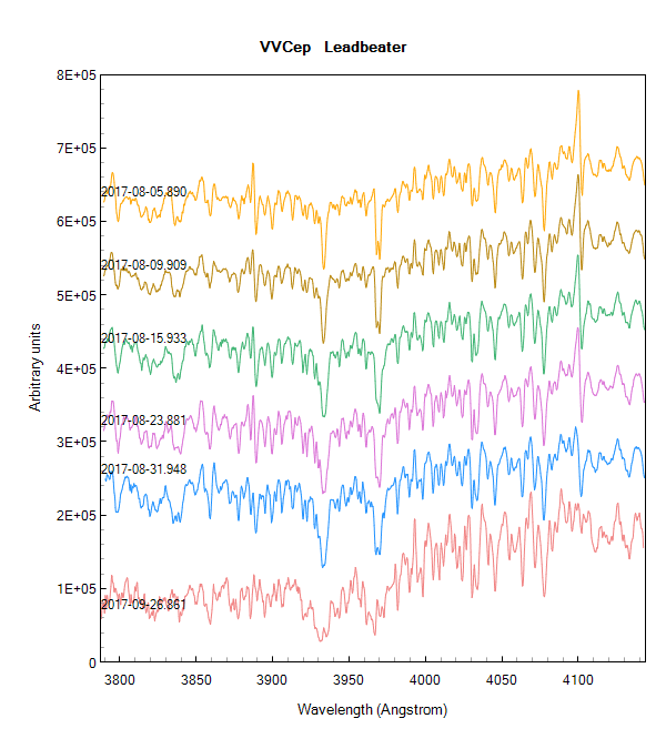

Attached are a series of spectra of VV Cep covering 3800-4150A at R ~2500 (variable 3000-1500 across the range due to LHIRES chromatism)
Note the loss of H Balmer emission, broadening of the Ca II H K lines and relative drop in continuum flux below ~4000A, particularly noticeable in the latest spectrum recorded 2017-09-26
- vvcep_20170805-20170926_Leadbeater.png (94.99 KiB) Viewed 196559 times
- Posts: 420
Thank you Robin for the confirmation, it is really a start of a classical eclipse, in shortly speaking.
We can still argue how much partial and accurate date of a total eclipse start (if it will ever be total...), but it has certainly begun in the past 1-2 weeks.
I'm shooting it very soon again, with assessing the B light ratio - haven't seen yet any proof that it's had fully vanished by now.
It would be nice to have a professional to confirm and/or elaborate the state which phase we are at exactly.
- Peter

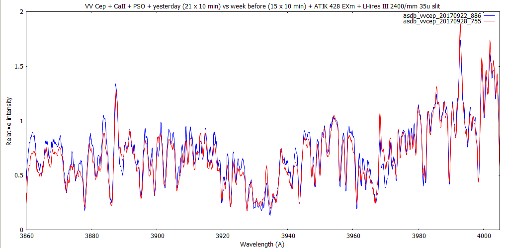

Fresh result from yesterday:
No relevant change since last week's surpise, some ref. star problem during the 3.5 hours might have caused a global continum shift.
H6 and H5 (H5 is almost together with CaII, as usual) along with the CaII central emissions are visible at this resolution, their origin is probably from the surrounding nebula, basically these features must be known.
- Peter
