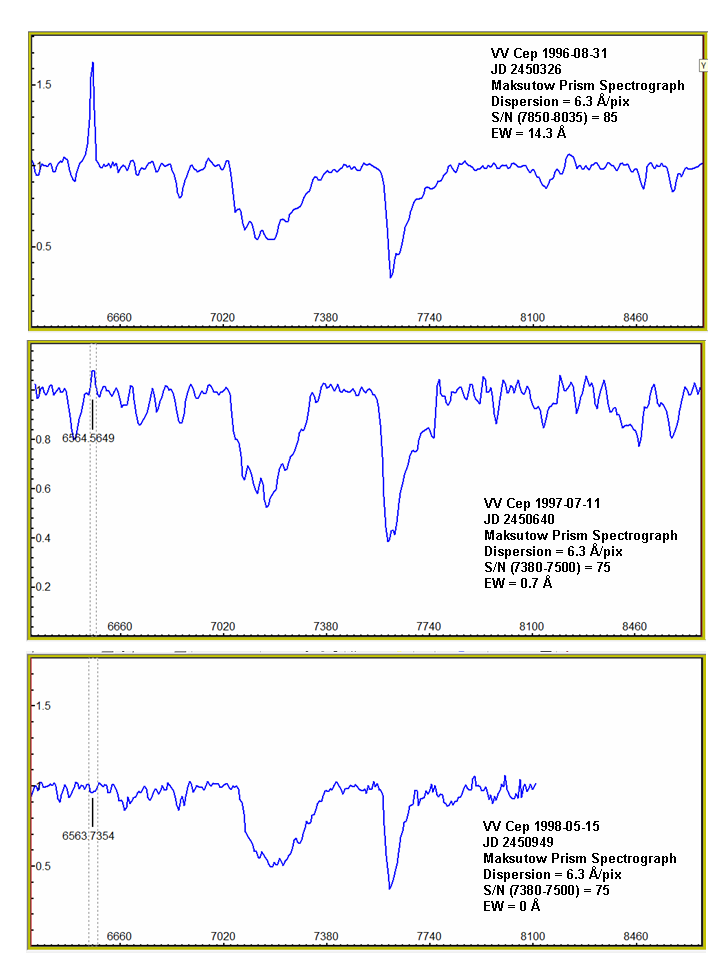

Re: Observation state of the campaign
Posted: Sat Aug 04, 2018 4:59 pm
by Ernst Pollmann
Hi Andrew,
I assume, you are thinking about the small EW increase after the 1997/98 eclipse, right?
If so, then my interpretation would be another than yours:
I am still convinced that the 43 day period, which manifests in the EW variability of our current campaign, results from a precession movement of a disk-like emission region around the B star.
But the observation frequency has to be dens enough, in order to evidence them. This was the case after the 1997/98 eclipse only for a short observation period. Within this short period one could recognize a weak cyclic variability, which we observe today very clear.
With other words: an EW and an antisynchronously V/R periodicity was always present in the past 20 years. But probably with a significant distinguish: the mass and the size of the emission region around the B star was much larger than nowadays. I personaly suppose that also the precession period was at that time corresponding much larger.
And we don´t have to forget that the Halpha emission results from recombination of hydrogen atoms, which arises in the ionized gas around or near the B star. That process might be generated in the bow-shock front, in front of the emission region, which moves with supersonic velocity on the orbit of the B star through the M star wind.
Ernst
Posted: Sat Aug 04, 2018 6:37 pm
by Peter Somogyi
Just stepping in with an antiproof for reflecting dust: today, the whole profile in the B star's max region (3800-4000A) is mostly matching with the profile of Alf Ori (whilst B was there, it was 4x bigger than the M component).
In other words: as of today, the B component's light ratio is close to zero - till some continuum subraction errors. The drop is more than 95% (might be 100% but I have some errors). The drop of H-alpha is order of magnitudes less.
Something I can imagine, that the more opaque red portion with H-alpha is glowing through the M layers anyhow. This way Robin's idea might work.
For this, a weaker antiproof is the H-alpha profile shape change (= the high RVs completely disappeared, lower RVs remained and lowered). Which means, high RVs (should ne B star's neightbourhood) would need to remain today then. But the high H-alpha RVs clearly disappeared, not only decreased.
Be aware H-alpha's central region after M substraction is pyramid, or the outer nebula taking out some of its central absorption. Telling just not to think it's similar to a gaussian double peak common with Be shell stars (the middle absorption is more like a direct cut). Of course, Ernst has much more experience here.
- Peter
Posted: Sun Aug 05, 2018 7:52 am
by Ernst Pollmann
Andrew, Peter,
as Phil Bennett already said (and I repeat my statement too): we have to consider that the emission region (disk or not disk that´s the question) is probably caused by a bow shock front due to the supersonic velocity of the B star on its orbit through the M star wind.
It seems that this "emission region" is today essential smaller than 1997/98.
This fact of observation does lead to a further "core question": what are the reasons for that?
What, if the inclination angel of the rotational axis of the B star (and hence the rotational axis of the emission region) related to the orbit has changed?
Ernst
