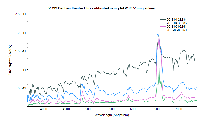

Posted: Sun May 06, 2018 11:29 pm
Tonight's spectrum (flux calibrated using AAVSO V mag values) compared with previous spectra. Although the H alpha line remains strong relative to the continuum, it is now actually reducing in absolute flux
