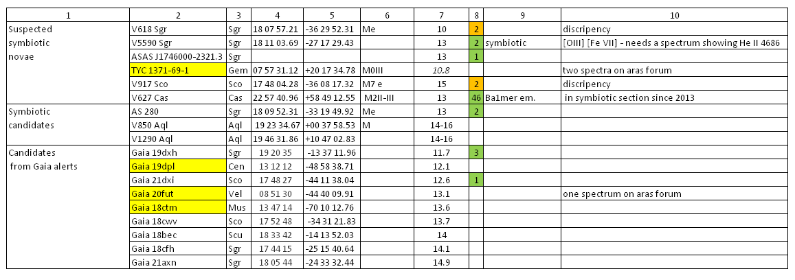

Posted: Mon Jan 31, 2022 2:34 pm
An update on the program proposed by Jaroslav:
Column 8: number of spectra in the database.
Orange: discripencies in the spectra. New observations needed. Please also send an autoguider image if possible.
Yellow: observable targets for the next weeks/months.
TYC 1371-69-1, Gaia 19dpl, Gaia 20fut: spectra shown on the forum , but not sent to the database (sauf erreur de ma part).
V5590 Sgr: clearly symbiotic with strong [Fe VII] as shown by Peter. A spectrum showing He II 4686 should be welcome.
AS 280 identification. @ Peter: if you have [OIII] 4959, you *must* have [OIII] 5007 about x3 more intense. Thus [OIII] 4959 should be removed.
Good hunt!

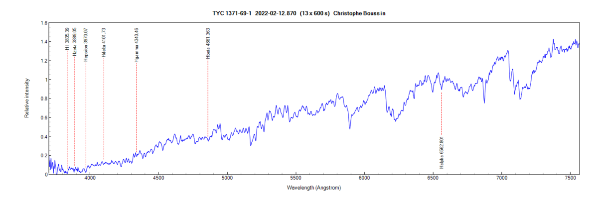

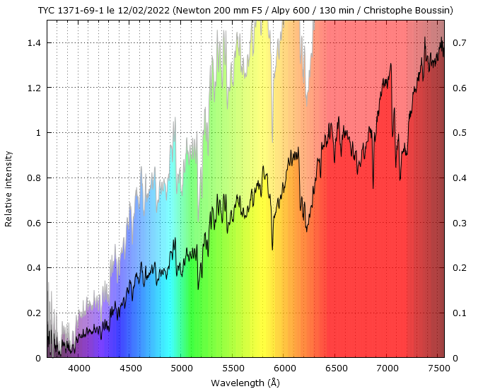

Here is my new contribution to the suspected/misclassified symbiotic stars.
I obtained the following spectrum of TYC 1371-69-1 with a spectral range from 3700 to 7565 A the 12th of February at 20 h 52 TU with my Alpy 600 (resolution of 521, JJ = 2459623.3697) and an acquisition time of 130 min (13 x 600 s) :
TYC 1371-69-1 on February 12th, 2022 (3700-7565 A)
_tyc1371-69-1_20220212_870_Christophe Boussin_3700_7565.png (105.2 KiB) Viewed 22917 times
Identification of Balmer lines from PlotSpectra :
TYC 1371-69-1 on February 12th, 2022 (identification of Balmer lines from PlotSpectra)
No balmer lines are visible in emission.

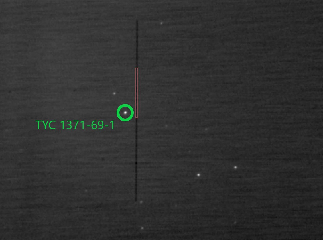

Guiding camera field
CHAMP_TYC 1371-69-1_legende.jpg (80.74 KiB) Viewed 22917 times
