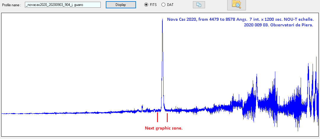

You can see Nova Cas 2020 through the SC16" and the NOU_T echelle with one ATIK460EX.
Cheers, J. Guarro.
_NOVA CAS 2020A.png (14.34 KiB) Viewed 10874 times
_NOVA CAS 2020B.png (12.68 KiB) Viewed 10874 times

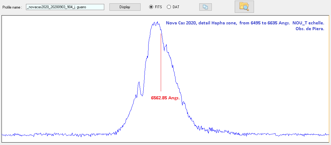

Another classical nova with oscillation at maximum luminosity.
Daily monitoring is recommended
Database: http://www.astrosurf.com/aras/Aras_Data ... as2020.htm
Close look of Halpha line the 5.9 September, extracted from eShel(2) spectrum at R=12000 (T250 telescope + ASI6200MM camera):
and after H2O line removed (synthetic spectrum of the atmosphere):

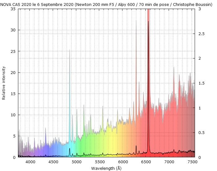

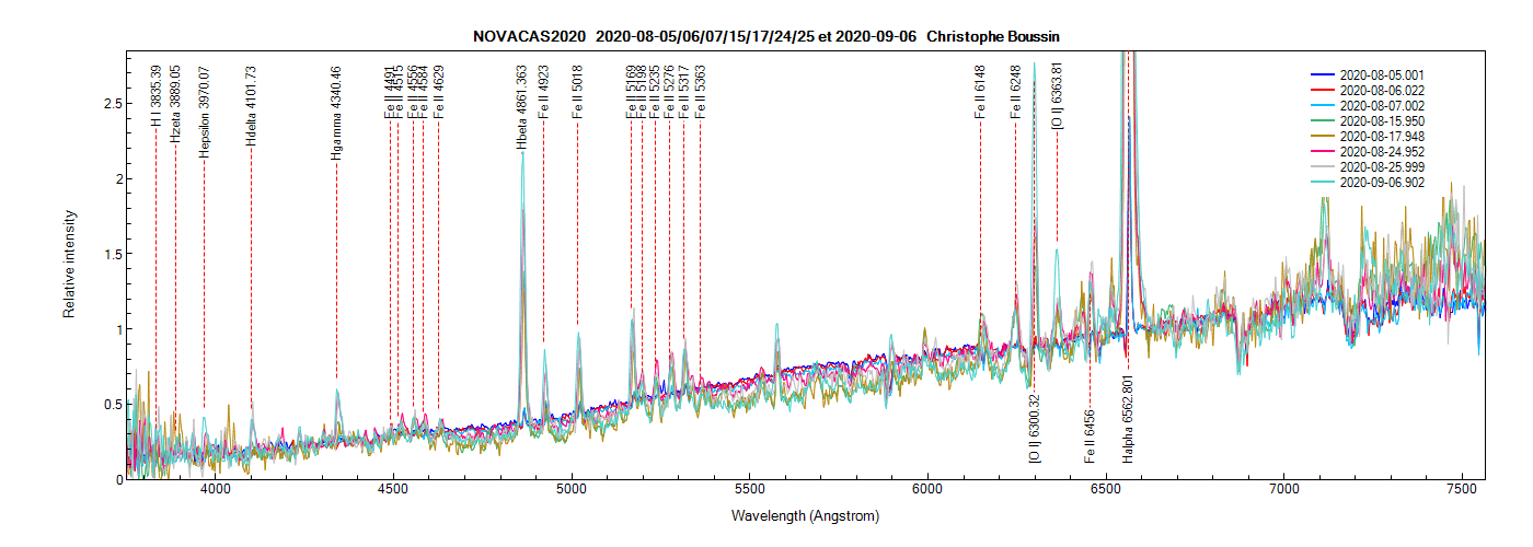

Here is my new update for the nova Cas 2020 with the following spectrum obtained the 6th of September at 21 h 38 TU with my Alpy 600 (resolution of 514, JJ = 2459099.4016) and an acquisition time of 70 min :
Nova Cas 2020 on September 6th, 2020
_novacas2020_20200906_902_Christophe Boussin_3750_7565.png (77.91 KiB) Viewed 10745 times

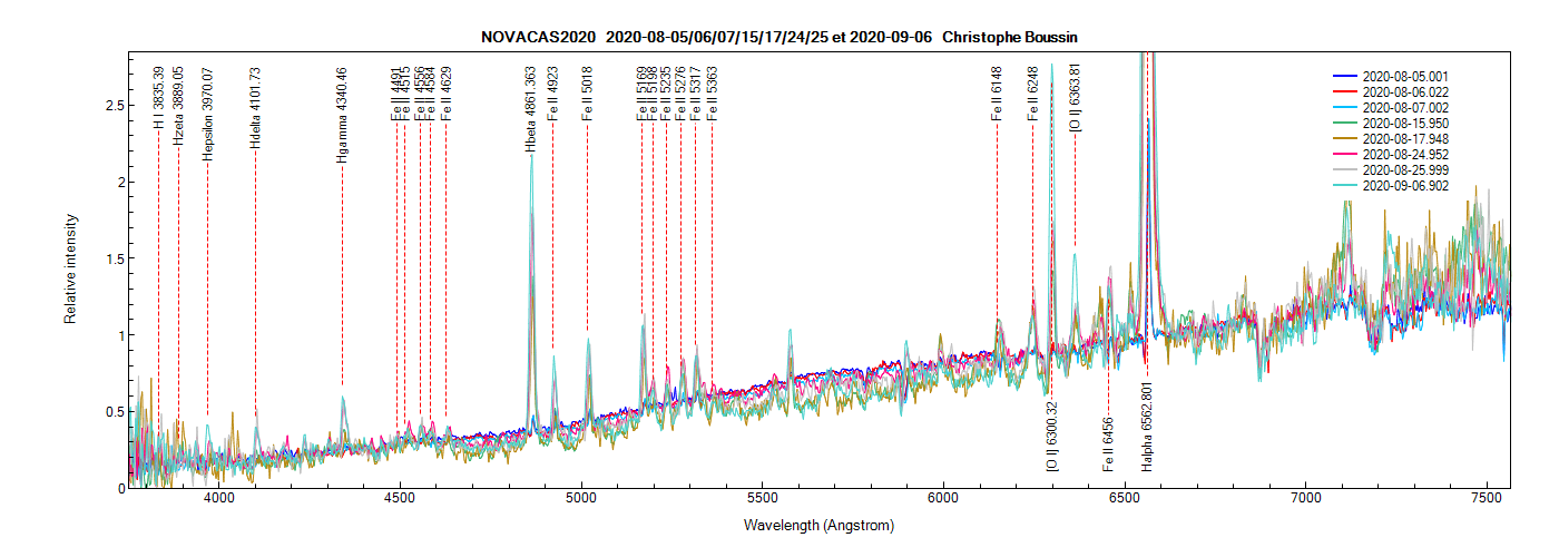

Nova Cas 2020 on August 5th, 6th, 7th, 15th, 17th, 24th, 25th and on September 6th 2020 (identification of lines from PlotSpectra)

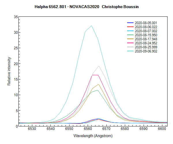

The relative intensities of the Balmer lines continue to increase and more particularly that of the Halpha line. Those of [OI] lines at 6300A and 6364A have clearly increased since August 25. The lines of FeII remain evident.
Evolution of the Halpha line :
Halpha line on August 5th, 6th, 7th, 15th, 17th, 24th, 25th and on September 6th 2020
novacas2020_20200906_902_Christophe Boussin_Halpha.png (32.19 KiB) Viewed 10745 times

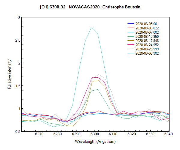

Evolution of the [OI] line :
[OI] line on August 5th, 6th, 7th, 15th, 17th, 24th, 25th and on September 6th 2020
novacas2020_20200906_902_Christophe Boussin_OI.png (36.27 KiB) Viewed 10745 times

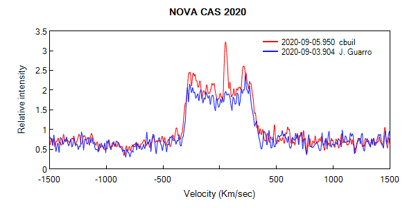

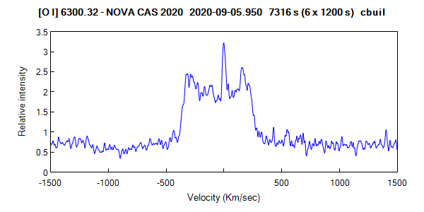

Interesting [OI] profile in Christian's spectrum:
with a narrow component (~30 km/s) at the rest wavelength
while the whole line have a FWHM ~ 570 km/s, slightly displaced to shorter wavelengths by ~ 55 km/s
Comparison with Joan's spectrum:

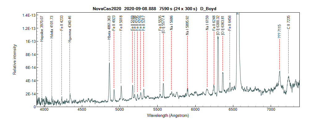

Post by David Boyd »
This spectrum of the nova recorded on 8th Sept with a LISA and C11 shows a strong broad emission line centred on 7115 A which I cannot identify in the list of nova emission lines in Williams AJ 144 (2012). Also, is my identification of the broad C II line at 7235 A correct?

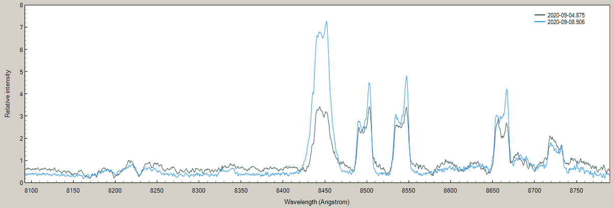

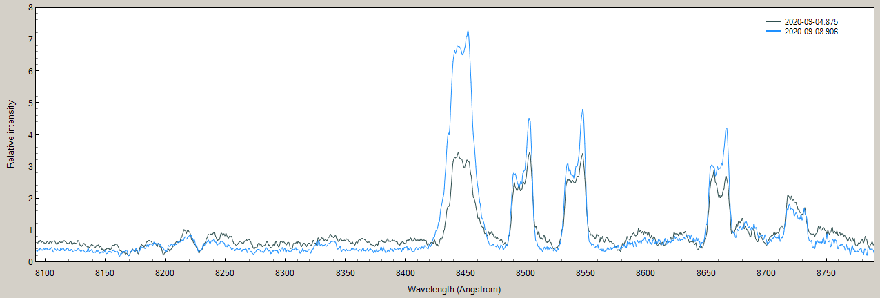

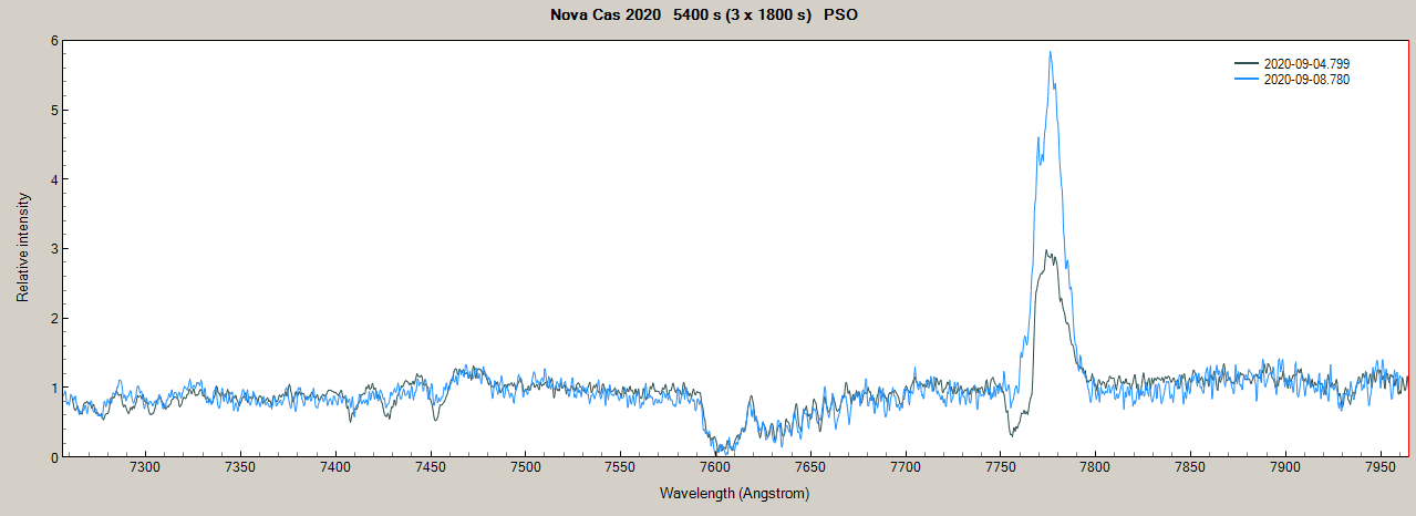

Quick update, for those who can follow O I 7772 or 8446:
O I 7772 has lost its P-Cyg profile (always there from the beginning, at a similar magnitude).
The Ca II IRT region (9 x 1800 sec):
O I 8446 has doubled its height and EW ratio compared to Ca II IRT, and widened.
Having more spectra on the process queue, related to previous 2 comments...
