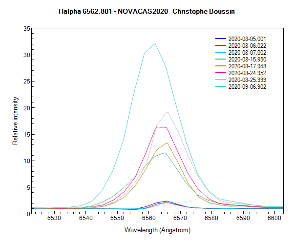

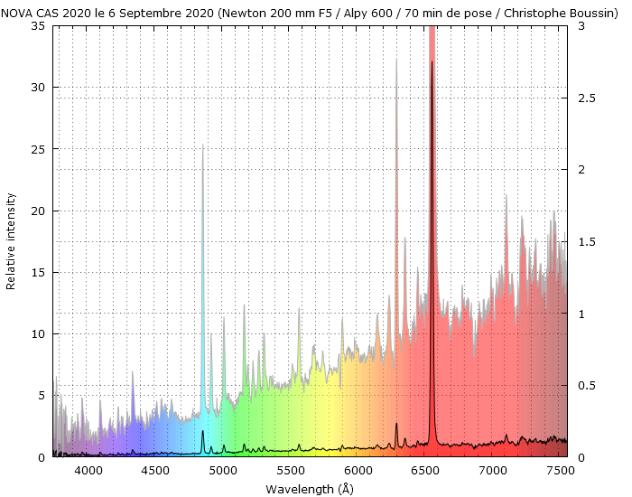

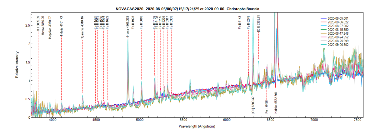

Here is my new update for the nova Cas 2020 with the following spectrum obtained the 6th of September at 21 h 38 TU with my Alpy 600 (resolution of 514, JJ = 2459099.4016) and an acquisition time of 70 min :
Nova Cas 2020 on September 6th, 2020
_novacas2020_20200906_902_Christophe Boussin_3750_7565.png (77.91 KiB) Viewed 10757 times
Nova Cas 2020 on August 5th, 6th, 7th, 15th, 17th, 24th, 25th and on September 6th 2020 (identification of lines from PlotSpectra)
The relative intensities of the Balmer lines continue to increase and more particularly that of the Halpha line. Those of [OI] lines at 6300A and 6364A have clearly increased since August 25. The lines of FeII remain evident.
Evolution of the Halpha line :
Halpha line on August 5th, 6th, 7th, 15th, 17th, 24th, 25th and on September 6th 2020
novacas2020_20200906_902_Christophe Boussin_Halpha.png (32.19 KiB) Viewed 10757 times

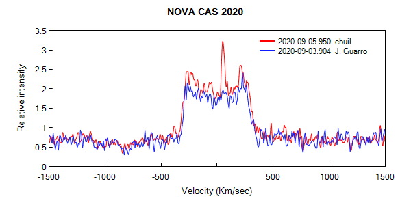

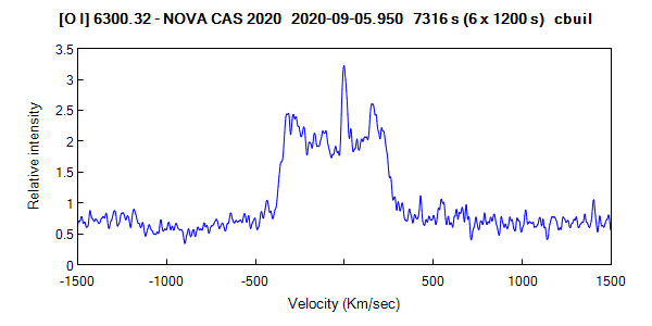

Interesting [OI] profile in Christian's spectrum:
with a narrow component (~30 km/s) at the rest wavelength
while the whole line have a FWHM ~ 570 km/s, slightly displaced to shorter wavelengths by ~ 55 km/s
Comparison with Joan's spectrum:
Let's go on the good work!

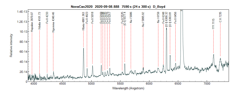

This spectrum of the nova recorded on 8th Sept with a LISA and C11 shows a strong broad emission line centred on 7115 A which I cannot identify in the list of nova emission lines in Williams AJ 144 (2012). Also, is my identification of the broad C II line at 7235 A correct?
