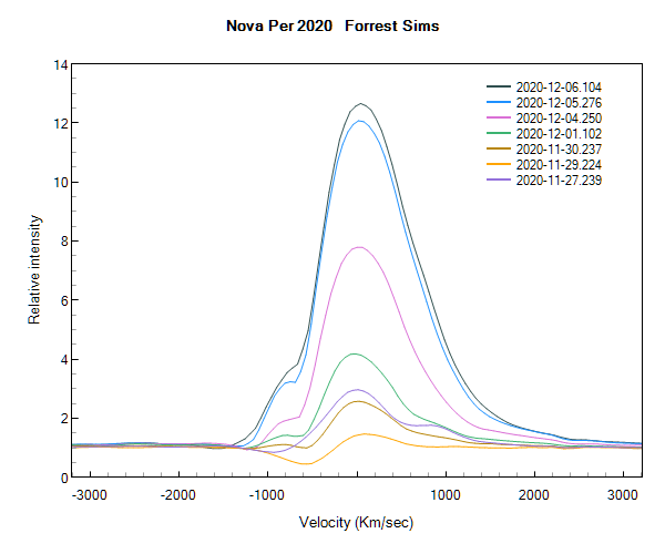

by Forrest Sims

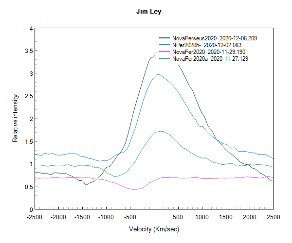

To add to what David's plot shows, here is a plot over the same time period that show the evolution of Halpha in velocity.
novaper2020_20201204_250_Forrest Sims Halpha velocity plot.png (30.42 KiB) Viewed 9201 times

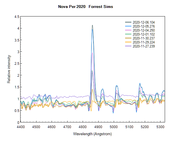

And for the same dataset note the appearance and interesting evolution of the Fe Multiplet (4924, 5018, 5169)Å.

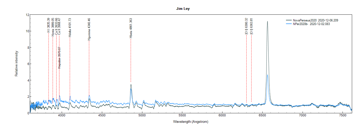

by James Ley

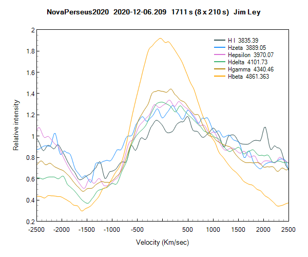

Reassuringly, I seem to be getting the about the same results as people with far more skill than myself.
I think there is some evidence for Ca II K & H emission, consistent with earlier spectra in IR.
I think there is also some suggestion of [O I] at 630.0 nm and 636.4 nm, again consistent with the IR spectra.
When I compare the Balmer lines, it looks to me like the absorption has roughly the same velocity for all lines. The emission lines get wider (hotter environment) with shorter wavelength. Why is the absorption component similar?
novaperseus2020_20201206_209_Jim LeyBalmer.png (38.88 KiB) Viewed 9183 times
I'm trying to understand the different contributions to the emission lines from fluorescence (pumping by Lyman-ß etc. when the iron curtain is lifted) and recombination. The rise of Hα emission seems to me that it might include the former and the rise of Ca II H & K emission to be an indication of the latter. Any ideas?

This might be what we are seeing (here is Hß)
Notice the blue absorption below 1000 km/s before 12/06 and the absorption around 1500 km/s observed on 12/06.
Has the nova reached its optical peak?

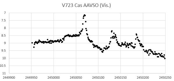

Update of the lightcurve and ARAS spectra.
V723 Cas (Nova Cas 1995) for comparison

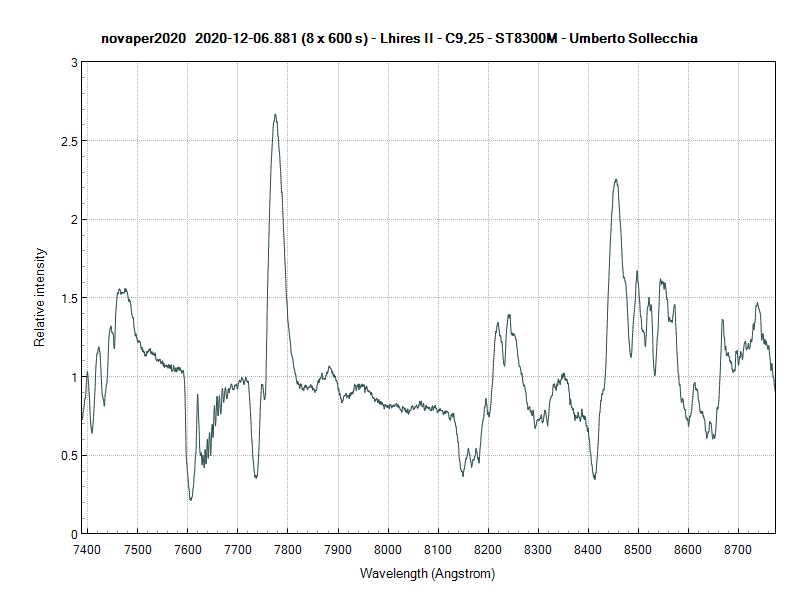

Posted: Mon Dec 07, 2020 7:15 pm
by umberto sollecchia
Bonsoir à tous, placé une nouvelle contribution à l'observation de cette nova.
novaper2020_20201206_881_Umberto Sollecchia.png (43.02 KiB) Viewed 9128 times

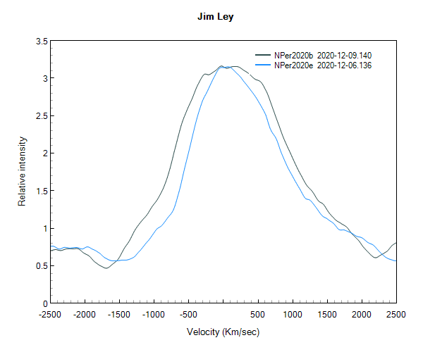

Posted: Wed Dec 09, 2020 7:00 am
by James Ley
Pas beaucoup de changement mais ça coule plus vite.
nper2020b_20201209_140_Jim Leybeta.png (18.77 KiB) Viewed 9059 times

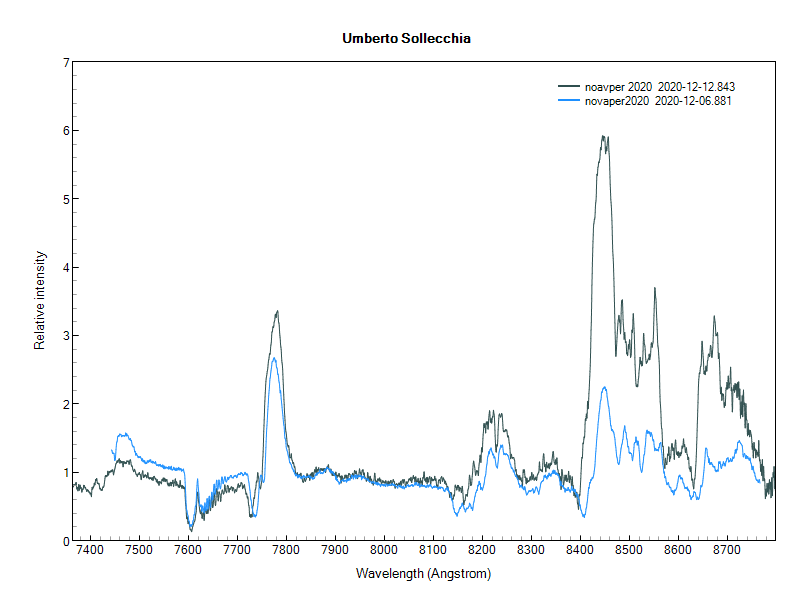

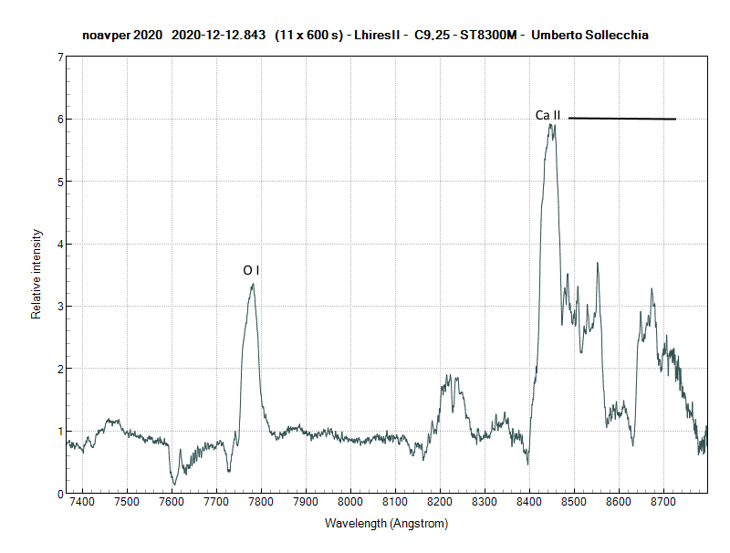

Bonsoir à tous, voici le profil d'observation du 12-12-2020. Cette fois, moi aussi, comme Paolo Berardi, j'ai utilisé un filtre rouge pour éliminer la pollution de second ordre.
J'attache une comparaison entre le profil sans filtre et celui avec filtre où il est montré que l'ordre 2 dans l'IR pollue le spectre d'ordre 1.
Umberto.
noavper2020_20201212_843_Umberto Sollecchia.png (23.71 KiB) Viewed 8898 times
Comparison
noavper2020_20201212_843_ Comparazione _U. Sollecchia.png (47.99 KiB) Viewed 8898 times
