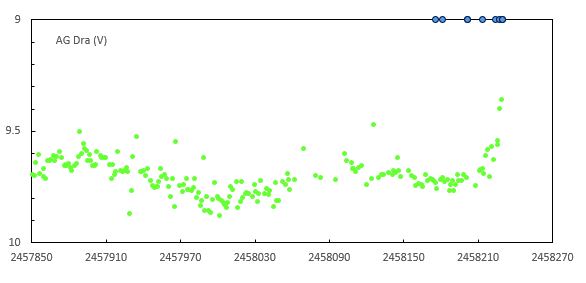

Posted: Sun Apr 22, 2018 8:53 am
AAVSO lightcurve and ARAS spectra (2018)
A daily spectroscopic monitoring is expected
