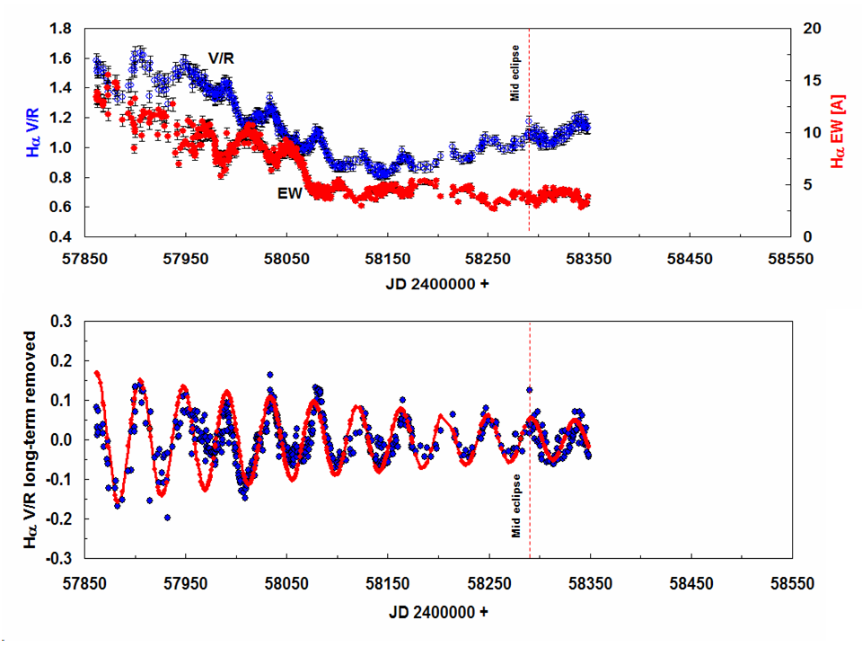

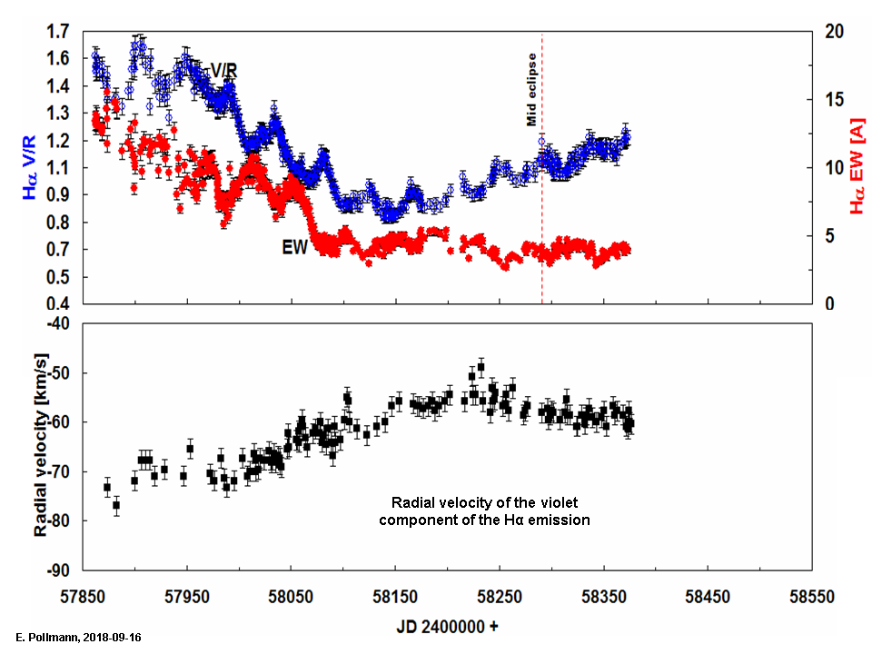

Dear colleagues,
the investigation presented here is the measurement of the radial velocity (RV) of the violet component of the Halpha emission.
For this purpose only spectra are used, which have been taken with LHIRES III spectrographs by five different ARAS observer. With these spectrographs the spectral resolution is high enough to measure the RV precisely.
The spectra are re-calibrated with lines of the M star (FeI = 6546.245; TiI = 6556.066; CaI = 6572.781; FeI = 6593.878). These RV measurements relative to the RV of the M star have been done with VSpec, by wavelength determination of the peak maximum of the violet component of the Halpha emission. The error of wavelength calibration in that way is approx. (+/-) 1km/s, mostly less.
radial velocity.png (158.11 KiB) Viewed 44184 times
A comparison of the RV with the V/R curve shows the obvious antisynchronous behavior of both. Unfortunately the density of the 135 spectra for the determination of the radial velocity observation is clearly lower than for V/R, so it is hardly possible to find there the 43 day period.
But the fact of the antisynchronous behavior of the RV of the blue component to V/R, boost the thesis that the observed 43 day V/R period is caused by a precession movement (RV) of the disk- or shell-like emission source around the B star.

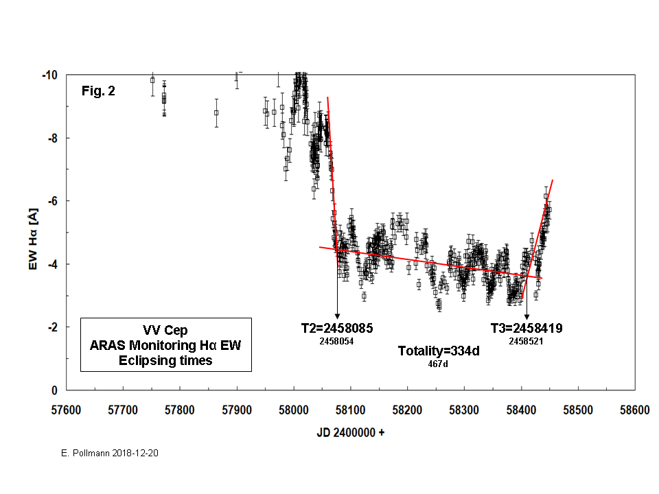

the evaluation of the ARAS Halpha EW monitoring has led to the following times of the eclipsing phases:
As Fig. 1 shows, it is hardly possible to define a reliable time for the beginning of the eclipse (phase T1). The reason is the overlayed periodic variation with a period of 43.5 days. The B mag light curve of the BAV defines JD 2457953 (predicted JD 2457970). See:
https://www.bav-astro.eu/index.php/vera ... p-kampagne
Fig. 2 enables the determination of Phase T2 & T3:
Phase T2: can be devined at JD 2458085 (predicted JD 2458054).
Phase T3: can be devined at JD2458419 (predicted JD 2458521).
Totality phase = 334d (predicted 467d)
Fig. 2.png (86.24 KiB) Viewed 43622 times
This preliminary data suggest the assumption that the size of the disk-like emission source around the B star has reduced since the last eclipse in 1998. A "small" (or smaller) disk is in harmony with the 43.5 d period of the V emission (already published here). Also the smaller depth of the EW level during the totality (only -4.2 A in average) fits to this fact.

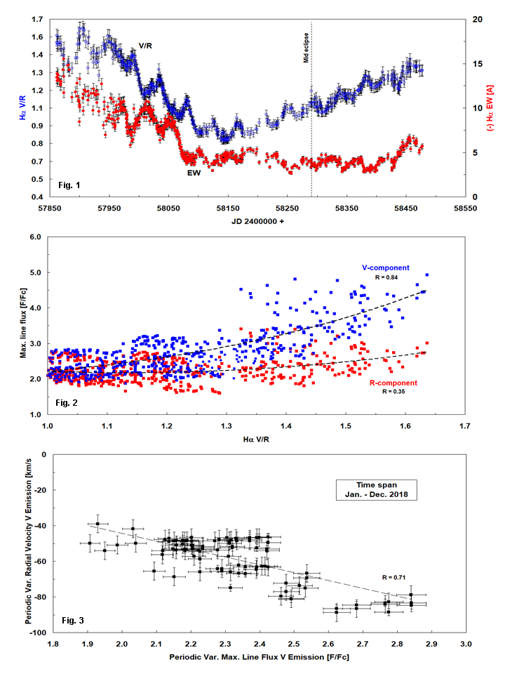

Dear colleagues,
the Halpha V/R time behavior became to a main observation part of our campaign. This time behavior with its surprising periodic character is shown in Fig. 1 (blue curve) and leads to the question of the causes of that phenomenon.
The V emission arises in the shock front area in front of the B star which moves with supersonic velocity through the stellar wind of the M star. The R emission arises in the outflowing zone behind the B star.
The meanwhile comprehensive data base enables to analyze the separate, quantitative contributions of the V and the R emission component to the ratio V/R. This is shown in Fig. 2. We can see that V correlates with the ratio V/R to 84%, R correlates only with 34%.
Therefore we can say that essentially the V emission is responsible for the V/R periodicity in Fig.1.
This periodicity leads to the question of the influence of the radial velocity (RV) of the V emission component. In Figure 3 is drawn the RV of the V peak against its emission maximum, and it shows, RV is correlated with the V line flux maximum to approx. 70%.
This result suggests that the V-emission area in front of the B star periodically moves back and forth in the observers line of sight, and there is reason to believe that there is a librational motion of the disc structure around the B star.
periodic RV of the V emission.png (181.15 KiB) Viewed 43554 times
Comments are welcome!
