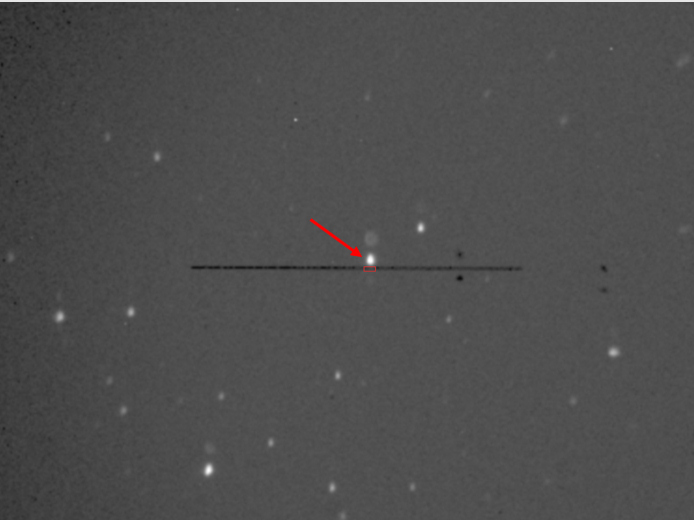

Here is a spectrum of TYC 1371-69-1 from last night using an Alpy 600, Celestron 8 SCT, 1200s x 6. I can't see any Balmer lines in emission.
This is the field of view.
TYC 1371-69-1.jpg (88.54 KiB) Viewed 20193 times

@ John. Excellent, good practice to provide the field!

I still plan to use this forum thread for a more detailed discussion of the targets (needs, results) and at the same time, it would be great if you all would continue to post your results here in the same way as up to now. And yes, I agree with François, that it is a very good practice to take a screenshot of your guider field, especially in the dense field (but not only) to ensure, that we can always verify that the correct star was imaged. This is very important for example in discussion with the referee of the paper if there is some interesting spectroscopic behavior seen.
