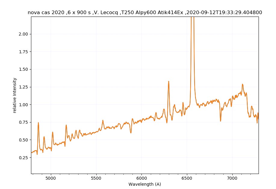

hello,
new spectrum of nova Cas 2020; recorder this night (12-13/09):
clear skies,
vincent
clear skies,
vincent
- Capture d’écran 2020-09-13 122428.jpg (60.92 KiB) Viewed 10124 times

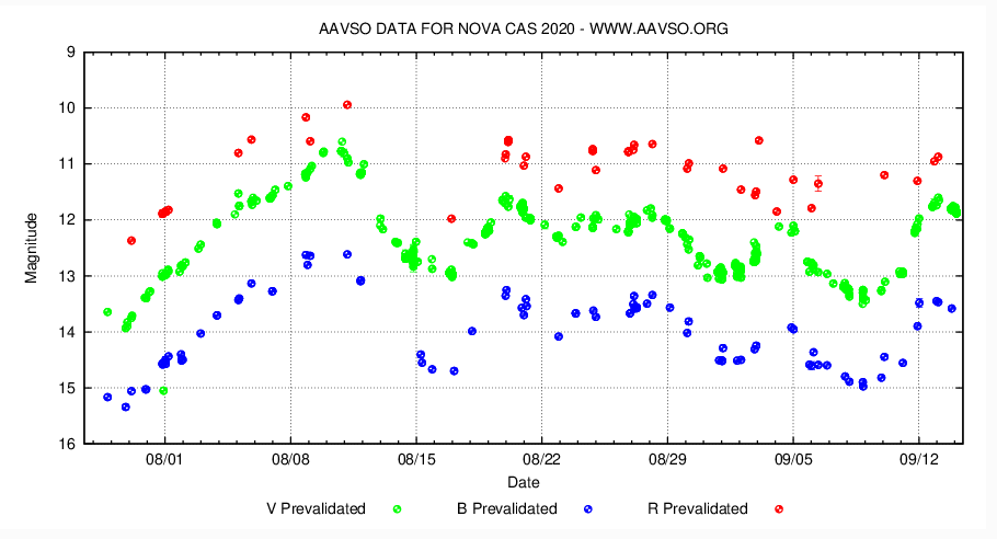

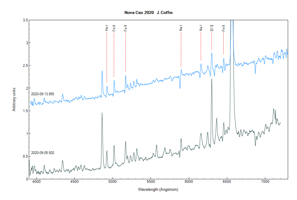

P Cygni profiles changing
It’s interesting to try and relate the spectra to the light curves. This is a fascinating object.
Here is the latest AAVSO light curve
Last night’s spectrum compared with the 5th September
Can anyone explain why there isn’t an absorption line associated with the H alpha emission line?
- Posts: 1562
Yes, during the re-brightening, the spectrum recovers -more or less- the previous aspect, with notably P Cygni profiles in numerous lines (Balmer, Fe II (42) ...)It’s interesting to try and relate the spectra to the light curves.
The spectral changes, with practically no exception, follow what may be
called “Stratton’s rule.” This was stated by its originator as follows: “The spectrum
varies with the magnitude. As a rough generalization it may be said that a maximum
corresponds to a spectrum which is normal at an earlier stage of the star’s history”
(Stratton 1920, p. 65). in McLaughlin (1955): The Spectrum of the Slow Nova V 356 Aquilae (1936)
In fact, there's an absorption in H alpha, with about the same (at a first order) than in other Balmer lines.why there isn’t an absorption line associated with the H alpha emission line?
But the intensity of the emission in H alpha is much greater (see "Balmer decrement"), thus the absorption is "diluted" in the emission and will produce only a change of slope in the blue part of the emission line.
This is the reason why H beta (for example) produces -generally- much more information about the physics of the object than H alpha.
i.e. for observers using a Lhires III with gratings 600 to 2400 l/mm, the H beta range (for example) is much more interesting than H alpha range
Have a look on Peter's monitoring of the nova in the database.

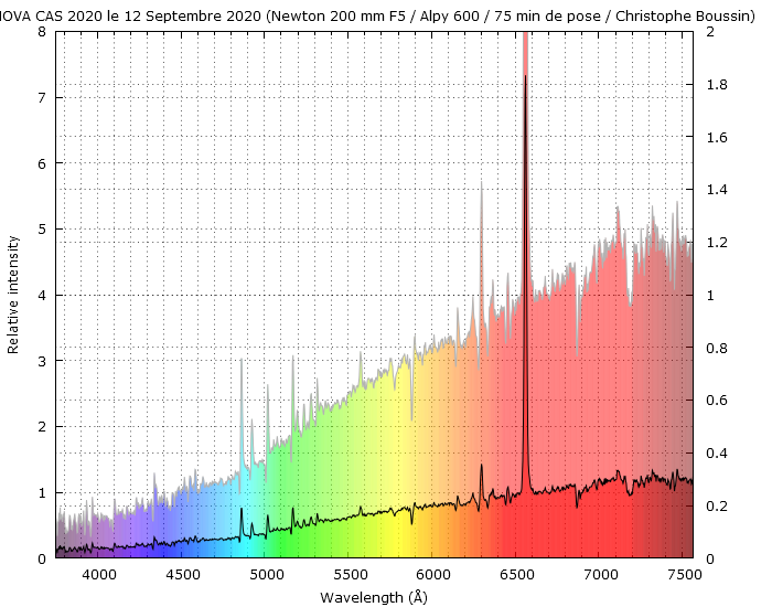

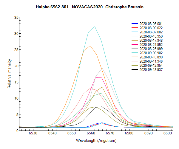

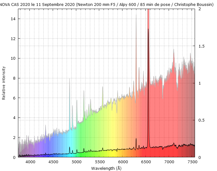

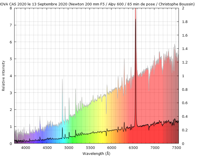

- Posts: 173

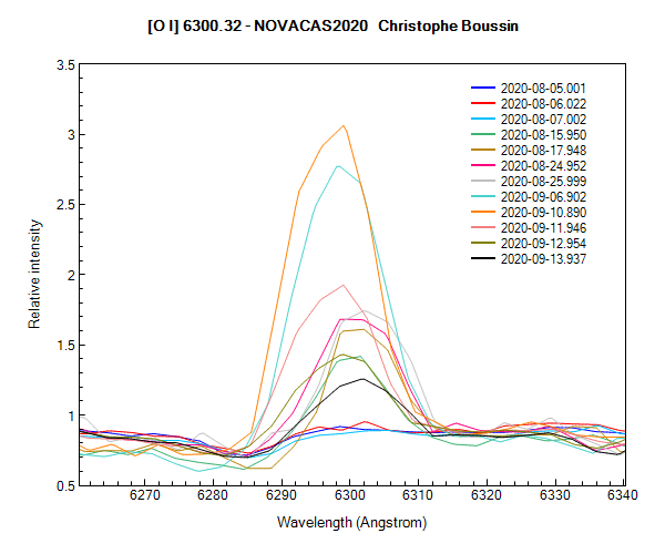

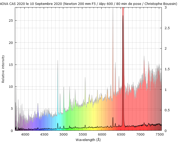

Here is my new update for the nova Cas 2020 with the following spectra obtained with my alpy 600 :
the 10th of September at 21 h 22 TU (resolution of 509, JJ = 2459103.3903) and an acquisition time of 80 min : the 11th of September at 22 h 42 TU (resolution of 506, JJ = 2459104.4459) and an acquisition time of 85 min : the 12th of September at 22 h 54 TU (resolution of 505, JJ = 2459105.4542) and an acquisition time of 75 min : the 13th of September at 22 h 29 TU (resolution of 505, JJ = 2459106.4372) and an acquisition time of 85 min : The relative intensities of the Balmer lines are now decreasing since September 6. Those of [OI] lines at 6300A and 6364A have also been decreasing, since September 10, as well as the FeII lines but still clearly visible.
Evolution of the Halpha line : Evolution of the [OI] line : Clear skies !

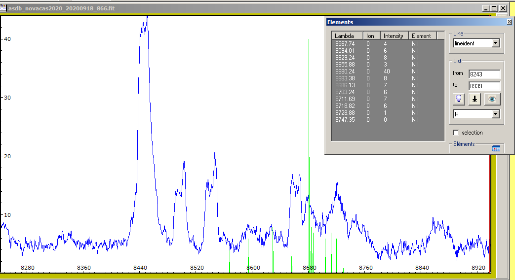

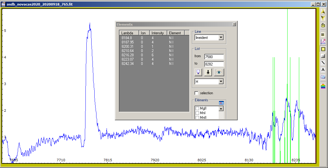

- Posts: 420
Comparing my result from yesterday to previous (2020.09.12 and 18), in the IR it looks like the N I emissions got stronger - relatively to all other lines:
It is causing the rightmost Ca II 8662 blending with the neighbour N I emission.

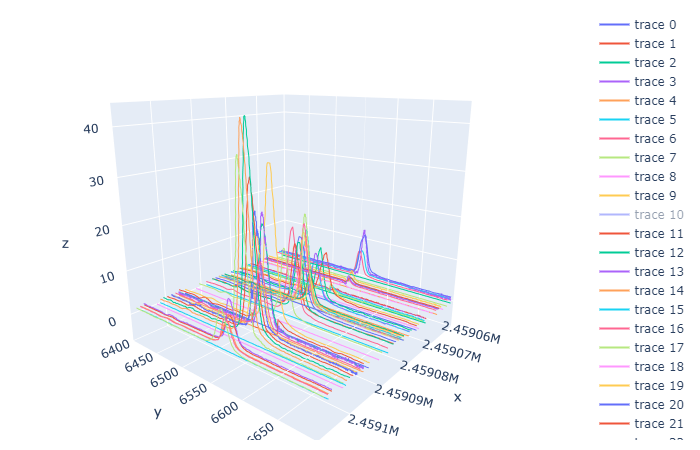

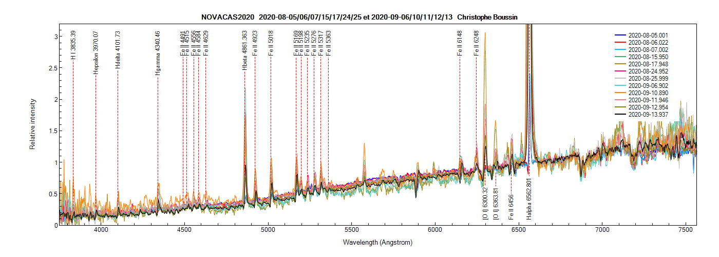

Vincent Lecocq
- Posts: 40
- Joined: Fri Mar 04, 2016 3:52 pm
hi all,
i wanted to plot all the spectra of nova cas on the same 3d plot as a time serie.
at a first glance, i obtained that (julian day as x axis, wavelength as y, and relative intensity as z) ...
i'd like to know if there was a need to make any normalization before this operation ? are the spectrum of the database comparable between then as it or is there a need to make an operation before thaht ?
thank you,
vincent
thank you,
vincent
- newplot.png (125.89 KiB) Viewed 9866 times
- Posts: 1276
Vincent,
Si tu utilises des spectres en provenance de divers spectro ayant des résolutions différentes, tu n'auras pas la même intensité des raies en emissions : plus la résolution est importante, plus la raie sera profonde.
A mon avis il faudrait que tu "dégrades" les spectres à la résolution du spectre le moins bien résolu pour pouvoir comparer une évolution...
Vincent Lecocq
- Posts: 40
ok, merci Olivier, je vais essayer !
