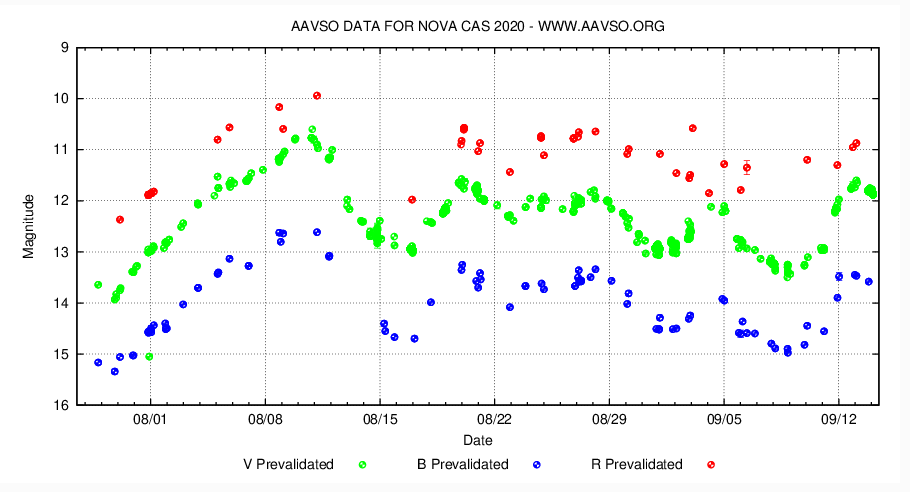

Posted: Mon Sep 14, 2020 12:42 pm
by John Coffin

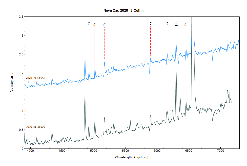

It’s interesting to try and relate the spectra to the light curves. This is a fascinating object.
Here is the latest AAVSO light curve
aavso light curve nova cas 2020.png (46.41 KiB) Viewed 10084 times
Last night’s spectrum compared with the 5th September
nova cas 5 sept v 13 sept.png (58.6 KiB) Viewed 10084 times
Can anyone explain why there isn’t an absorption line associated with the H alpha emission line?
In fact, there's an absorption in H alpha, with about the same (at a first order) than in other Balmer lines.
But the intensity of the emission in H alpha is much greater (see "Balmer decrement"), thus the absorption is "diluted" in the emission and will produce only a change of slope in the blue part of the emission line.
This is the reason why H beta (for example) produces -generally- much more information about the physics of the object than H alpha.
i.e. for observers using a Lhires III with gratings 600 to 2400 l/mm, the H beta range (for example) is much more interesting than H alpha range

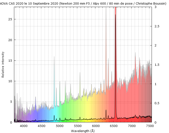

Posted: Thu Sep 17, 2020 4:14 pm
by Christophe Boussin

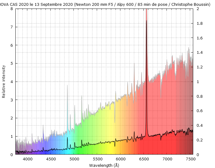

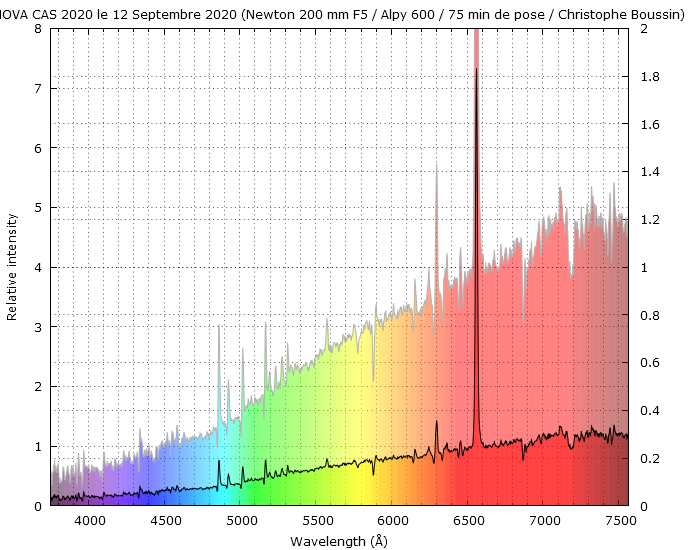

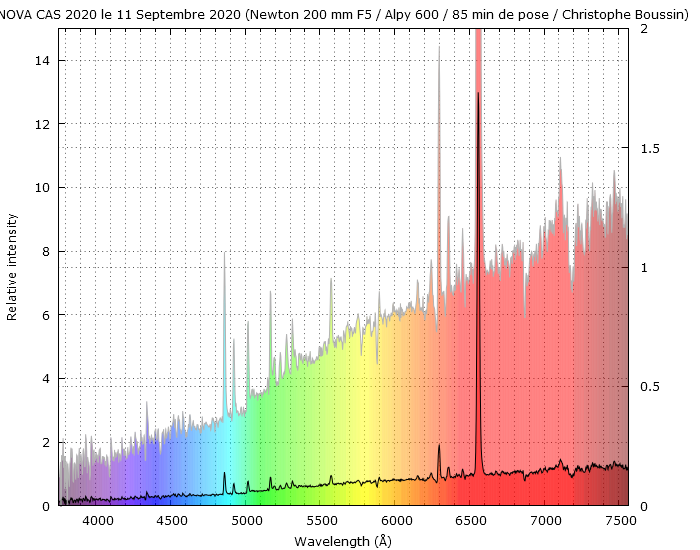

Here is my new update for the nova Cas 2020 with the following spectra obtained with my alpy 600 :
the 10th of September at 21 h 22 TU (resolution of 509, JJ = 2459103.3903) and an acquisition time of 80 min :
Nova Cas 2020 on September 10th, 2020
_novacas2020_20200910_890_Christophe Boussin_3750_7565.png (79.49 KiB) Viewed 9967 times
the 11th of September at 22 h 42 TU (resolution of 506, JJ = 2459104.4459) and an acquisition time of 85 min :
Nova Cas 2020 on September 11th, 2020
_novacas2020_20200911_946_Christophe Boussin_3750_7565.png (77.77 KiB) Viewed 9967 times
the 12th of September at 22 h 54 TU (resolution of 505, JJ = 2459105.4542) and an acquisition time of 75 min :
Nova Cas 2020 on September 12th, 2020
_novacas2020_20200912_954_Christophe Boussin_3750_7565.png (78.21 KiB) Viewed 9967 times
the 13th of September at 22 h 29 TU (resolution of 505, JJ = 2459106.4372) and an acquisition time of 85 min :
Nova Cas 2020 on September 13th, 2020
_novacas2020_20200913_937_Christophe Boussin_3750_7565.png (81.19 KiB) Viewed 9967 times

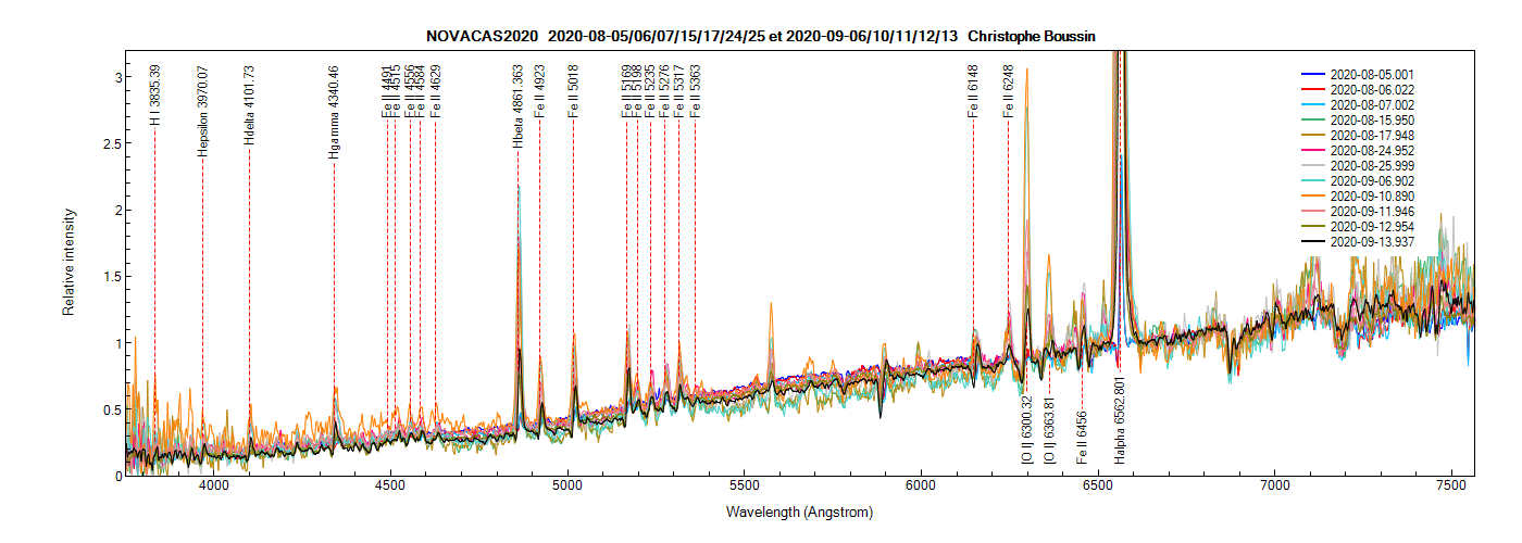

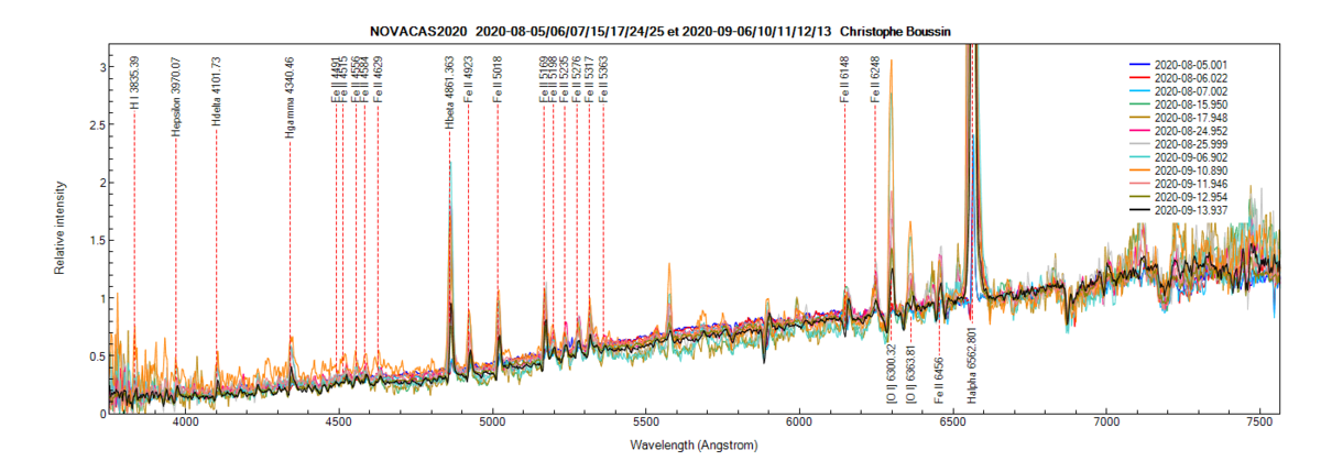

Nova Cas 2020 on August 5th, 6th, 7th, 15th, 17th, 24th, 25th and on September 6th, 10th, 11th, 12th and 13th 2020 (identification of lines from PlotSpectra)
The relative intensities of the Balmer lines are now decreasing since September 6. Those of [OI] lines at 6300A and 6364A have also been decreasing, since September 10, as well as the FeII lines but still clearly visible.

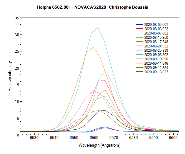

Evolution of the Halpha line :
Halpha line on August 5th, 6th, 7th, 15th, 17th, 24th, 25th and on September 6th, 10th, 11th, 12th and 13th 2020
novacas2020_20200913_937_Christophe Boussin_Halpha.png (42.98 KiB) Viewed 9967 times

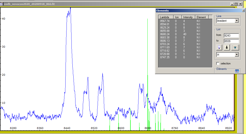

Posted: Sat Sep 19, 2020 8:42 pm
by Peter Somogyi

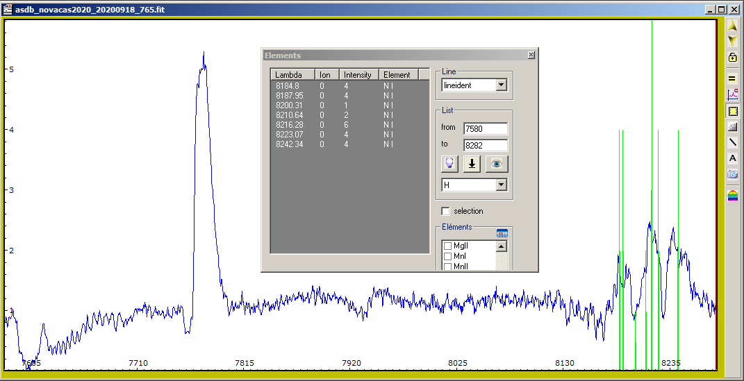

Comparing my result from yesterday to previous (2020.09.12 and 18), in the IR it looks like the N I emissions got stronger - relatively to all other lines:
It is causing the rightmost Ca II 8662 blending with the neighbour N I emission.
