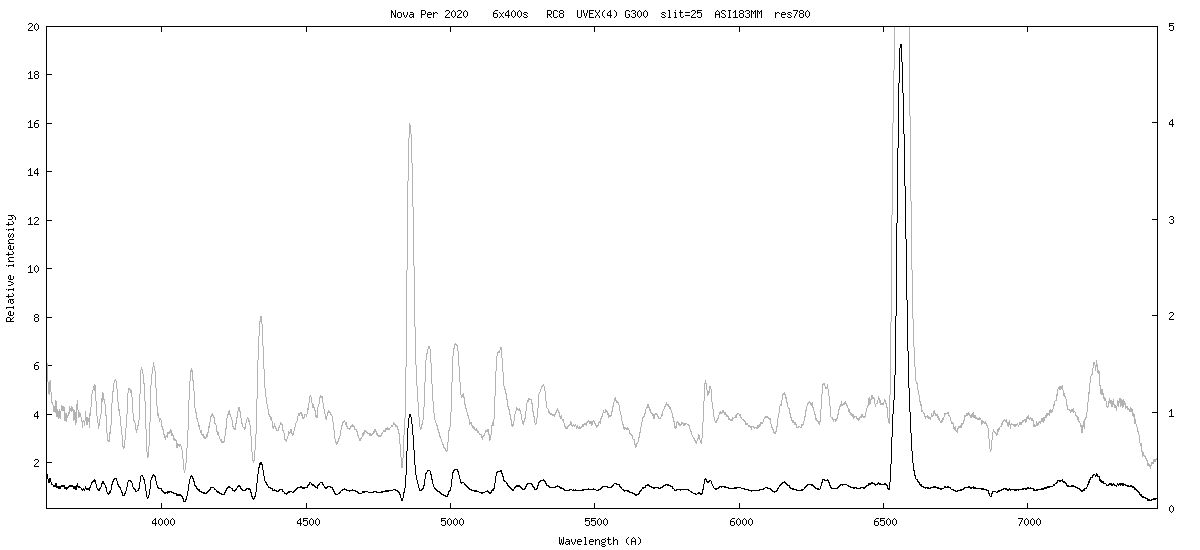

Hi All,
Hopefully Meteoblue was right tonight, showing only a two hours clear sky over Pyrénées Mountains. The time to take a spectrum of this Nova, without filter :
Intensity of the Halpha remain strong with an intensity at 15.50.
Fred
Fred

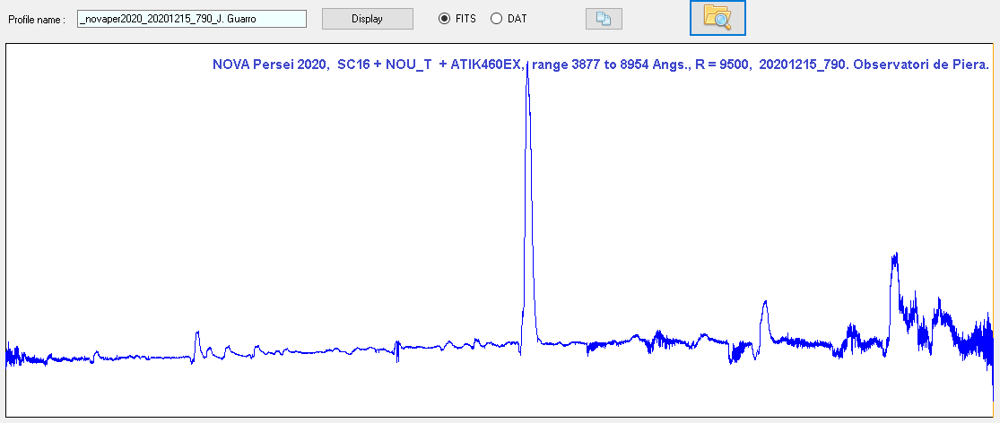

- Posts: 731
Hello ,
After days of bad weather, I have observed the Nova last night, that is the result.
Greetings, J. Guarro.

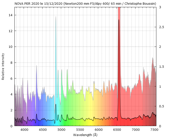

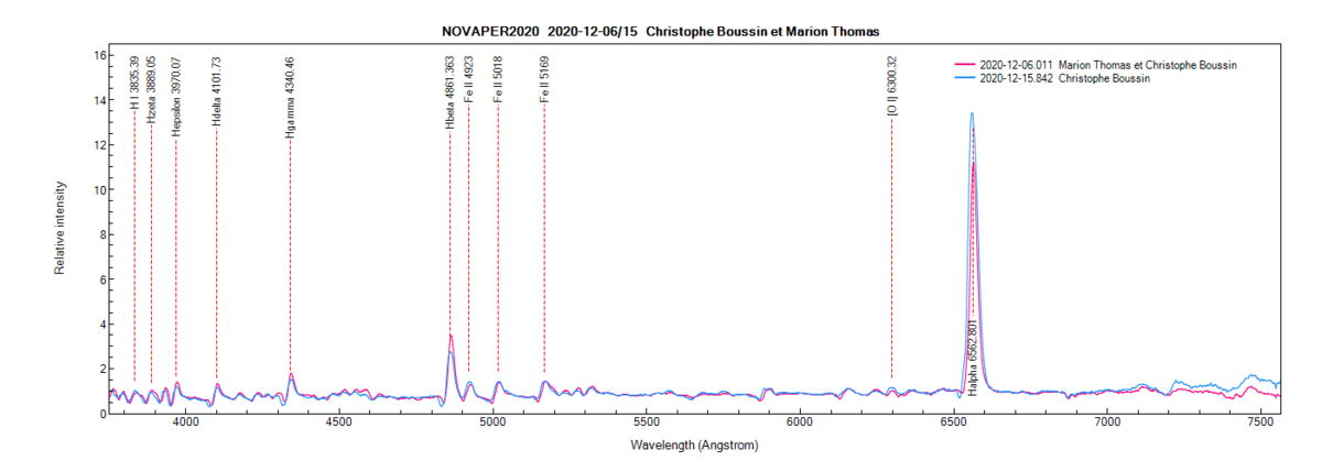

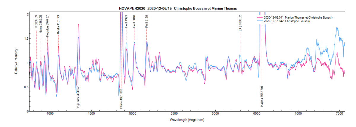

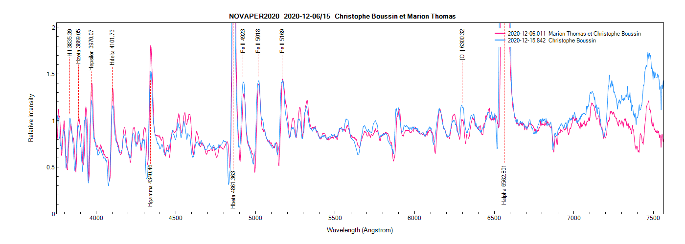

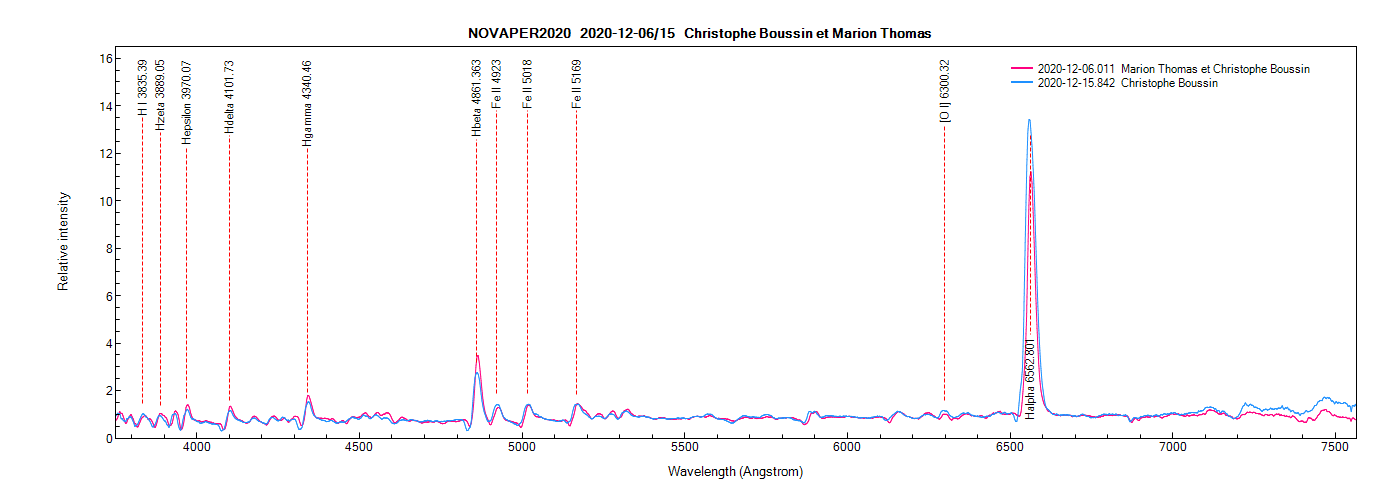

- Posts: 173
Finally a clear sky for several days...The following spectrum of the Nova Per 2020 was obtained last night the 15th of December at 20 h 12 TU with my Alpy 600 (resolution of 533, JJ = 2459199.3419) and an acquisition time of 65 min :
The relative intensity of the [OI] line at 6300A seems to increase and the red part of the spectrum seems also to evolve.
Clear skies,
Clear skies,

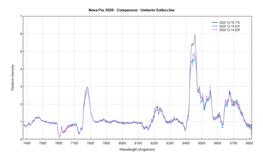

- Posts: 247
Placez une comparaison du jour 16-12-2020 avec les jours 14 et 15 12-2020. La variation de l'OI et du CaII est significative. Les profils ont été obtenus en interposant un filtre rouge.
Umberto Sollecchia
Umberto Sollecchia

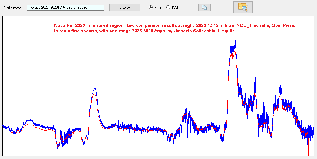

- Posts: 731
You can see two spectra comparison in the near infrared.
Cheers, J. Guarro.
Cheers, J. Guarro.
