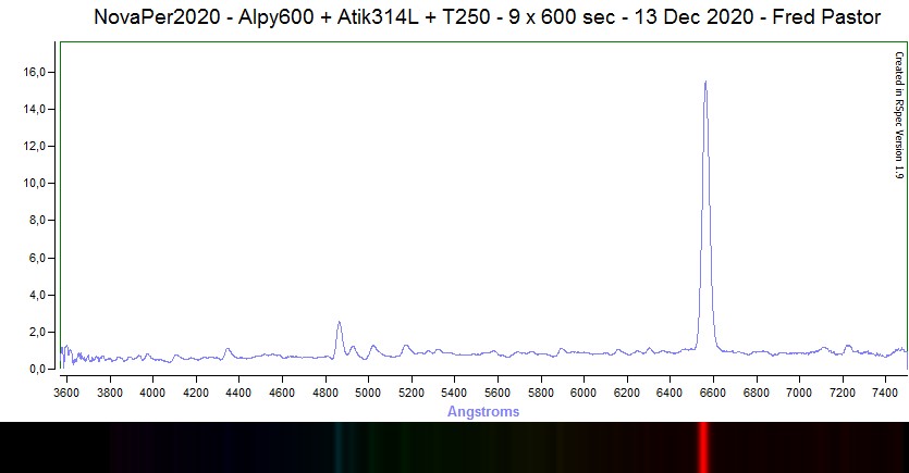

Posted: Sun Dec 13, 2020 9:18 pm
by Frederic Pastor
Hi All,
Hopefully Meteoblue was right tonight, showing only a two hours clear sky over Pyrénées Mountains. The time to take a spectrum of this Nova, without filter :
Nova Per2020 Rspec 13 dec 2020 Fred Pastor.jpg (47.66 KiB) Viewed 9353 times
Intensity of the Halpha remain strong with an intensity at 15.50.
Fred

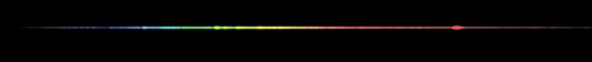

Posted: Mon Dec 14, 2020 8:35 am
by Dubreuil Pierre
Bonjour à tous

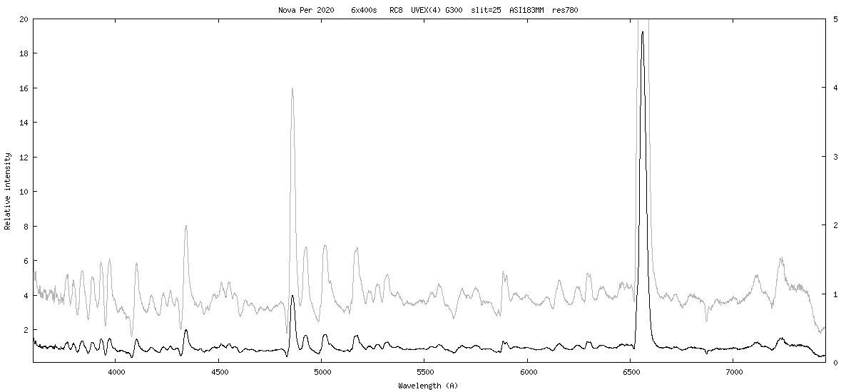

la nuit dernière fut une premiere lumiere pour UVEX(4).
A cette occasion la Nova Per 2020 était un bon test.
last night was a first light for UVEX (4).
On this occasion the Nova Per 2020 was a good test.
Nova Per 2020  UVEX(4)
_novaper2020_20201213_771_Pierre Dubreuil.png (11.49 KiB) Viewed 9341 times
spectre couleur
spectre couleur
Cordialement

Félicitation à tous pour tous les spectres !
Pierre, le spectre est fin sur toute la longueur, c'est une bonne nouvelle pour l'UVEX 4. On attend la suite !
Michel Verlinden

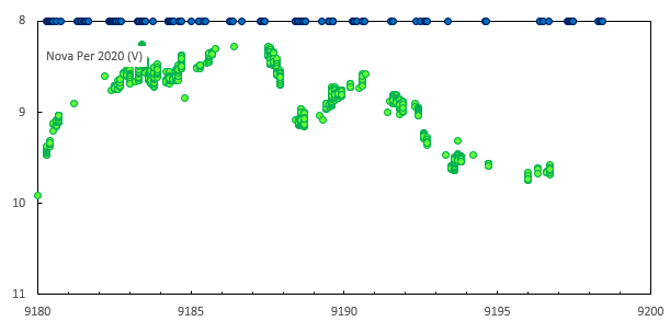

Posted: Tue Dec 15, 2020 9:53 am
Update of the light curve and monitoring
We have now 130 spectra in the database.
Bonne continuation!

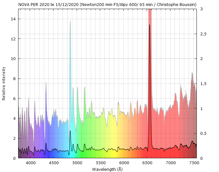

Posted: Wed Dec 16, 2020 7:40 pm
by Christophe Boussin

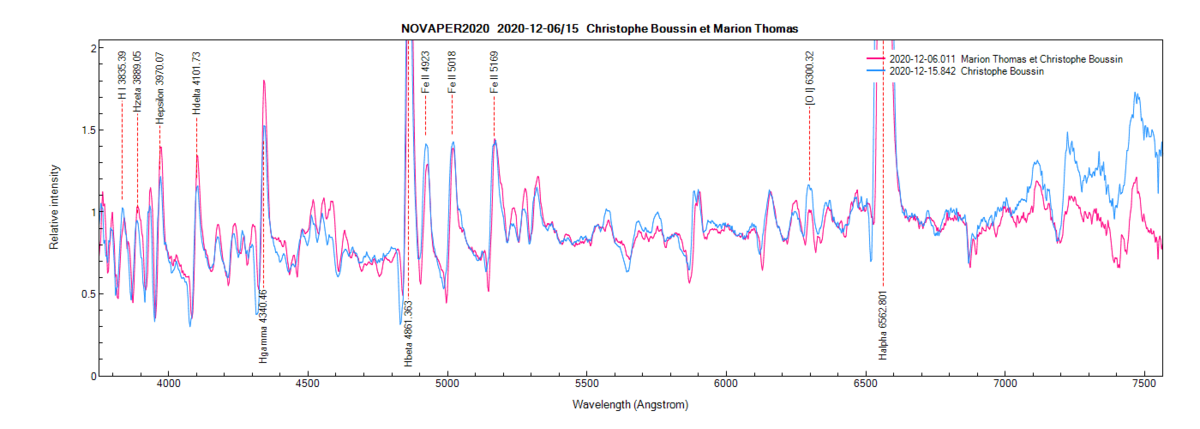

Finally a clear sky for several days...The following spectrum of the Nova Per 2020 was obtained last night the 15th of December at 20 h 12 TU with my Alpy 600 (resolution of 533, JJ = 2459199.3419) and an acquisition time of 65 min :
Nova Per 2020 on December 15th, 2020
_novaper2020_20201215_842_Christophe Boussin_3700_7565.png (81.4 KiB) Viewed 9069 times
Nova Per 2020 on December 6th and 15th, 2020 (zoom).
The relative intensity of the [OI] line at 6300A seems to increase and the red part of the spectrum seems also to evolve.
Clear skies,

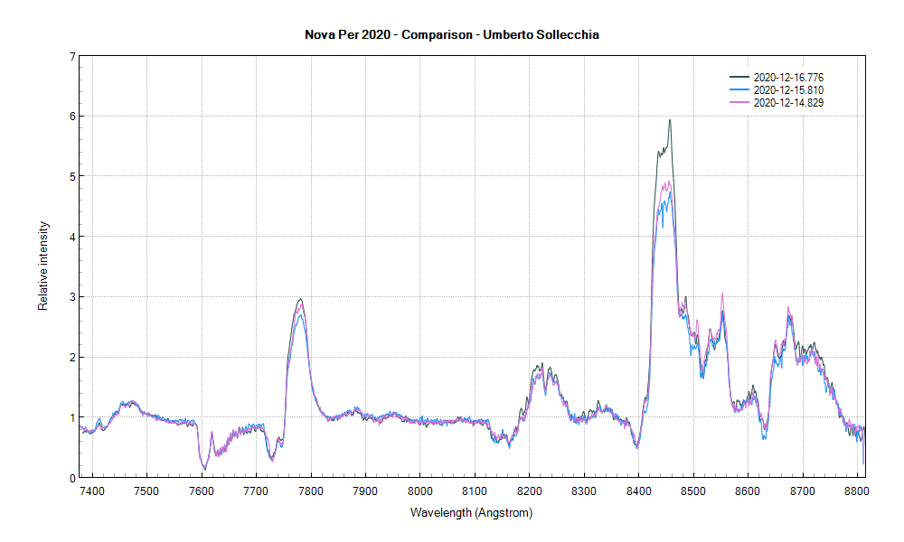

Posted: Wed Dec 16, 2020 11:33 pm
by umberto sollecchia
Placez une comparaison du jour 16-12-2020 avec les jours 14 et 15 12-2020. La variation de l'OI et du CaII est significative. Les profils ont été obtenus en interposant un filtre rouge.
Umberto Sollecchia
