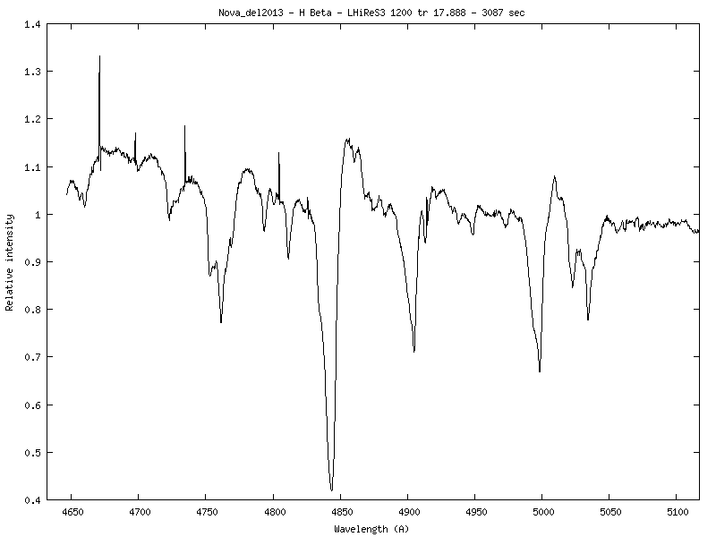

Et je confirme qu'en H Beta ça a aussi disparu avec une croissance impressionnante de l'intensité.
J'ai enfin traité mes images des 3 dernières nuits et ç'est réellement impressionnant de suivre cette bête-là.
La semaine prochaine s'annonce belle ; j'ai des jours de libres... profitons-en !

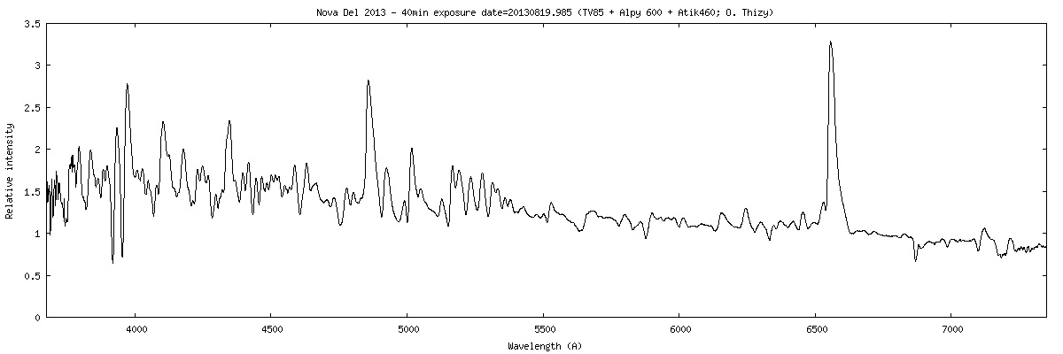

Posted: Tue Aug 20, 2013 1:32 am
by Olivier Thizy
Huge change in the spectrum tonight (again!). Halpha is getting very strong and is the main feature of the spectrum (this is where I now check my raw spectrum doesn't saturate). I also had to reduce the exposure time from 180sec to 120sec so I am guessing the nova is brigther now than ever - is it confirmed by phometry?
Anyway, here is my first spectrum of the night which began with a cloudy sky but no a clear and nice starry sky with a bright Moon:

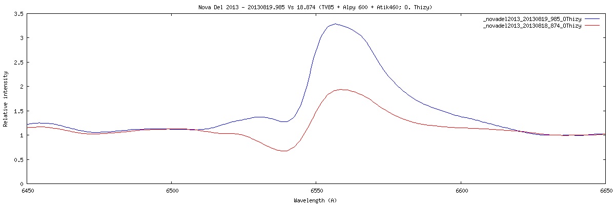

A comparison with last night spectrum on Halpha show clearly the change:

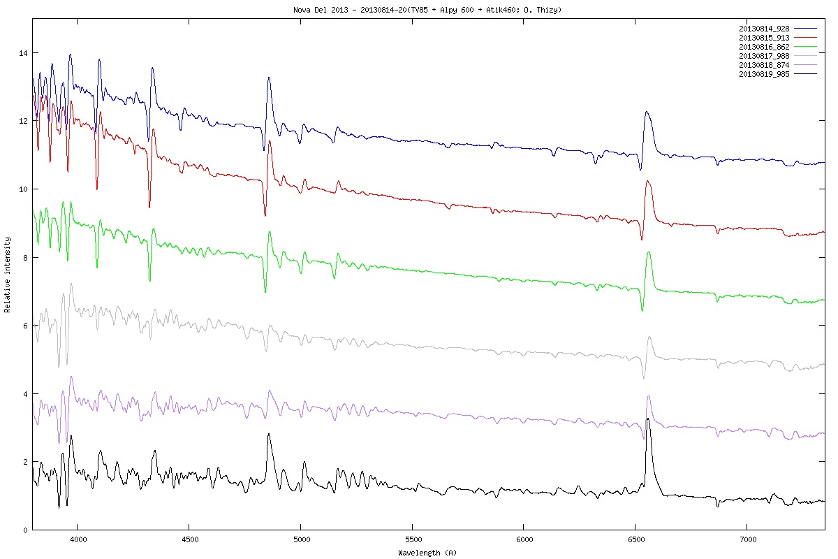

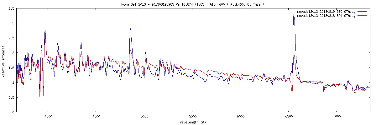

A comparison of the overall spectra:
Last but not least, here is a compilation of 6 nights on the nova, showing the change night after night:

Posted: Tue Aug 20, 2013 1:56 am
by Olivier Thizy

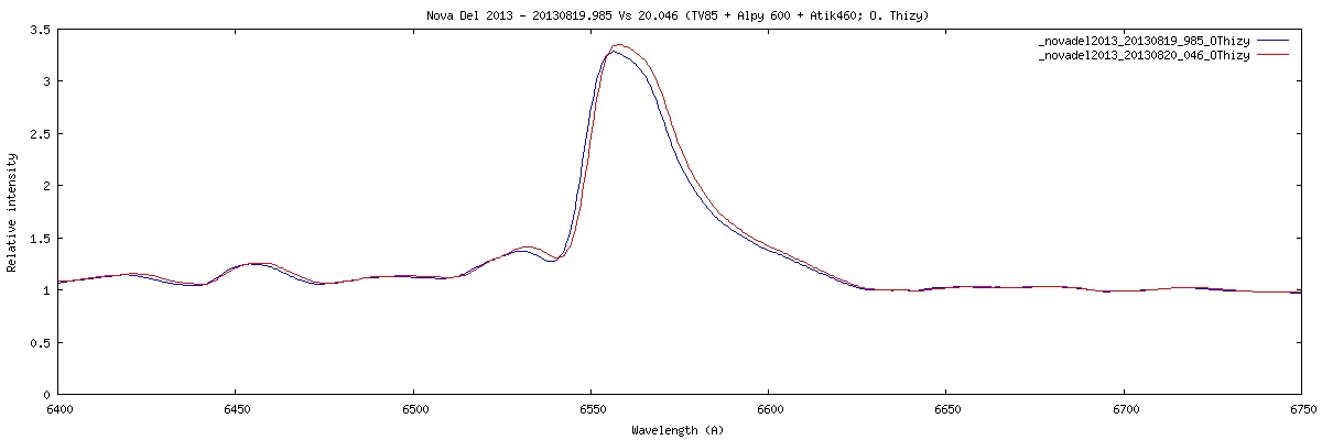

It's crazy... change is well visible at R=600 in one hour time:
Continuous spectroscopy is really required to monitor this!...

Posted: Tue Aug 20, 2013 11:01 am
by Olivier Thizy

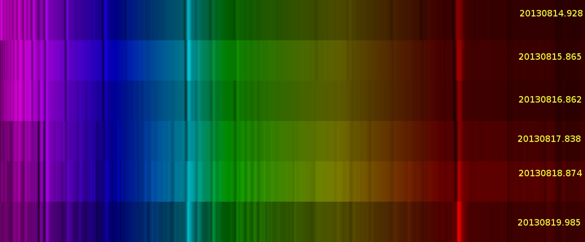

here is a graph with six spectra (one per night) showing, in low resolution (Alpy 600: R=600 resolving power), the evolution during this short time frame:
Olivier
