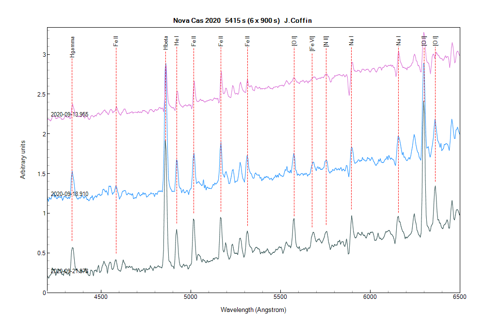

What causes the P Cygni profile in sodium?
Posted: Mon Sep 28, 2020 10:09 am
by John Coffin
What is the cause of the P Cygni profile in what appear to be sodium lines? I think I can identify these on recent spectra. Is the sodium interstellar? If so, is it photoexcitation by UV from the white dwarf that causes the emission lines or some other mechanism?
nova cas stacked 4200 to 6500.png (80.7 KiB) Viewed 12114 times
Posted: Sun Oct 04, 2020 4:24 pm
A quick look under a full moon with the ALPY200 (R~130)
The contamination from the second order is minimal because of the low flux in the blue so I included the IR end in the same spectrum

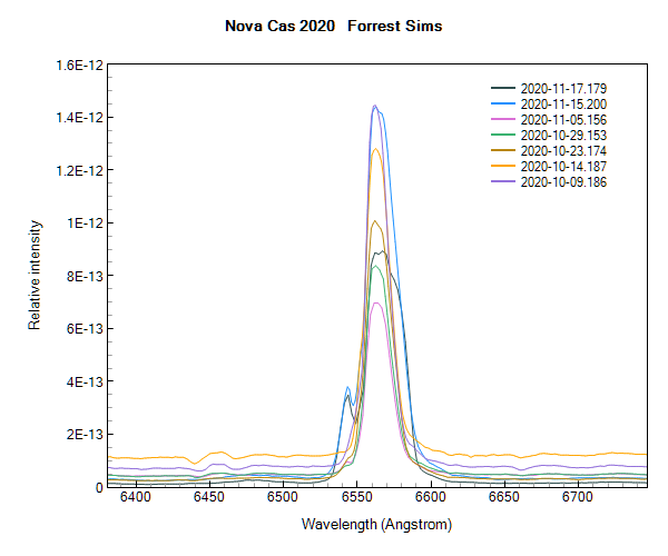

Nova Cas 2020 continues to change rapidly and is well worth following. Here are recent flux calibrated spectra taken just two days a part. Nova Cas 2020 has dimmed by nearly 3 magnitudes in the V band in the past week.
Here is a plot of changes in Halpha over the past 5 weeks.

Here is a plot that shows changes in [OI] 6300Å and [OI] 6364Å over the same time period.
novacas2020_Series [OI] 6300.png (48.77 KiB) Viewed 11749 times

Nice results Woody !!!
Posted: Thu Nov 19, 2020 10:11 pm
by Peter Somogyi
Good catch of this event, Woody! Looking at your flux graph, my result suggests a tendency H-alpha is shrinking day by day very quickly:

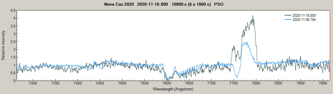

I've used wide slit (1 x 600 sec) for flux calibration.
At OI 7772 region, I've got only very low signal (SNR~10, no flux calibration):
Note that the N I 7423,7442,7468 features gone below noise or absent.
