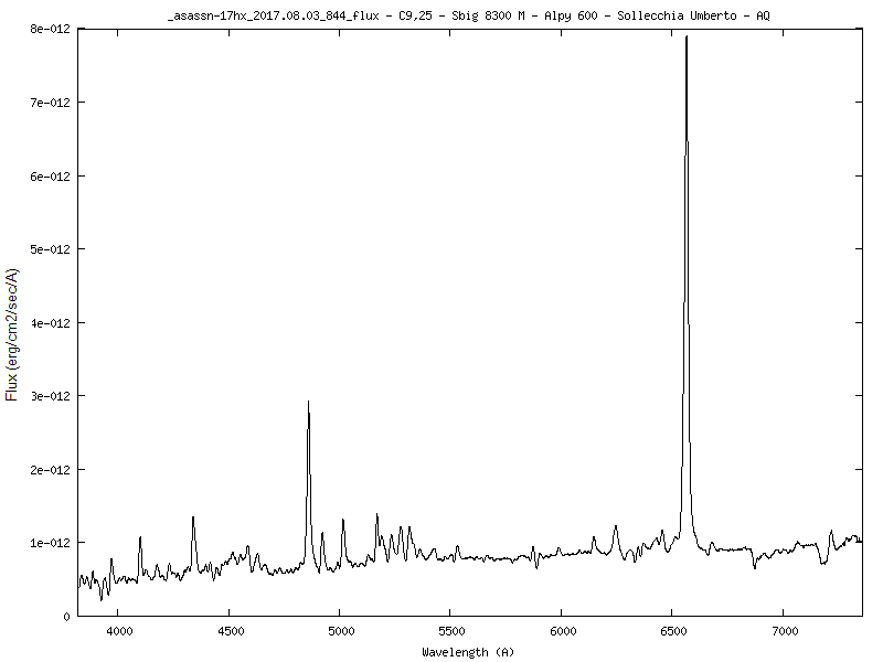

Bonjour à tous, placez le profil de nova observé dans la nuit du 03/08/2017.Peut-être la nova, a décidé d'aller à la retraite.

Posted: Tue Aug 08, 2017 10:17 am
Nice Spectrum, Umberto. Decline toward nebular phase.
James: correct, unless He I. The lines are Fe II, multiplet 42
He I will appear latter when the recessing photosphere will be hotter and so hot enough to ionize He

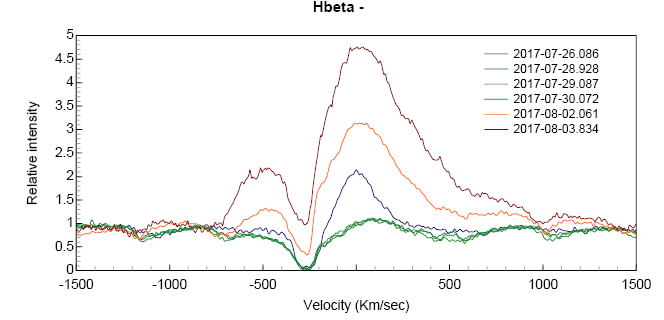

Wow ! Even allowing for the change in continuum flux between the two dates (~1 mag at R, AAVSO data) that is a big change
Posted: Thu Aug 10, 2017 4:10 pm
Excellent monitoring
Congratulations to all the observers
The maximum (~30-07-2017) Echelle spectra obtained by Tim, Joan & Olivier: almost no changes during two days, from 28 th to 30th

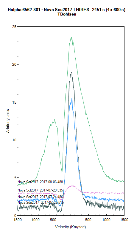

My effort with this nova. Big changes over 2 weeks.
