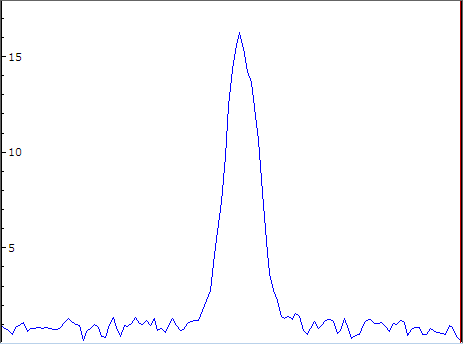

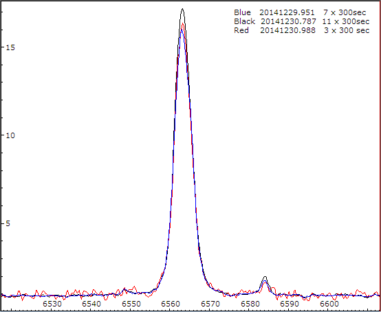

Hi Paolo,
No sign of asymmetry in my R~5500 spectra from 29, 30th
http://www.spectro-aras.com/forum/downl ... hp?id=1980
but there is a hint of it perhaps in Christian's VHIRES spectrum from 21st ?

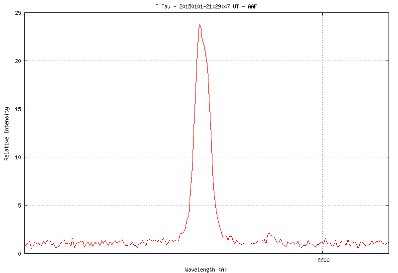

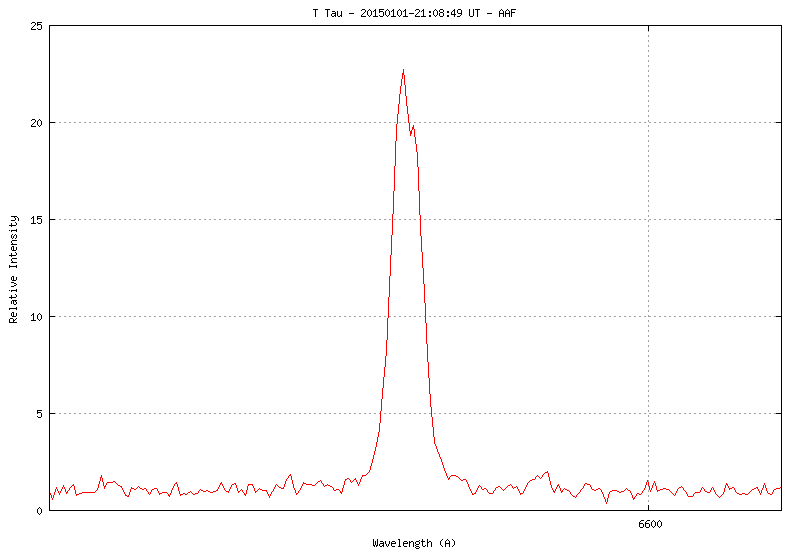

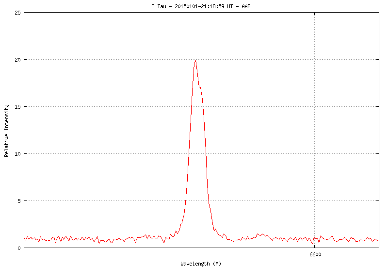

Hi to everybody.
As per Paolo message here below our spectra taken few days ago.
Hoping they can be useful.
Bye
Max & Nico
T Tau 3 - 20150101-212947-3.png (5.33 KiB) Viewed 16576 times
T Tau 2 - 20150101-211859-2.png (5.04 KiB) Viewed 16576 times
T Tau 1 - 20150101-210849-1.png (5.27 KiB) Viewed 16576 times

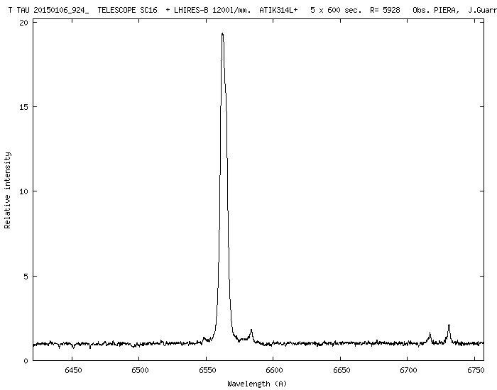

To all:
This is the first time I observe the T Tauri, who I should send the FITS?
Thanks J.Guarro
_ttau_20150106_924_J. Guarro.png (5.46 KiB) Viewed 16525 times
