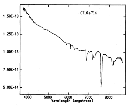

I found this spectrum in a publication (but forgot to note the reference, I'll have to serach again ...)
David, I think you have to check your flux calibration.

I've just used Robin's Spitzer website to check the flux calibration. Given a Johnson V magnitude of 12.54 which I measured at the same time, the website gives a corresponding flux density of 3.6e-14 erg/cm2/s/A which agrees with my calibration in the V-band.
There are no units mentioned on the spectrum you found. Assuming it is also erg/cm2/s/A, this would correspond to a V mag of ~11.2 which is brighter than it has been seen in the last 10 years. So I don't know what to make of that plot. It would be interesting to read the paper.

I think you're right David
The problem is in the flux calibration of the published spectrum
I have to find again the Publication
