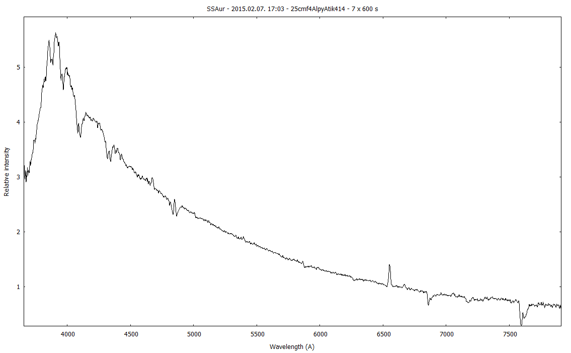

It was an edge case to guide on slit (1.5 sec) from which I'd estimate between 11.5 - 12 mag:

The star SS Aur evolved ....

Very nice spectra Peter & Joan,
More spectra should be interesting to follow the evolution
Published series of CV outburts are very scarce

It was a very hard capture this time, for various reasons:
The object was very low in the end, had breaks for technical difficulties (usb moved, focus shift) and this is a sum of all the 3 parts.

This is a fantastic spectrum Peter !
Difficult and very interesting.
The emission spectrum of the cv near quiescence, with the lines of He I + Fe II well developped.
Congratulations ?
Do you want to prepare a graph for the next letter with the 4 spectra of the data base ? (700 x 1000 pixels) - Should be a must.

Thank you Joan and Francois, I will prepare a series graph then.
So far we have only 3, big question if someone could do a 4th some more days later (I'm a weekend observer).

Saturday and Sunday (probably the last from me), further blue continuum drop:
Notice on technical difficulties, not to do same mistake by others:
- Saturday's run just took 2 hours, in perfect conditions
- Sunday I was careless, first 1-2 hours while Newton + environment cooling down had terrible seeing (= usual local effect here), and then I didn't adjust the star on the slit (when star become smaller, its middle got defined - became visible that not perfectly on the slit...and some rotation) Result: thrown out / underweigthed hours of exposures in the last sum. Only 7 x 20 minute was optimal.
