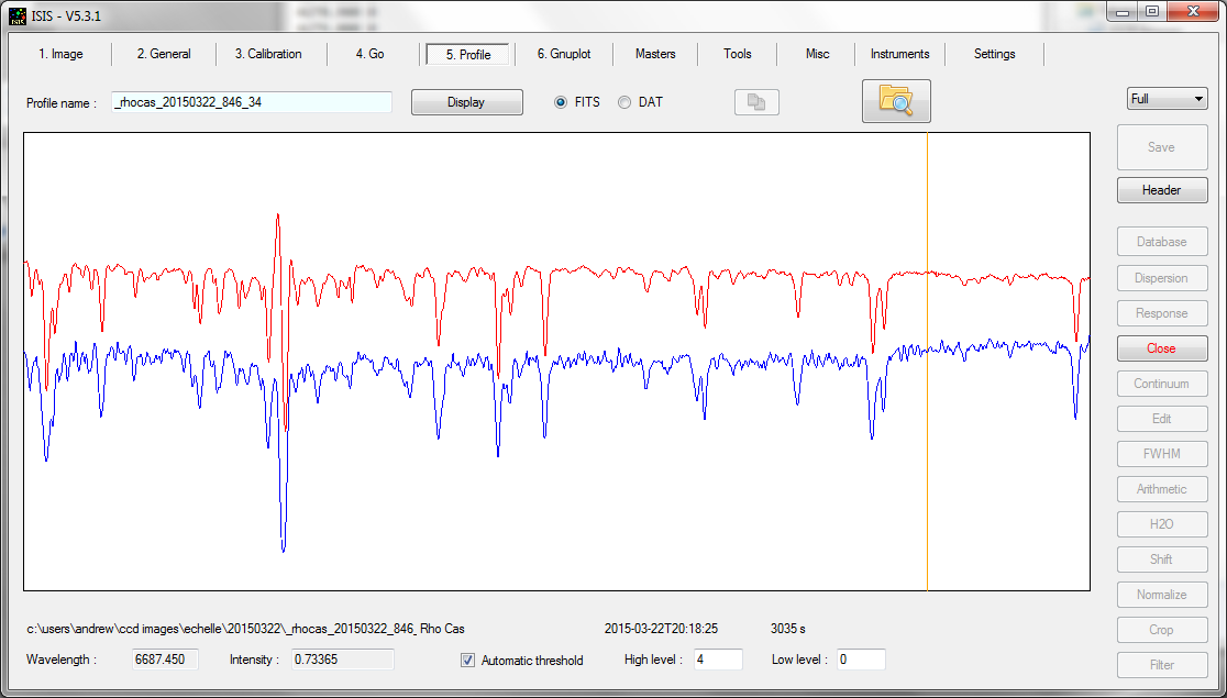

Rho Cas in 2015 and 2010
Rho Cas.png (70.47 KiB) Viewed 10862 times
Robin - The attached shows one of my Rho Cas observations around Ha compared to one made bt Christian Buil in Sept 2010. I think the "Mirror Method could work well for complex lines like these allowing the red and blue shifted peaks to be both measured.
Regards Andrew
In my defense my observation had one half the exposure!
