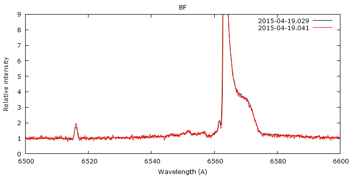

Update with the 2400/mm + LHires (R~17000):
Re: BF Cyg
Posted: Sun Apr 19, 2015 4:45 pm
The calibration looks very good
Red : eshel spectrum obtained a few minutes before
One can see the better resolution of Lhires III 2400 l/mm in comparison to eshel
Congratulations,

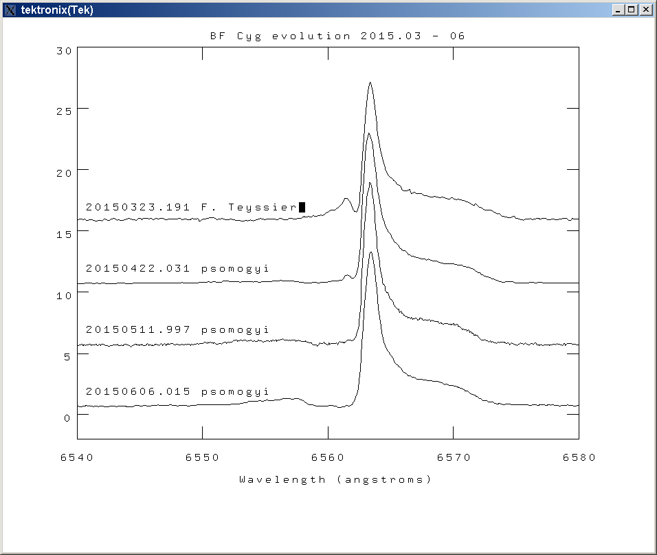

Posted: Sun Jun 07, 2015 9:52 am
by Peter Somogyi
BF Cyg before yesterday (35um slit - this time managed to get only R~10000, 1.9 hours), arranged to bottom in a monthly view:
Took several other spectra too, but need to redo the dark (switching to -12C).
