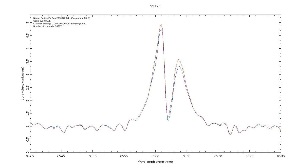

as VV Cep is a long term variable (20+ years), my intent was to get a spectrum every two weeks or so. But by comparing my last spectra, I realized that the Halpha emission was varying compared to the continuum:
VVCep comparison: 20150726 (Blue), 20150731 (Green) & 20150804 (Red)
Are those short term variations real (they seem on the spectra)?
Do they come from the Be star companion itself?
Re: VV Cep variability & frequency of observation
Posted: Wed Aug 26, 2015 7:59 am
by Olivier Thizy
here is an interesting reply from Phil Bennett:
The variations are real, and come from the accretion region around the hot star. (The hot star itself is probably not variable).
The flux changes presumably are a result of changes in accretion onto the hot star. It would be interesting to see how quickly these changes occur, and also to see whether or not there is any periodicity.
In any case, I wouldn't be surprised to see changes from night to night, or even over a few hours.
The UV continuum at wavelengths shorter than 3700 A also shows a similar variability because it is coming from the same accretion source.
Phil Bennett
It seems it would be interesting to do a continuous observation of that star and see if we can spot any short timescale changes!
Posted: Thu Aug 27, 2015 7:50 am
by Ernst Pollmann
Hi Olivier,
such intensity variations (sometimes by factor two or more) are to expect (see the attached Fig.). This corresponds to intrinsic light variation of the M star observed at 5080 Angstr. (Saito et al. 1980).
The study of the paper "A Spectroscopic Study of VV Cep during the 1976-78 Eclipse, Observation of the Halpha Line" by Kawabata & Saito 1981
(see my website http://astrospectroscopy.de/literatur.html ) provides a lot of interesting facts in this direction.
Ernst

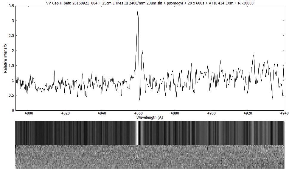

As a sleeper project, I've left my scope on VV Cep searching for short-term variability.
No real change, just publishing for confirming it and reporting the actual state.
H-beta series (20 x 600 sec):
I don't think this noise was coming from camera (even 1 x 600s was quite noiseless), it might be some kind of scattering in the blue I always see.

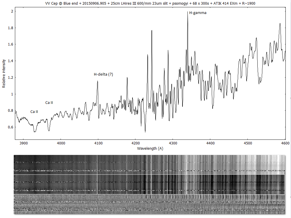

Blue-end experiment:
I was able to focus only the middle 1/3rd part.
The 3 time-diagrams show following manipulation steps in 2D:
- original (min/max cut, linear, contains the wavelength registration shift at leftmost side)
- 2D polynom removal for the 2nd image (imsurfit 3, 5)
- column mean removal
Time is increasing from botton to top in all the above diagrams.
I think the faint changes near H-delta might be real (unsure if that big emission was really H-delta at this resolution), other variations on the right side must be just artifacts of wavelength fitting problems.
I couldn't move to UV with this 600/mm grating mostly because of scattering light on the flat problems (not just becase focusable area is only 1/3rd).
My experiment with the Orion G3 camera taking out the glass produced at least better UV flat without light scattering - but then couldn't cool it (dew problems, tried) which means can't use for such a low light.

EDIT: the 2 horizontal noise rows in the blue-end 2D series are of course: clouds.

it's not easy to interpret the different variability you measured in your different wavelength areas. But concerning short-term variations, you should think about the constantly mass transfer from the super giant into the accretion disk of the B star (inspite of the large orbital eccentricity of 0.37)
The strong scattering of the Halpha-EW outside the eclipse (see: "Halpha observation" this sub forum) seems to be an indicator for corresponding intensity variations you could expect any time within the entire spectrum.
Ernst
Posted: Tue Sep 29, 2015 3:27 pm
by Peter Somogyi
Hi Ernst,
Thank you for the look, yes the EW(H-alpha) looks varying here a bit.
And on the H-beta and blue-end, mostly just Balmer lines showing anything.
