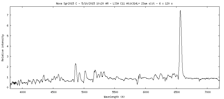

This is my attempt from last night. Much easier with a LISA. :D
There are lots of strong absorption features still.
Terry
Re: PNV J18033275-2816054
Posted: Wed Sep 30, 2015 4:46 pm
Congratulations for the spectra.
Still in the fire ball stage, thick wind
Terry, what is the altitude of the nova for you ?
A new page is ready in the data base for your spectra
Please use Nova Sgr 2015 C as object name
Posted: Thu Oct 01, 2015 12:06 pm
by Terry Bohlsen
Francois Teyssier wrote:Congratulations for the spectra.
Francois
The nova was at about airmass 1.5
It will be able to follow it of about a month before it gets too low.
Im away from home til Monday and will be able to send you the data then.
Should we use the new name V5669 Sgr that has just been announced?
Terry

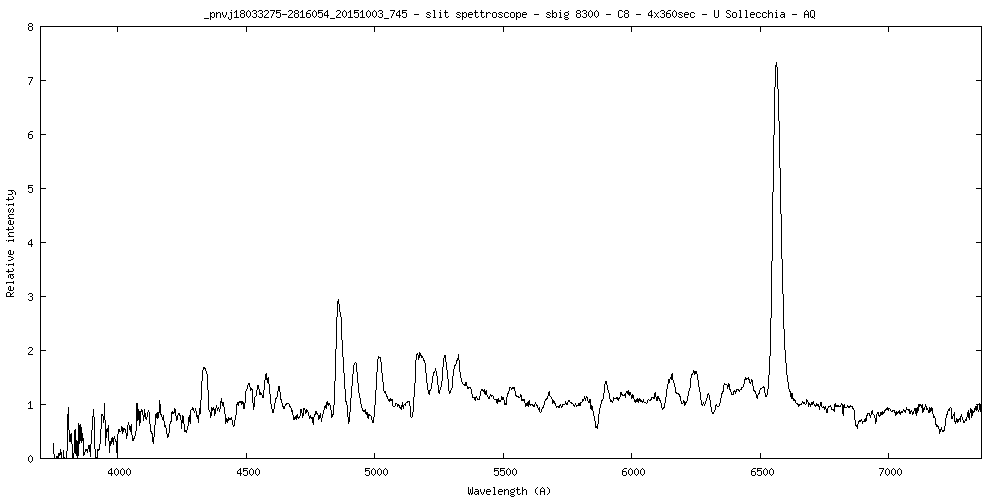

Posted: Sun Oct 04, 2015 8:44 pm
by umberto sollecchia
Salut, La nuit dernière, le temps a permis l'observation de cette target.
Placez le profil spectral.
Profilo_PNVJ 18033275-2816054.png (7.36 KiB) Viewed 22090 times
Cordialemente Umberto
Posted: Tue Oct 06, 2015 9:53 am
by Terry Bohlsen
Big change in 5 days. Spectra from 5/10 with my LISA.

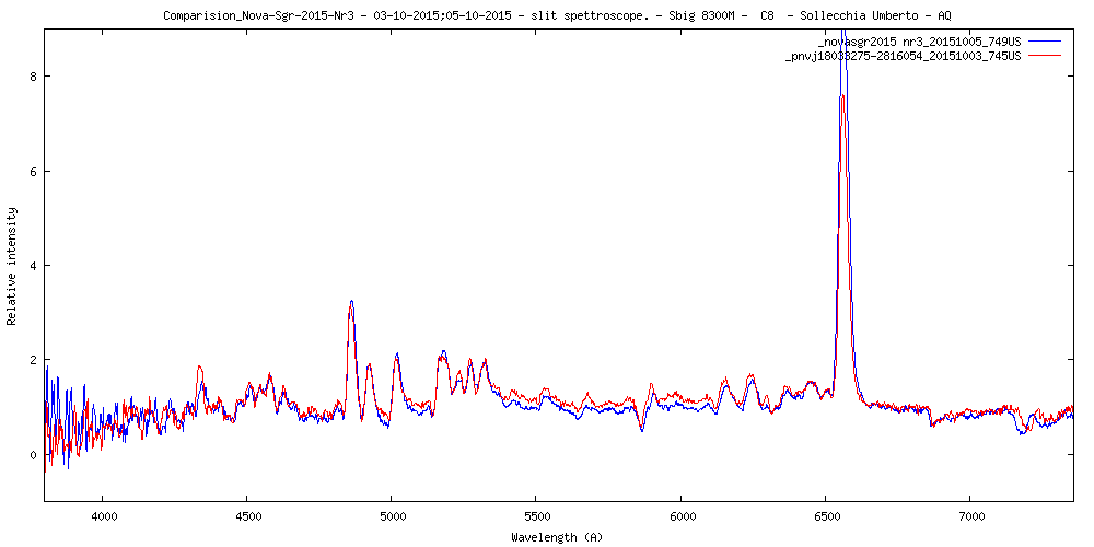

Posted: Tue Oct 06, 2015 10:34 am
Bonjour à tous, voici un nouveau profil et un comparateur où vous pouvez voir les rapides variations spectrales
Profilo Nova Sgr 2015 nr3.png (7.1 KiB) Viewed 21972 times
Cordialement Umberto

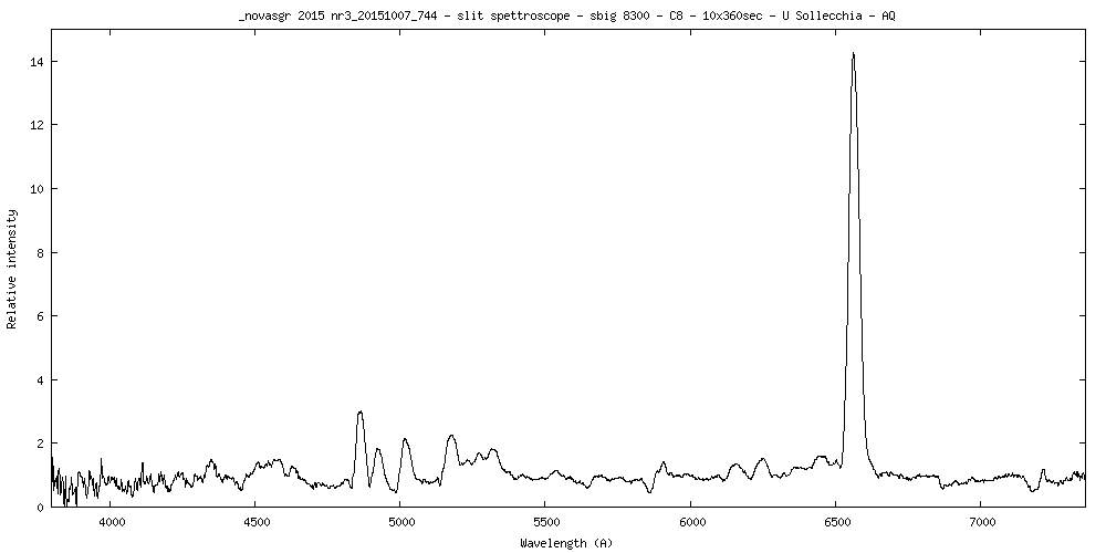

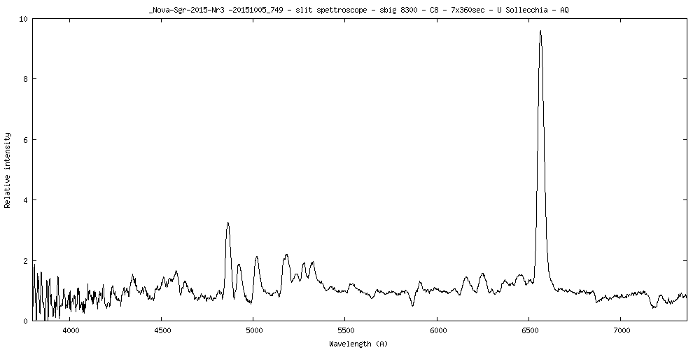

Posted: Wed Oct 07, 2015 11:06 pm
Salut, placer un nouveau profil de la nouvelle observée dans la soirée du 10.07.2015.
Profilo nova sgr 2015 nr3.png (6.58 KiB) Viewed 21930 times

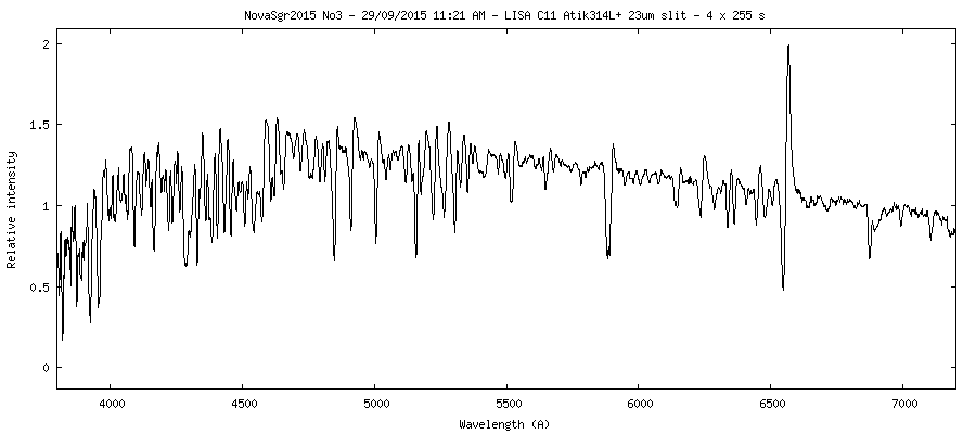

Posted: Wed Oct 21, 2015 5:51 pm
by Vikrant Agnihotri
Hello to all
The spectra of Nova Sgr2015 No3 are attached
Vikrant, India
